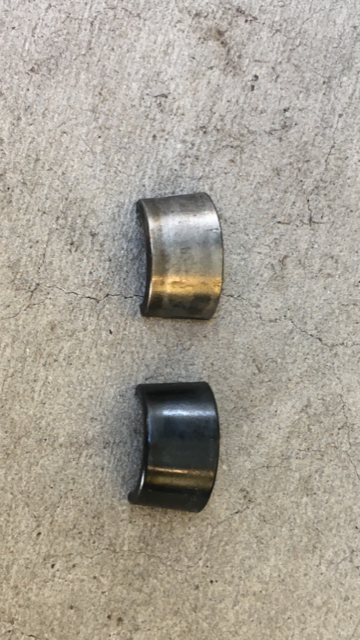

Can someone please tell me which one of these keepers is the heat treated one? Thanks

Impossible to tell from a photo. One appears to be used, the other not. Would have to do a hardness test to determine heat treatment.
What makes you believe one is NOT heat treated??

On the edge where the radius is, hit them with a fine file. You can tell right away if one is harder than the other. You are not trying to remove a big chunk of metal, just gauging the hardness.

These were both removed from the same engine and I believe the parts catalog indicated that the intake keepers were supposed to be hardened and the exhausts not. My problem is when I disassembled I did not pay attention to which were which.
After further inspection, I dont think the black ones even fit properly. I think someone was in this engine not too long before I bought it and changed the exhaust valve keepers but used mis-matched keepers.
The engine had a rod knock when I bought it. I think the previous owner had gone in looking to fiddle with valve train to solve the knock and changed the keepers.

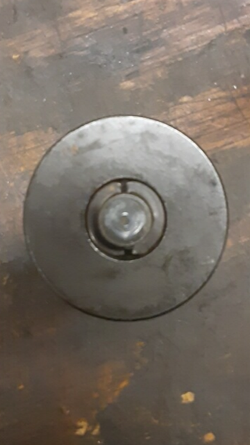

Look at these two pics. One shows the black keepers and how they have no gap (wrong) between the keepers when seated inside of the retainer. This retainer wobbles slightly.
The silver colored ones have the gap (correct) and the retainer is snug with no movement.
Would you concur that no gap is incorrect?

Never heard on intake and exhaust keepers on engines with the same size valve stems. Back in the 70s SBC had some 3/8" exhaust valve stem heads. The guy before you probably lost a few. As with the others new retainers and keepers are cheap piece of mind.

BTW, I've learned that Mazda made the exhaust valve keepers without gaps. The purpose was to create slight clearance between the valve stem and inner part of the keepers. It was done on exhaust valves only and is designed to allow them to rotate.
Some high performance Mazda engine builders don't like this because they say the potential for wear in this design can drop valves at high rpm. Those guys will typically install intake keepers on both the exhaust and intake.
So thats why those two keepers I posted picture of are different. The black one is an exhaust keeper and the silver one an intake.

Scary, scary, scary! I thought those spring retainers looked strange! It seems to me the only time they might rotate is when you "float" a valve. Otherwise, the spring tension would always cause the keeper to be tight against the top of the groove in the valve stem.

Yeah, I dont like it either. I ordered a set of intake keepers and I'll be putting them on the exhaust side too and omitting the rotation.
