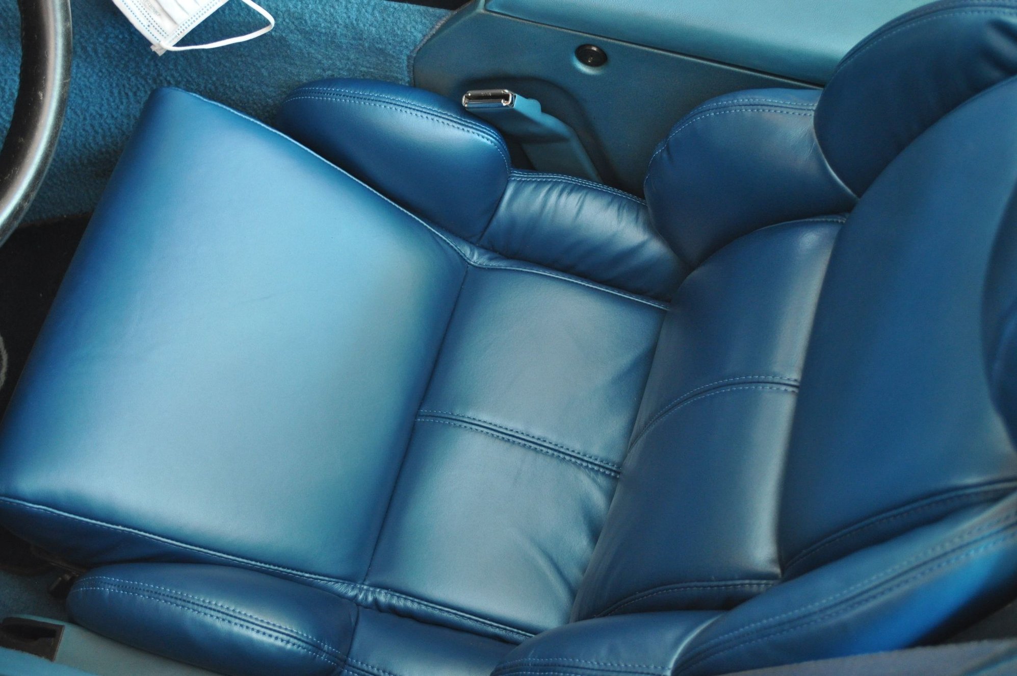

I ordered new mounted seat covers for our 1989. Now to get them installed. Any suggestions on the install?
Thanks, Went

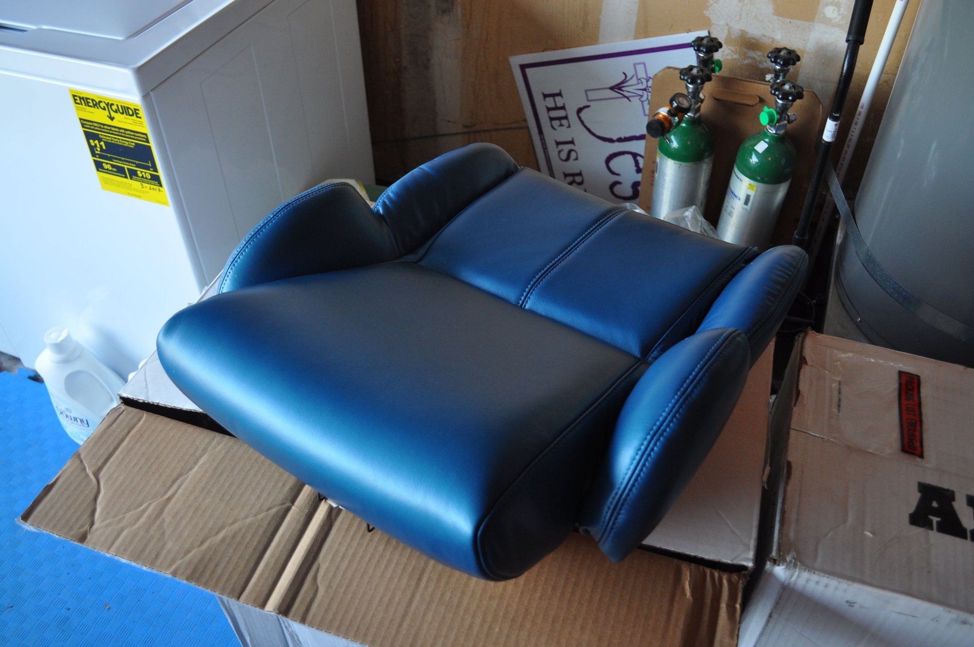

Well, I gave it a whirl. The bottoms clipped in easy enough. The backrests however, were more than my wrists could put up with. I'll take it to a local upholstery shop Wednesday to have them snap the backs into place. Besides...it's 91 degrees right now and will get warmer yet today. One thing I've noticed. The new seats make the rest of the car interior seem old. The old seats made the interior look pretty good.

Bend the back clips out a bit. They are really tough to get in otherwise.

Then hook the inside in, and pushed to get the outer hooks to lock into place.
What do you think a upholstery shop is going to do, open the clips and charge you.

Hi, I tried bending the clips out some. I've had three surgeries on my right hand and two on the left. Just can't get the clips to latch before there is no more grip or push in the hands left. Going to have to be an upholstery shop. Thanks for the suggestion though. Appreciate it!

I had an issue with trying to get my seats installed as well. I finally decided to trim away some of the foam around the wire where the clips fit. You can't hurt anything and it can't be seen.

I used electrical tie-wraps to get the seat covers into position where I could put the hog-rings around the wires and squeeze them together. I read that you shouldn't simply use the tie-wraps alone, but using them to locate things together makes the actual job much easier. You can push with one hand while you pull it tight with the other hand. You can clip them off if you want afterwards, but I just left mine in place.

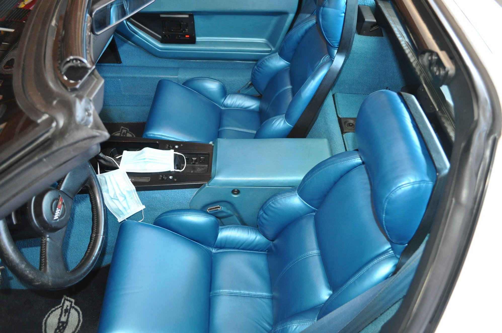

The seats are finally in. Feel great with new foam.
Went
The new foam REALLY makes a difference.
Looks great!
