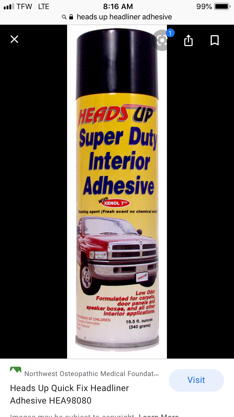

I’ve used this with good luck in the past.
