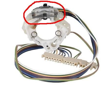

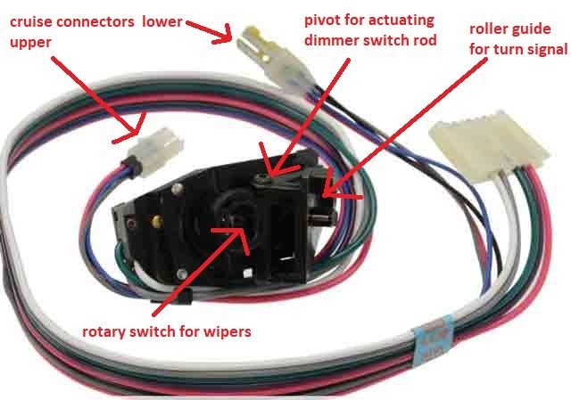

Sounds like your looking for the wiper switch, part #26015119.
The stalk goes into the wiper switch. The switch pivots to move a roller which is attached to the turn signal switch.
Not trying to be a jerk, just trying to help you ask for the correct part.
I've changed both. The wiper switch supply seems to have dried up. Best bet is one of the corvette dismantlers.
Another option is search ebay for 91-93 vette parts and message someone parting a car out for one.
I think I was actually lucky that mine broke about 2 or 3 years ago. I was able to buy a new GM part for under $100. Now a used one can go for $250.
Wiper switch
turn signal switch

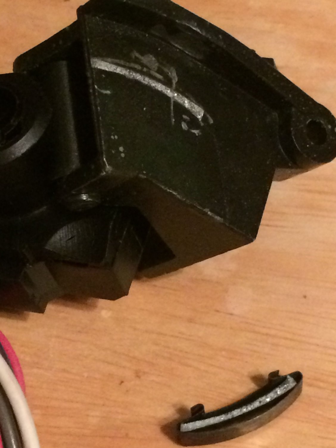

In case your interested on what failed.
