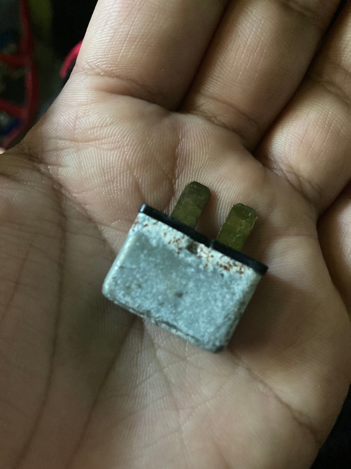

Hey guys I need to replace all the circuit breakers(I think that’s what they’re called) on the fuse panel by the passenger door of the first pic and I couldn’t find them anywhere. I need the full set and don’t know what amps they are and where which one goes since most of mine are just old and done for. (The ones on the panel are temporary and I’ll switch them out as soon as I get the right ones) Thanks

They are 30 amp circuit breakers.
Why do you think you have to replace all of them? Did you even test them?

One correction to my response is that the defogger breaker is actually 35 amp
