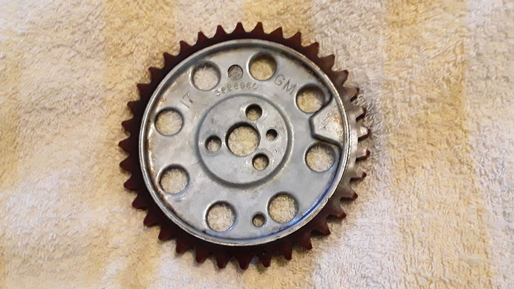

I did not feel good with this thing in my engine. After I discovered it I put a Melling dual roller in and it does not make any noise anyway.
Who did the placebo test and found this quieter and by how much I wonder. This was around 140,000 so it was lasting.

Are those gears a type of plastic? Is that what comes standard on early C4s?

It is some kind of nylon, it has many cracks and I would say only good for 150000 max.

I do not believe that early C4's have a cam timing gear. There are people on here saying that early C4's have the nylon cam year. I'd like to see a picture of an actual cam gear from an 85.
I have copies of the 1953-1982 and 1984-1996 Corvette parts and illustration catalog.
These catalogs list part #340235 for 1967-82, and 1984-86 Corvettes with 305, 327, or 350 CID engines.
I changed the timing chain on my 1995 K1500 Chevrolet Pickup 350 w/ 117K miles due to 15 degrees of slack. The cam gear installed in my truck was all metal and had "340235" stamped on it (same part # as 67-86 Vettes). So based up on this, 1967-1986 small blocks had a steel timing gear.
The part # changes to 10088127 for 1987-1991 Vettes, which is also a steel gear. (1987 is when they switched to a roller cam)
The parts book list part # 330814 and 330815 for 396, 427, and 454 engines. These cam gears had Nylon. Strange that the big blocks had the nylon.
With that said, my 1995 K1500 Pickup timing chain had experienced a lot of stretch with 15 degrees of slack with only 117K miles, so I would change any small block timing chain near 100K miles.
