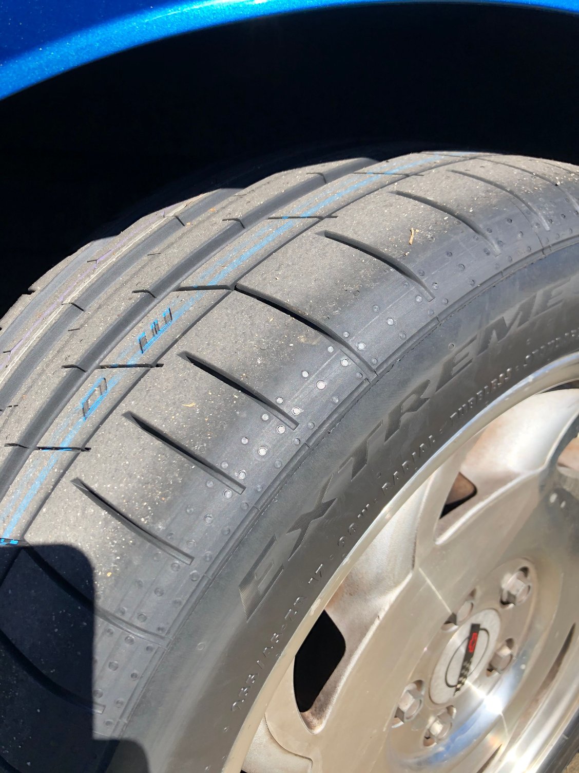

Replaced the cracked Michelin tires that were on the Corvette when I bought it. I bought Continental Extreme Contact Sport, in the OEM sizes.
Ran into something I hadn’t noticed before...the previous owner had Michelins all around, but the fronts were undersized...235/40/17. OEM size is 255/45/17.
Other than having lowered the front of the car by 3/4 of an inch, and by virtue of the 40 series tire, having a shorter, stiffer sidewall, I can’t help but think losing 3/4 of an inch width from EACH tire more than offset any potential gain from the shorter stiffer sidewall.
It will be a couple of weeks before I get to wring it out on The Dragon, about an hour from my home, but can anyone give me an idea of any differences I should notice in general?
One positive in going back to the taller OEM size, my front air dam doesn’t scrape going in my driveway any more.

We had a day near 70 on Saturday, and since The Dragon is only an hour away, I just couldn’t resist.
I’ve only had the Continentals a few days, but my overall impression is very positive. On the highway, they appear to give a smoother, quieter ride than the Michelins did. The tendency to follow grooves in the pavement appears to be very reduced from what I’d grown accustomed to.
On The Dragon, it felt like a different car. Turn in is sharp and predictable, and imperfections in the road don’t seem to make the rear as unsettled in hard cornering. The tire store did a 4-wheel alignment, which possibly may be a part of taming the rear’s tendency to be a bit darty. Handling is very close to neutral, and the tires are surprisingly quiet, even in tight cornering. It was fairly easy to steer gently with the throttle on exiting turns, the transitions between hard cornering, and breaking rear traction with power were very predictable, and gradual.
My style of driving on curvy roads like The Dragon usually trends toward trail braking on very sharp curves, and the overall performance of the car with the new tires seems perfectly suited to my preferences, and the tires were predictable enough that it took very little time to get comfortable with what the car was doing.
I wasn’t setting any speed records, (my 77-year old mother was my passenger), but we moved along at a very brisk pace, and she told me afterward that at no time did she feel uncomfortable with what I was doing..
The only complaint I’ve got thus far is that I didn’t do this sooner.
