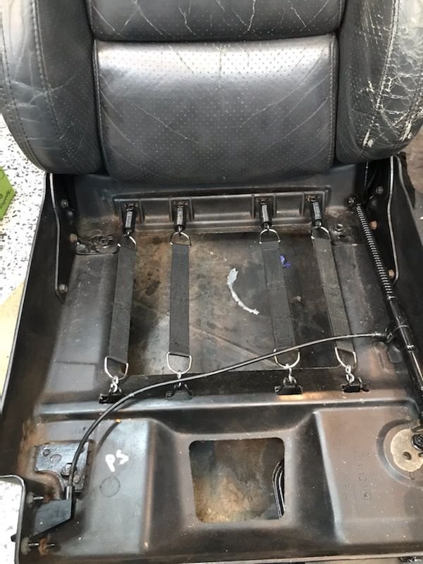

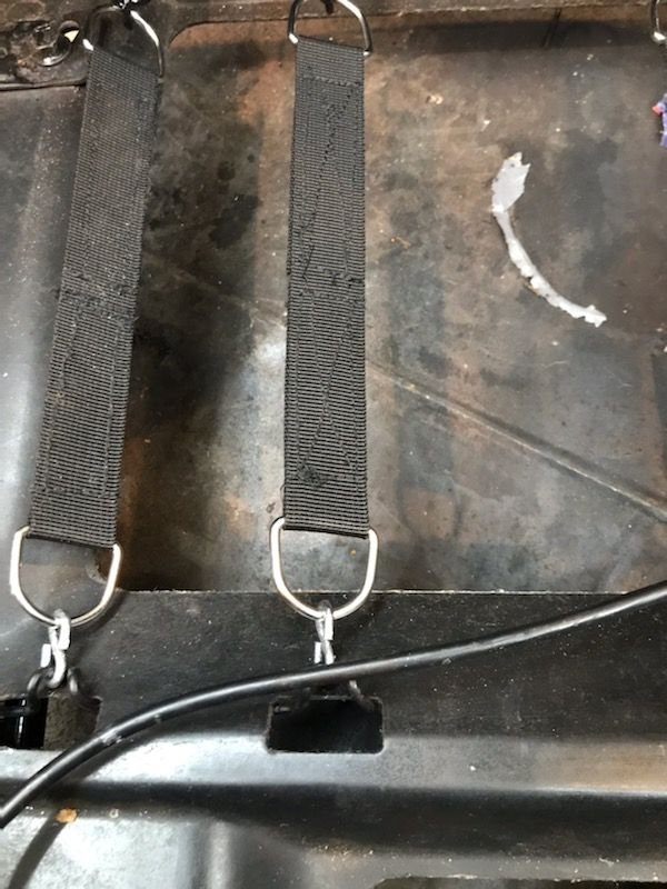

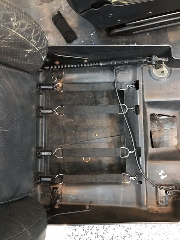

Figured I'd post this just in case anybody else ran into what I have with 84 seats with the rotted out Springs.
I made my own for about $35 instead of spending 80 on the replacement straps
