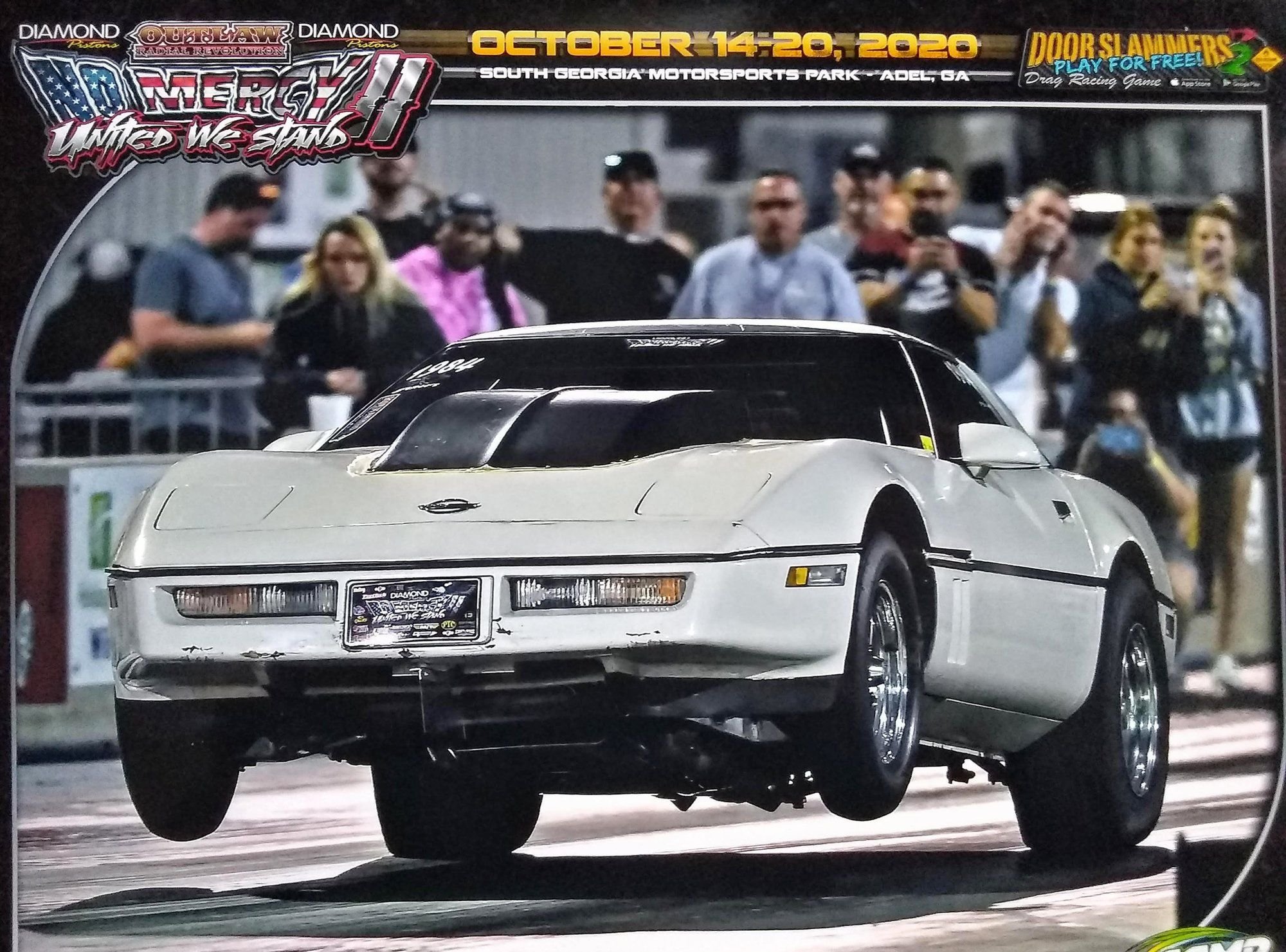

BTW I know your comment about the powerglide was tongue in cheek, but FWIW probably the quickest and fastest (drag racing) C4's on this site run powerglides. Below is a picture of one that belongs to a friend. Not sure if he would want me to post exact numbers, but I can tell you this. He built it for 1/8 mile tracks. Did run it once through the qtr. and its well into the 8's at way over 160 mph.

That’s a nice car.

Originally Posted by ZHammer
That’s a nice car.
It is that..... Somewhere, I have a picture of it standing on the back bumper, all 4 wheels off the ground... If I can find it, I will post.
