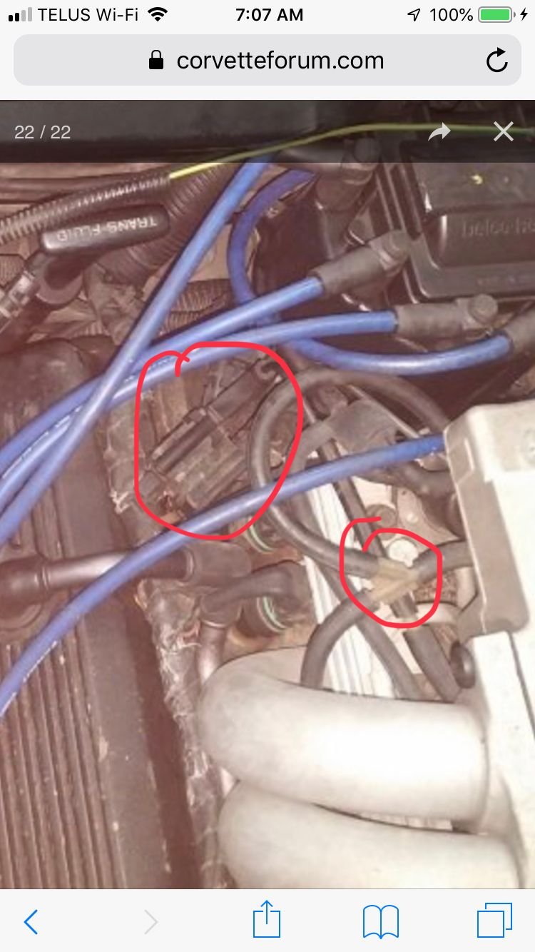

IHBD, if you are right about 85’s potentially having the 86 locations of the boost/main fan sensors, it would most likely be an 86 harness, and iirc (been a while since having my 85) the 85’s egr solenoid location was above c8, beside distributor. i *think* i see that here?? not totally clear in the pic.
the second red circle shows a T (Y?) and i wasnt sure thats supposed to be there so i circled it.

pic of potential solenoid?
Yes, I have to figure out those too. That what looks like vacuum solenoid thing is gust hanging there on the tubes. I need to find where is is supposed to be bolted to. I don't remember if I mentioned it before, but car has a cold start problem. It won't start without starting fluid.

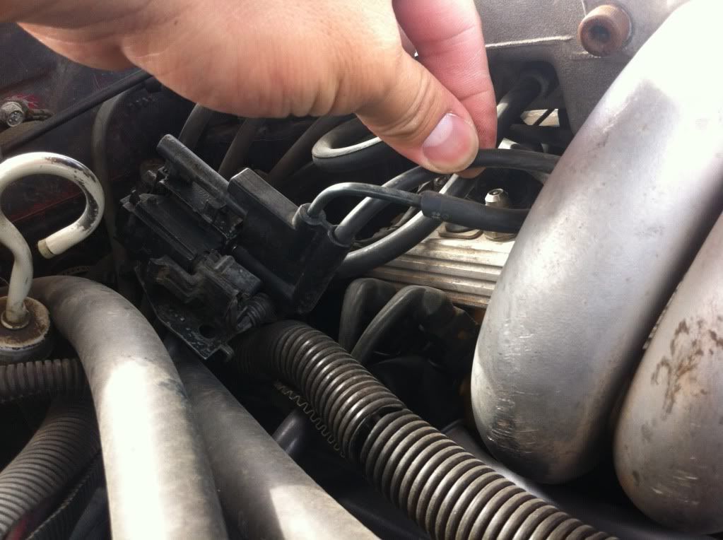

Maybe we can get a pic from @Bfenty of exactly what the egr solenoid system on the 85 is supposed to look like. I know his is readily available for photos as opposed to yours Dave sleeping in storage.

Jumping into this thread to say that I have done a lot of the same work you’re doing now, and I have a (mostly) factory correct ‘85 car that I’d be happy to share pics from if you need them. I can probably get you some from that vac line later today if need be.

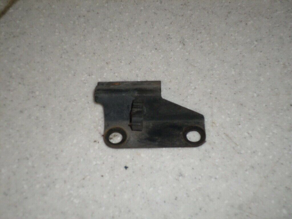

Can anybody tell me where this thing gets bolted too?

The EGR Solenoid attaches to a bracket that gets screwed in below it. Google "85 corvette egr solenoid bracket." You can see the screw in this pic I just took.

Thank you, I'm assuming that bracket is attached with 2 intake manifold bolts. It is missing on my car. Found one on e-bay, but for Camaro. Looks the same though. Probably will fabricate one.

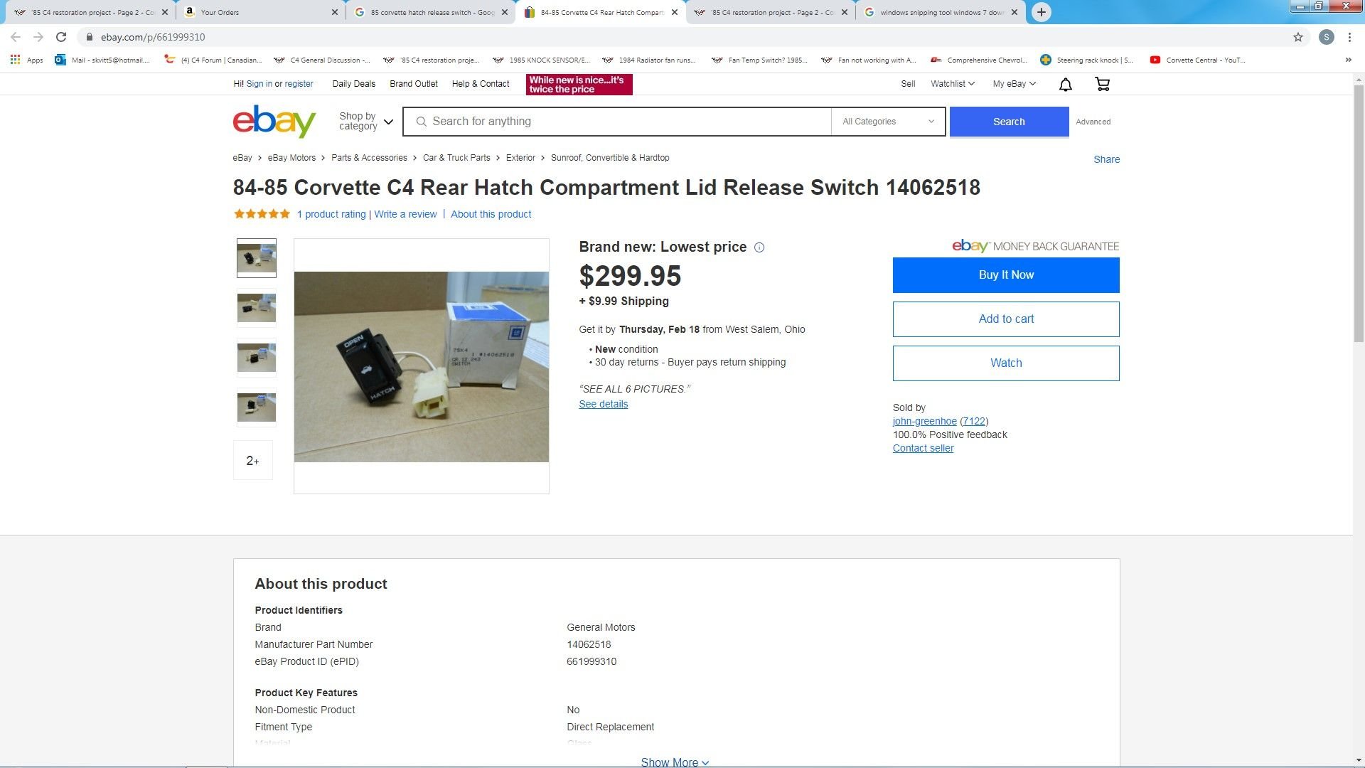

Really???????????

Never heard of the CORVETTE tax ?

skvitt, dont buy that. lots if cheaper places. there is a place called northern corvette in ontario...call them.

I'm not that crazy! For that price I will just have 2 wires sticking out of the hole Or rig up button from princess auto or something like that. But what's funny - this switch is not available from anybody else. I checked northern corvette, corvette depot and corvette central. All have console button, but not this. mine is functional, but plastic frame is broken.
