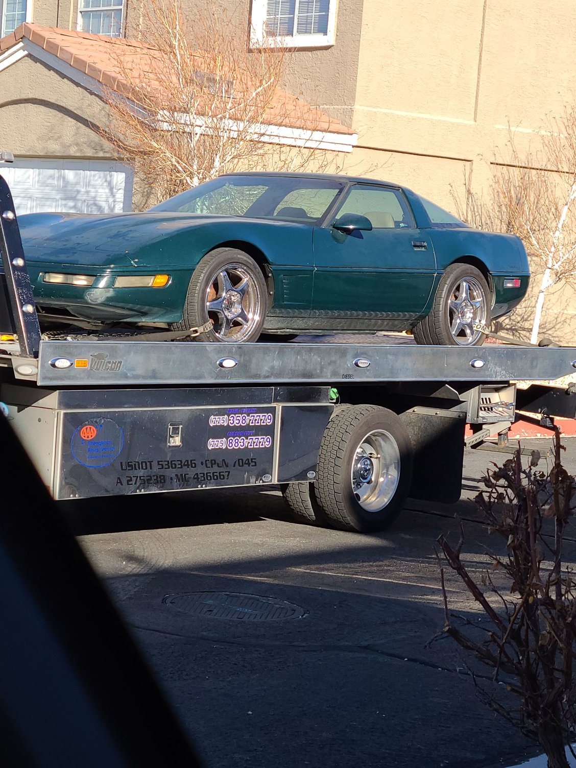

on its way for diagnostic
its dusty from sitting in the garage. its cleans up nicely

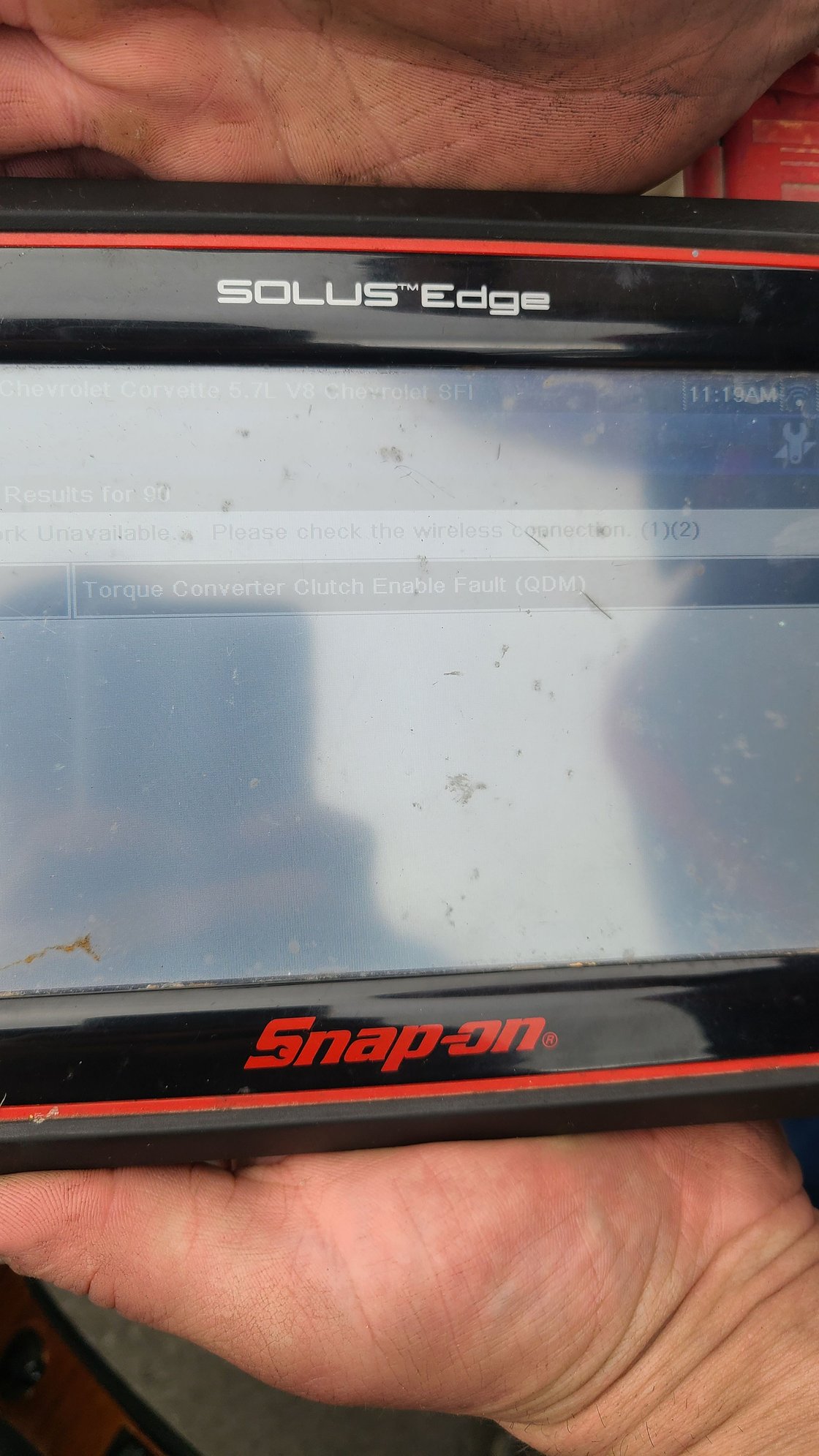

Hello gentlemen so today I got my car diagnostic and the torque converter clutch went faulty. i also found out that my 1995 automatic uses an OBD2 scanner rather than an OBD1 scanner ? After I get the car in my garage I tried to turn it on and it won't start. The starter is turning but,I hear a loud grinding sound. Will my torque converter Clutch going bad, prevent my car from turning Over? and which other components will I need to replace, along with the torque converter clutch ? I have an appointment with a transmission specialist. I Dont want to go in green behind the ears thanks ! i hope to be on the road soon. I'm glad it's not my engine, Hope this helps someone with A loud metallic knocking sound. I know that sound could mean many things. good luck
Could this cause my transmission to seize? My car won't turn over starter seems to be fine

THANK U. OK gentlemen today i got the diagnostic done on my 95 automatic. it was scanned with an OBD2? i thought 95' needed OBD1. ANYHOW a faulty torque converter clutch code came up. I am wondering what other parts and components I will need to replace along with this piece. and also can this problem cause my Transmission to seize. The car won't turn over but the starter seems to be fine
could this have been the metallic knocking I was hearing. I have an appointment with a transmission specialist.i don't want to go in green behind the ears.what other parts and components can I expect along with this repair

Your 1995 does not use an OBD2 scanner. The physical plug is the same shape as an OBD2 connector, but the pinout is different, and the computers in your car are all 8192 ALDL protocol (not J1850 OBD2 as on a 1996 Corvette). So either your car is not a 1995, or that Snap-on scanner supports 8192 ALDL protocol. I'm not there so I don't know which it is.
Either way, as I already answered in your other thread, it is probably caused by the TCC solenoid reaming out its bore and losing hydraulic pressure, a common issue on the 1995-1996 4L60E. If this happens the TCC will never engage. While bad for fuel economy on cruises, this won't cause any damage to your engine or transmission. Your issue with not being able to start the car is something else. I'd check the basics first, including making sure it's not a VATS issue.

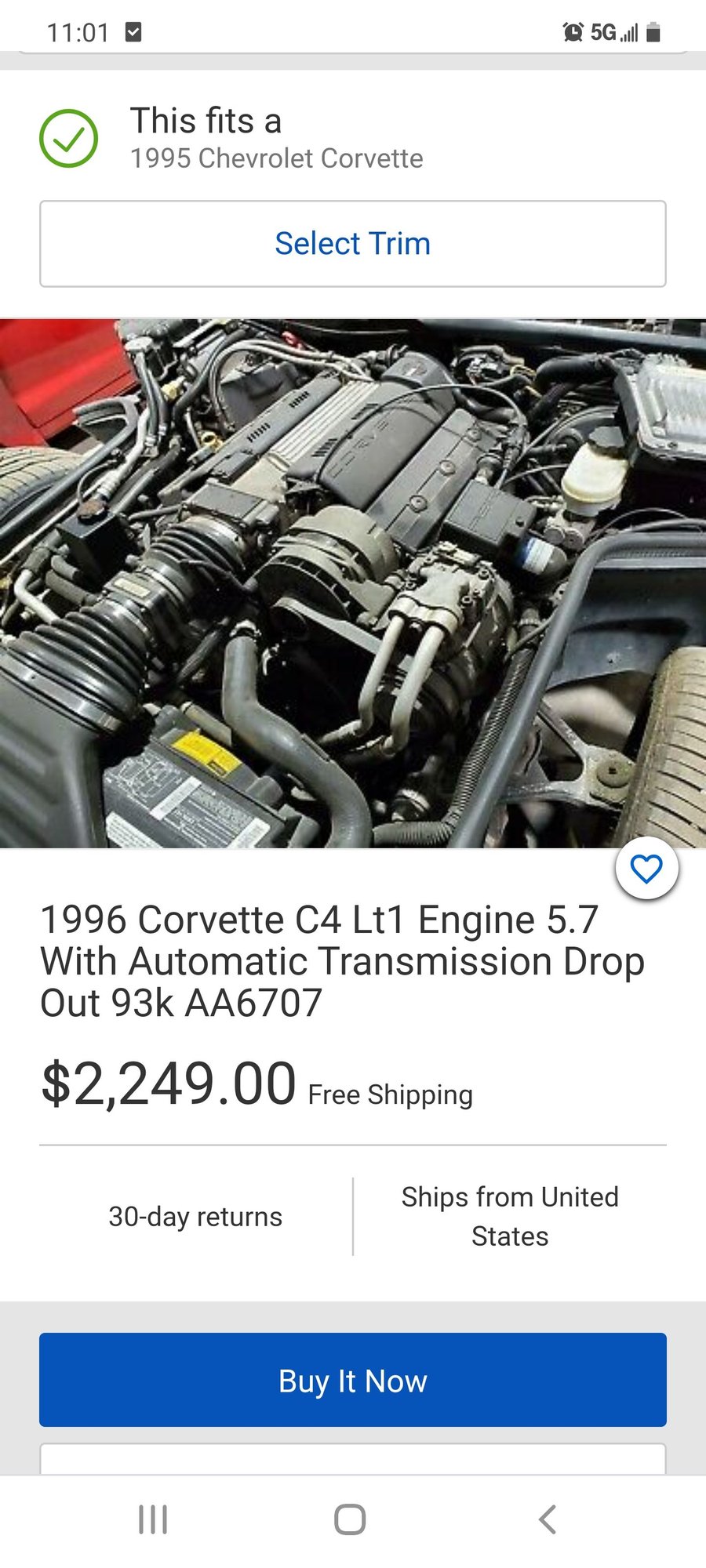

Iv found a used 1 on ebay..I think I'm gonna go this route. it comes complete and with the transmission. Any opinions on dropping something used into it? thanks for your input. it really helps!
will I be able to salvage all of the NEW AC parts and components that I JUST installed on the engine that took a dump?
How do you know it's any better than the one you just blew a new observation window through? Generally speaking, if you're going to buy a used engine and trans from some rando on eBay, you're going to want to commit to having it on an engine stand and refreshing it yourself rather than trusting it's actually good. Additionally, this is for a '96. Is your car a '96 or a '95? There were some sensor-related changes to the engine on the '96. It's not that you can't use it, it's just that you have to account for those changes when you go to put it in. But if your "95" is actually a 96, then it'll be fine.
Of course you can, since you're yanking the engine out anyway. All the accessories have to be disconnected to remove the engine. They're not a part of the engine itself.

If you cant see/hear it run. I would rather buy a new/rebuilt/used from someone local you can physically take it to and have some sort of recourse if there's a problem. Giving them a bad review or rating more than likely wont get your issue resolved or $$$ back.

I second that, don't buy something that you can't hear running !!
