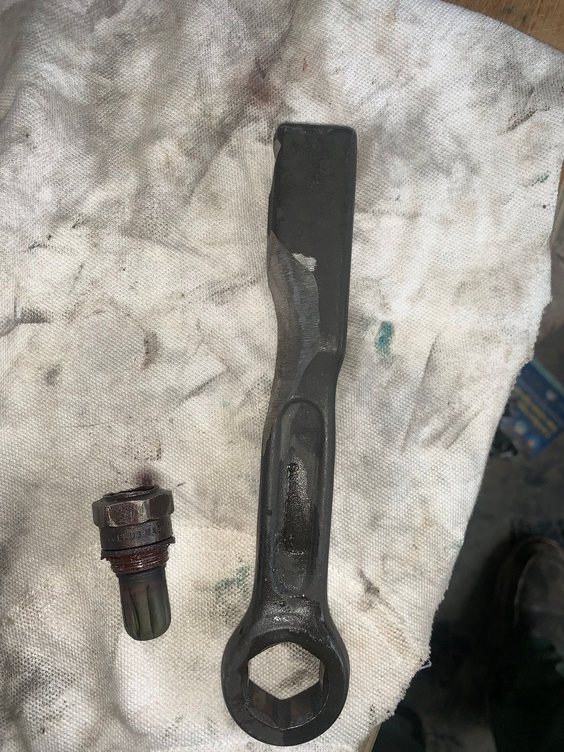

Doing a lot of top-end refresh to my 91 Base L98. Got the it pulled apart down to the injectors. Lower manifold is next.
While I am doing all this, decided to “slap” a new O2 sensor in since the one in there looked very very old. I’m thinking I got the proper O2 sensor removal kit. Shouldn’t take twenty minutes. Ha! First pull, the “sensor” portion pulled out leaving only the sensor nut in the bung. I can’t turn back now. I got a big hole in my exhaust. The hood part of the sensor breakup is I can use a regular six point half-inch drive socket.
Much grumbling, cursing, torching, crawling, PB Blastering, banging later, I ended up ordering a 6-point Striking Wrench.
Had to grind half the handle off to get it on the sensor nut. See pic. I also ground a small notch in the lower handle to fit my crow bar blade into it for my hammer strikes.
I highly recommend this little piece of iron. Before heating with my torch, I hit it with a couple of test strikes to see how my bar would work.
Sensor nut broke free immediately. Came on out.
There was not loss of energy with this little wrench. Worked like a charm.
