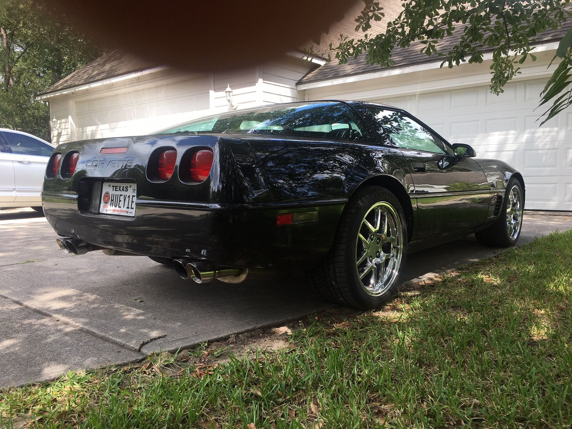

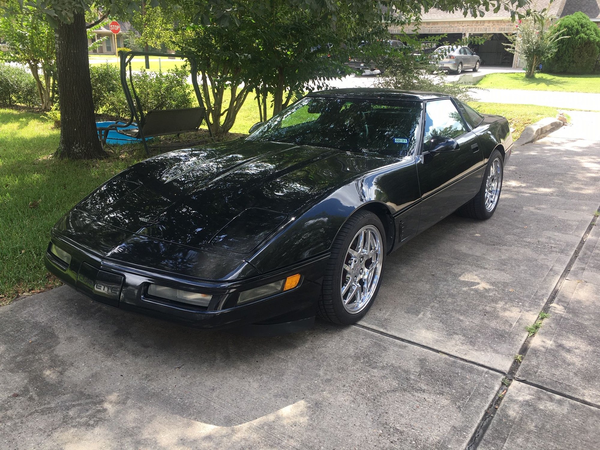

i bought some factory reproductions wheels for my 89 and also put them on my 96 and they fit perfectly. they were the c5 z06 style wheel with c5 offsets. fronts were 18 x 9.5 x 56?mm offset with 275/35-18 tires and the rears were 18 x 10.5 x ?mm offset with 295/35-18 tires.
