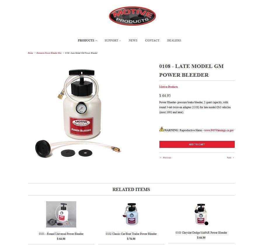

Motive Power Bleeder
And replace the flexible brake lines
