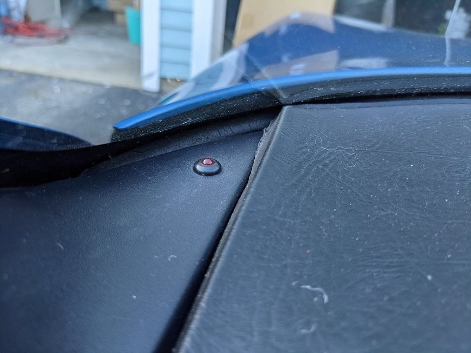

Not to highjack the thread how to remove. But In the same kind of way, is it possible to deal with lifting edges preferably without removing? Or all directions for refitting very welcome. Thanks.
