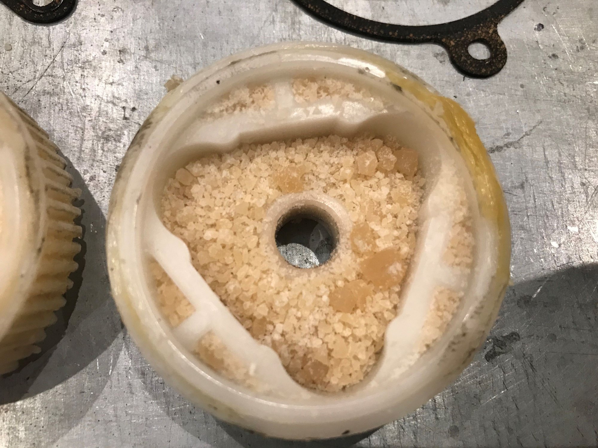

It is the degraded pucks, if it is just a noise at the end. While you are in there, I suggest you replace the gears with the brass ones, and the pucks with the Delrin one. The Corvette suppliers have these as a kit.
This is what degraded pucks look like when you tear it apart
