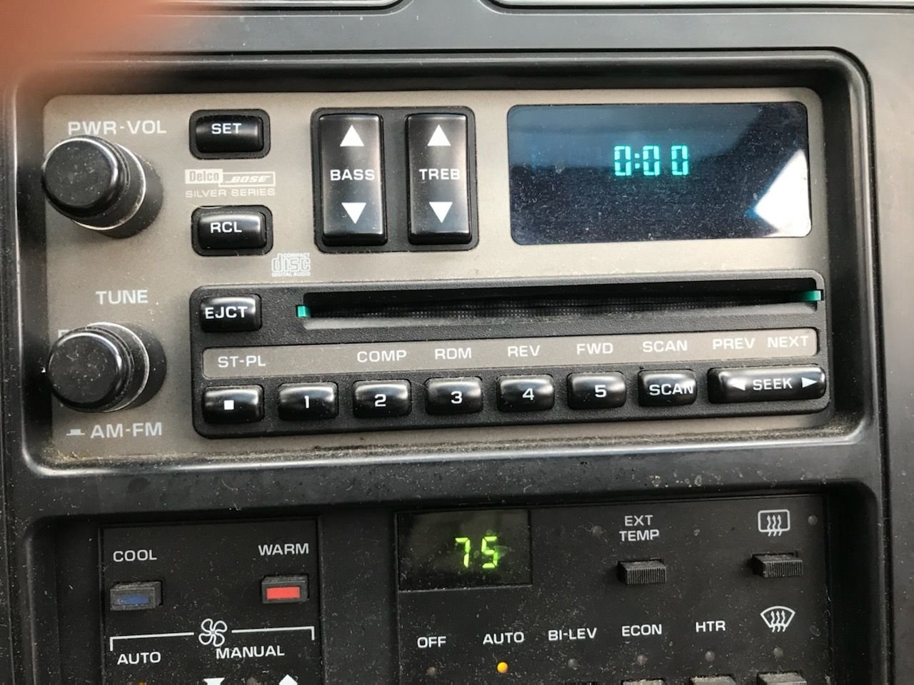

Here is a photo of the stereo in my 87 Vette . I do have power to it but the radio , CD player doesn't play . Also the antenna doesn't go up when you power the radio . thanks

It's not a corvette radio
Did it ever work?
Do all of your inside lights work?

It has not worked since I got the car 4 yrs ago . I believe all the interior lights work . If a pro changes to a traditional stereo does the antenna work off the power to the new radio and can the new speakers use the old wiring . Is there a central unit that all the wiring goes through that will make the install problematic ?

A pro will likely want to change all of the wiring and speakers
You probably have either a bad radio, a bad amp relay, a bad radio and or courtesy fuse, or the radio is simply installed wrong. It needs correct adaptor
Try changing the fuses first
