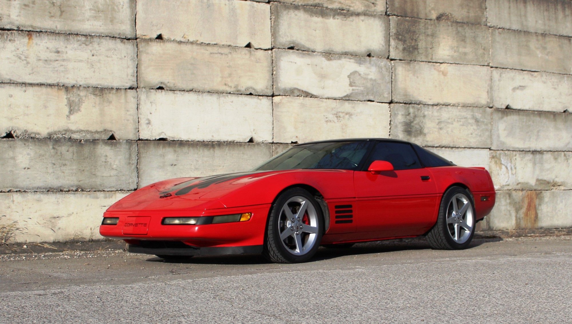

I put C6 wheels on my 94. 18s Frt / 19s rear / 1.5" spacers.
Here's a link to the thread detailing the swap. https://www.corvetteforum.com/forums...d-lowered.html
