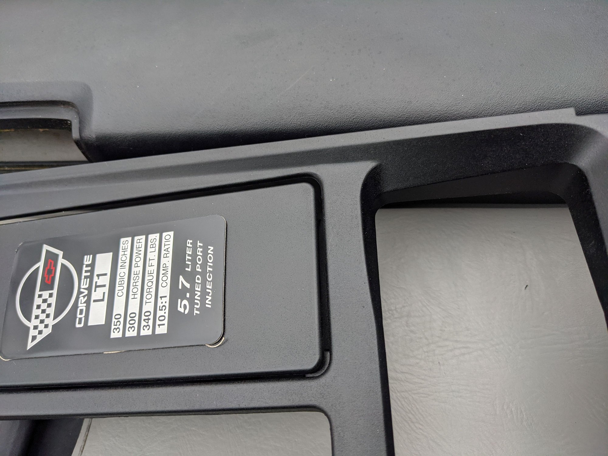

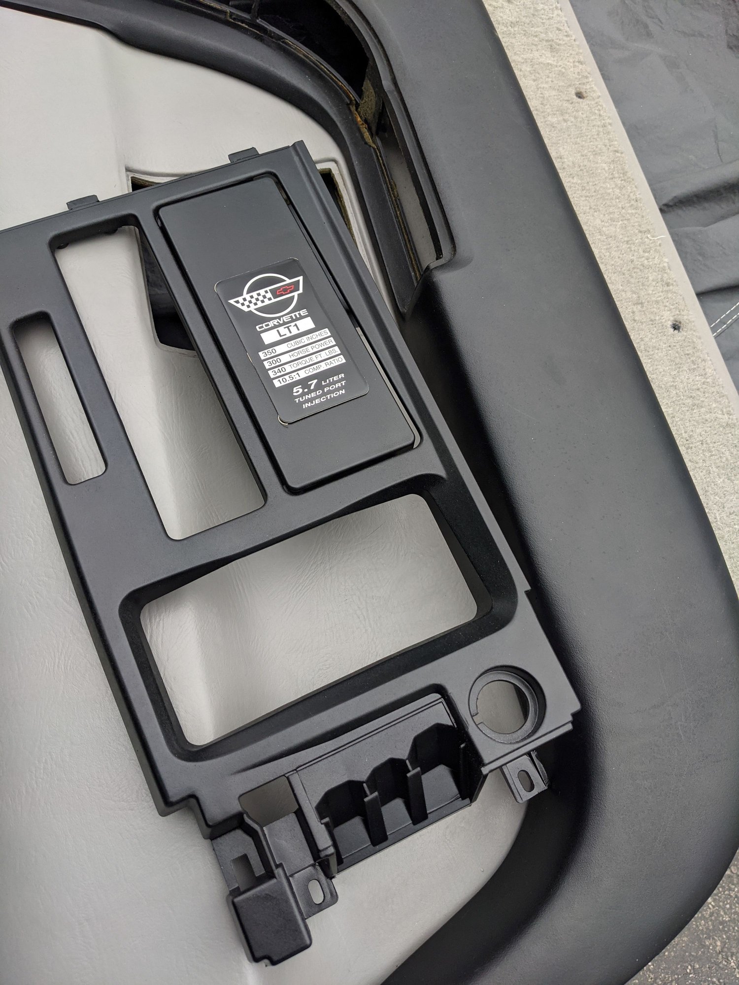

Anyways after thinking about it I believe the original rubberized finish is extinct and I am pretty sure it was applied as a foil transfer in the injection mold. So no surface coating will ever truly replicate the OEM finish but I am getting close to something I am happy with.
raw black plastic base piece that did not have to be stripped.
1. duplicolor adhesion promotor - 2 coats spray top cost within 10 minutes of last recover.
2. plastidip - yes black plastidip drained from aerosol can and sprayed with hplv gun at high air to volume.
3. wet sanded - 1500 with dish soap. too tacky and catches lint easily. rubbery but too light shade and grainy on the surface.
4. duplicolor vinyl and fabric gloss black over it. smoother with almost a naugahyde texture close to the grain of the black arm rest on the door panel. hard but tactile, doesn't scratch at all. The more I run my sandpaper hands over it the better it lays down.
5. pretty happy with it. At least the color and texture maps to something else in the interior.
6. now to do the same to the upper bezel.
garage is a little dusty on the parts.
