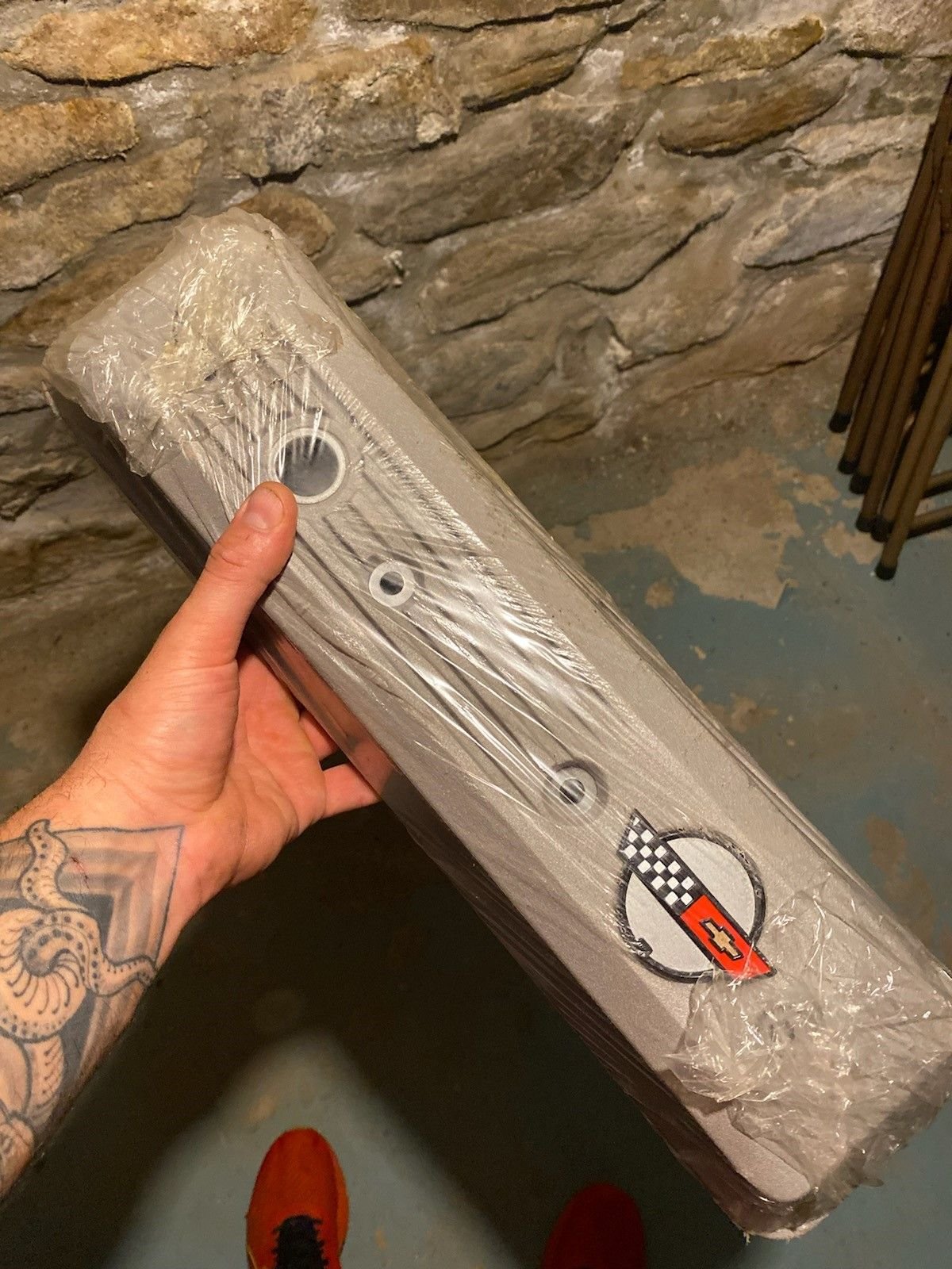

Are these for a L98 or LT1?

L98. LT1 didn't have the logo on the valve cover.

Where did you find those gems?
Still in plastic. Great find.

I was having some electrical work done at the house and one of the guys saw my vette. He said the previous owner of his house left them behind and I can have them if I want

Those from a L98 with aluminum heads

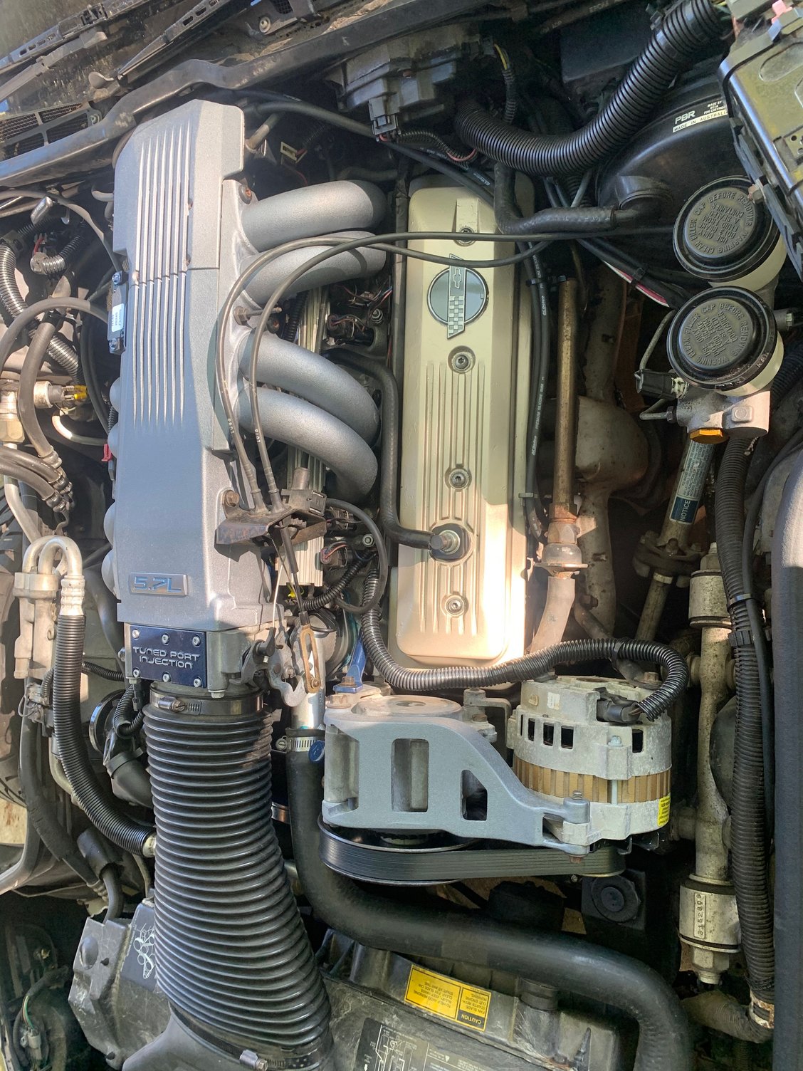

Wow. Pretty cool. Those are identical to the ones on my ‘91 L98 base coupe...except the perfect condition, that is.
Bubble wrap those babies!

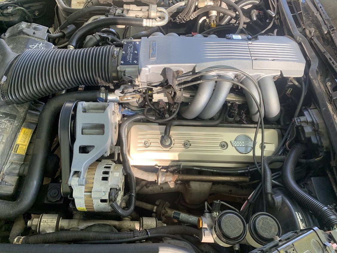

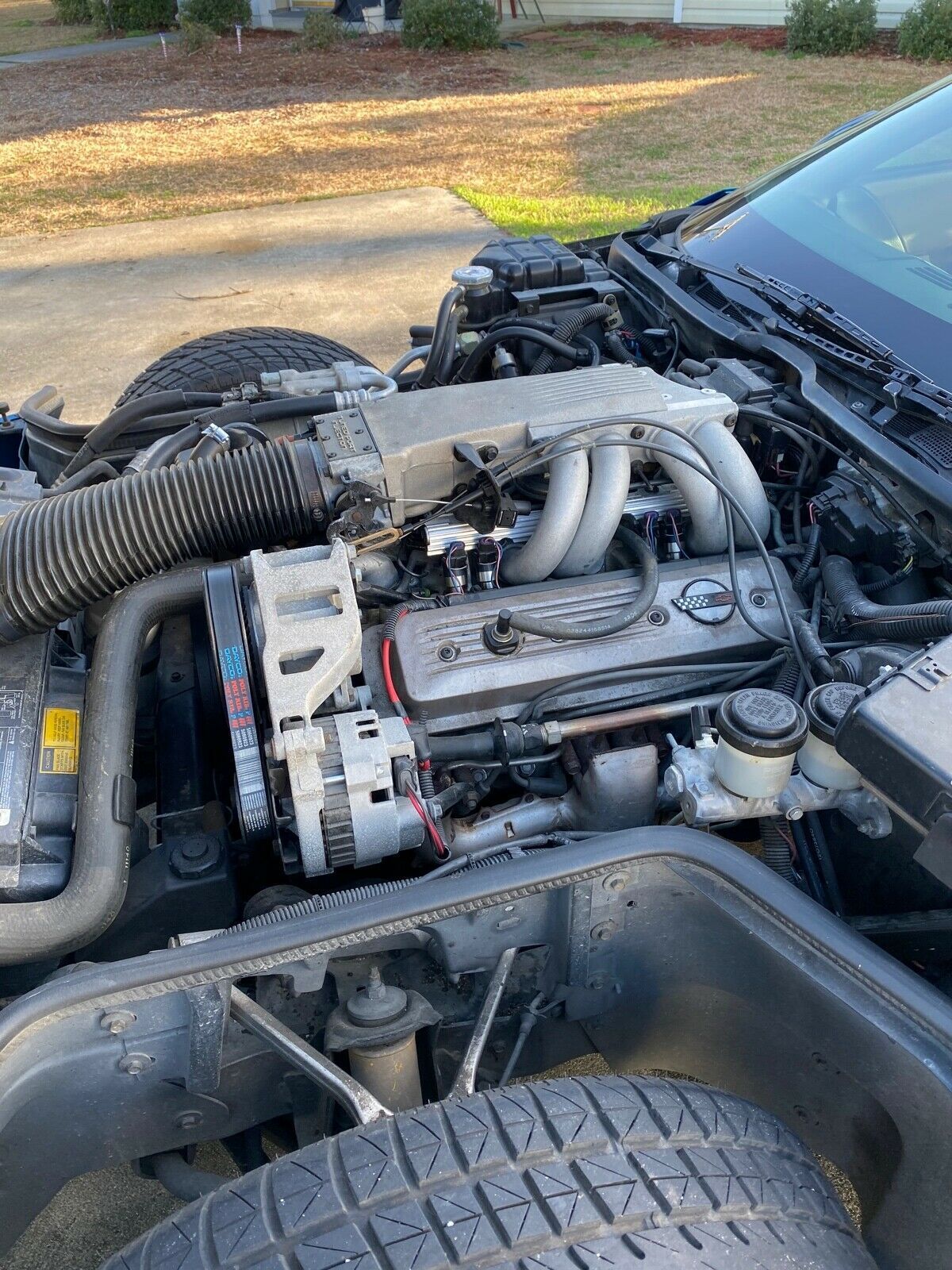

from the emblem, it's a left hand, aluminum head, 86 to 90 L98 center bolt. the 91 L98 had a slightly different emblem making it a one year assembly. as stated, 1992 LT1 did not have an emblem - another one year part. see attached pic - note color scheme, red vs. black, and the gold bowtie, original part number (LH) for 86-90 VC is 10055781, 1991 is 10108588. compared pics. 1991 VC emblems are made from Unobtainium

Ahhh...okay. I see the difference now. Good eye.
I didn’t notice that little difference since I hand painted the emblem on my 91 to color match the car when I tore it down a few months ago. So many little nuances with these cars. You have shown me another one!! Either way, those covers are gems.
