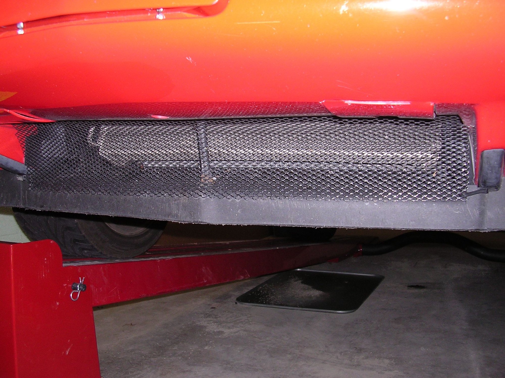

This should have been factory-installed on all C4s:

Or, if you're more of the DIY type, you can make your own, as I did in the one pictured above.
Live well,
SJW
I think yours looks better than the $98 installed version also. I plan to do this as well after lifting radiator to clean out the leaves. Home depot has a expanded metal sheet for $11. Other sized available as well.
Everbilt 24 in. x 1/2 in. x 12 in. Plain Expanded Metal Sheet-801417 - The Home Depot

Originally Posted by sb66
agreed - what type of mesh is that you used?
Search for 'expanded metal sheet'.
Live well,
SJW
agreed - what type of mesh did you use?

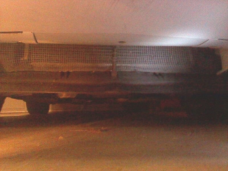

I did the homemade "hardware cloth" (steel mesh) installation too. Doesn't look as pretty as the others but it works awesome. I used 2 layers for strength and regularly find straw, bugs, other debris caught in there. Radiator and condenser are still very clean after 6 years and 28,000 miles.
This thread contains some info about how I fabricated those screens:
https://www.corvetteforum.com/forums...adiator-2.html
It's been about 15 years since I did those, but I think this is what I used for the raw material:
https://www.homedepot.com/p/Amerimax...oduct-overview
Live well,
SJW

I think this is the stuff I used: Home Depot Hardware Cloth 1/4 inch x 3 feet x 5 feet
