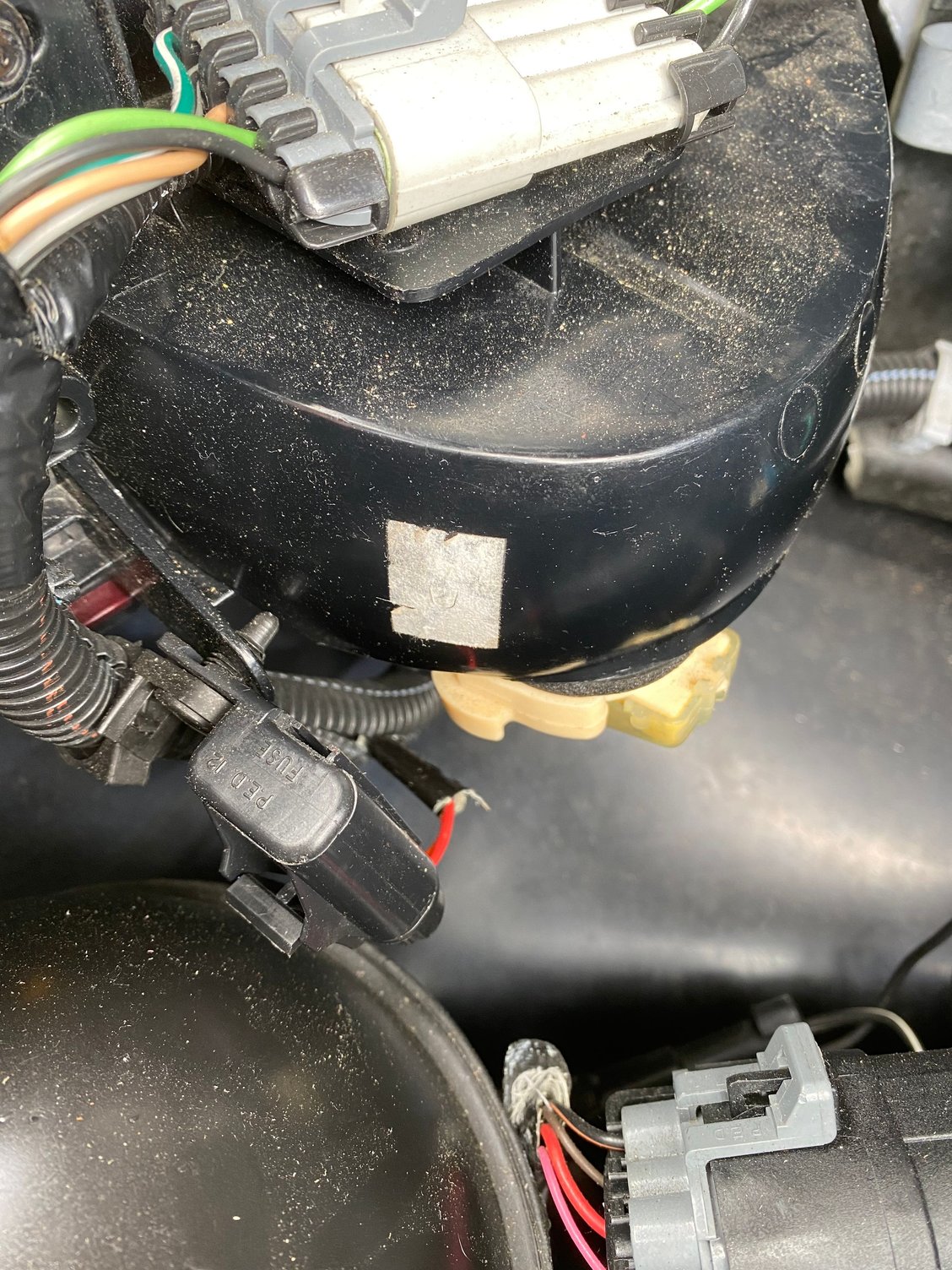

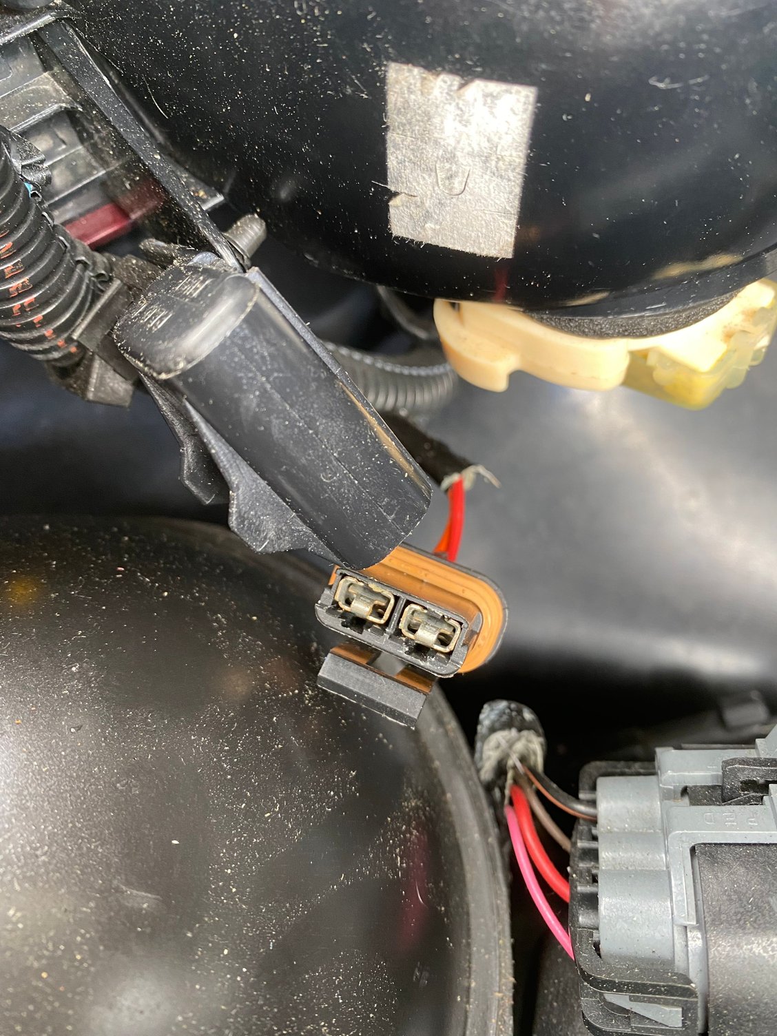

So I started to look a bit closer and noticed this fuse holder attached to the left side marker housing. It's marked FUSE so I opened it up and there's the problem the fuse was missing. I put a 15 amp fuse in the slots and the lights are working! I should have been more thorough before I asked!

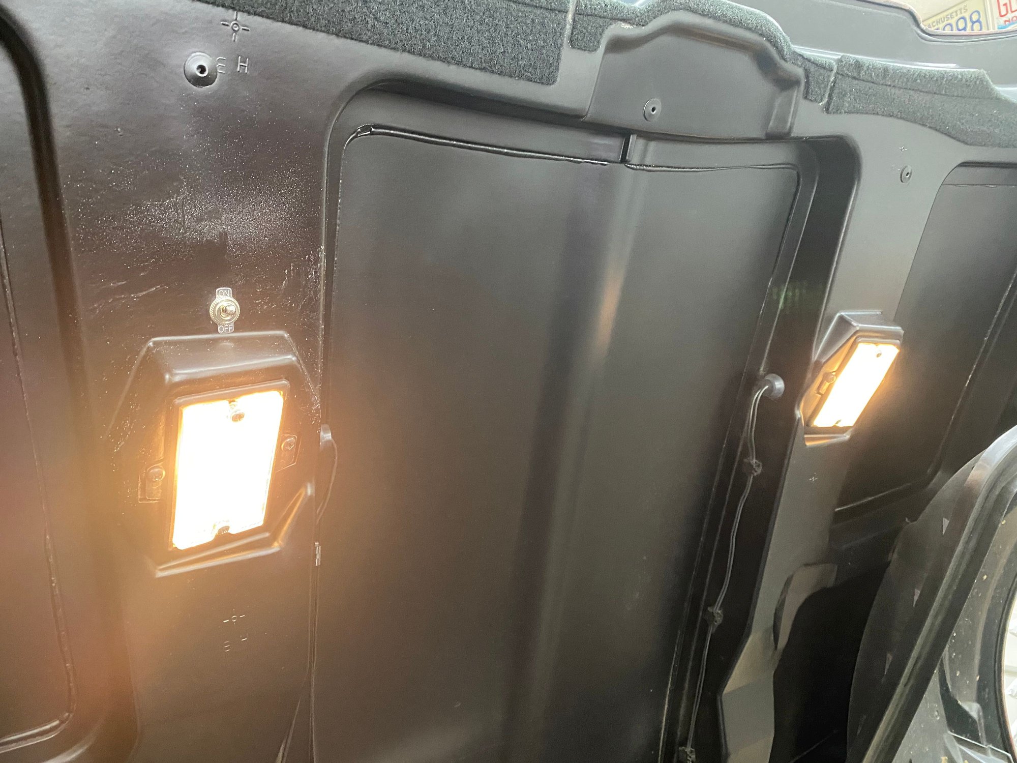

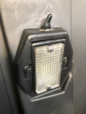

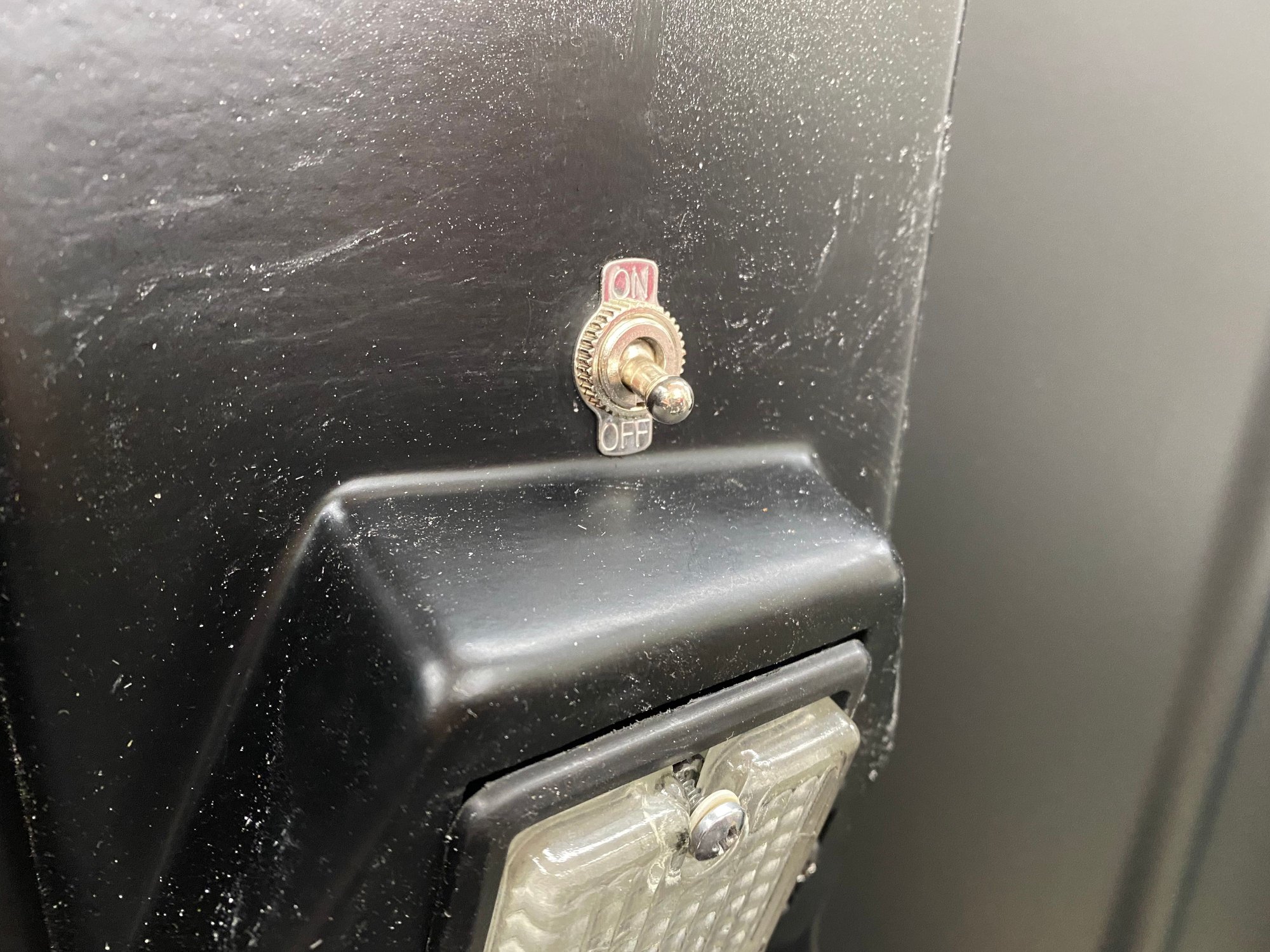

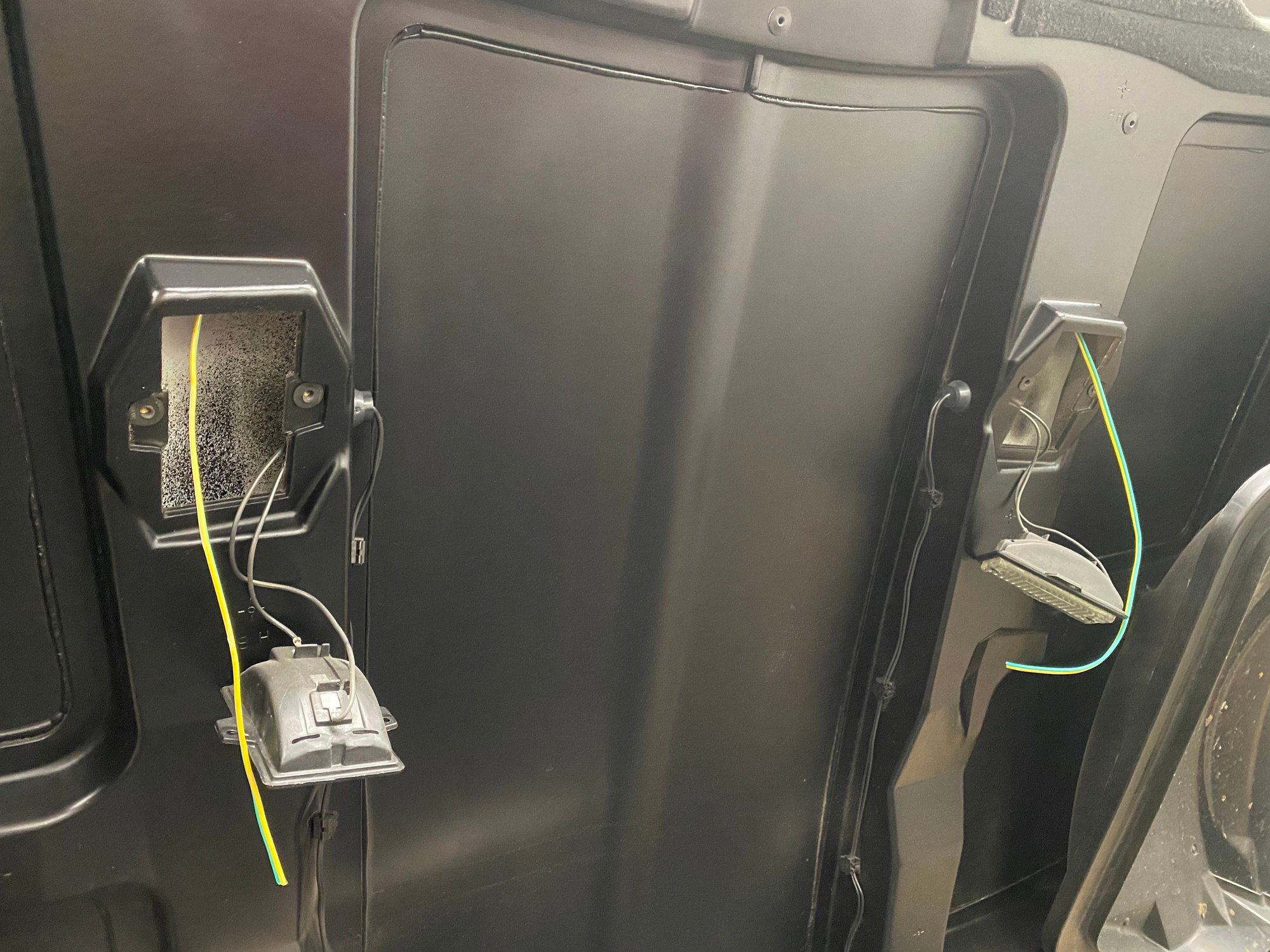

I hope you don't mind...I took your idea of using toggle switches and modified your idea.
I snaked a wire ( two conductor) through the hood cavity and wired the lights up with one switch. I soldered and shrink wrapped the connections and relocated the switch. I was afraid I would have a hole in the wrong place and the light would not fit back in the hood. Anyway here's some pictures

That is a better idea than mine. I have never used these lights since I put the toggles on. They stay off. My garage has good lights and I have never had to get under the hood on a dark road at night. Dan
