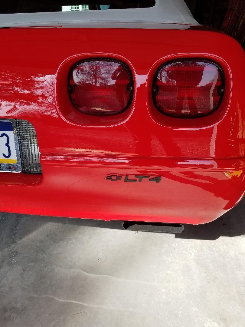

2021 C4 of the Year - Modified Finalist
Originally Posted by cmoistephane
how did you do for the cover bumper molding?
it seems to be an issue.
Im Reasonably sure the Black rubber molding before 92 was attached to the body panels, after 92 the molding is simply a part of the body panel, so you may be able to use the back bumper from an earlier car, but i dont think it'll look very good.
You can see the body molding is a part of the bumper, not added to it.
