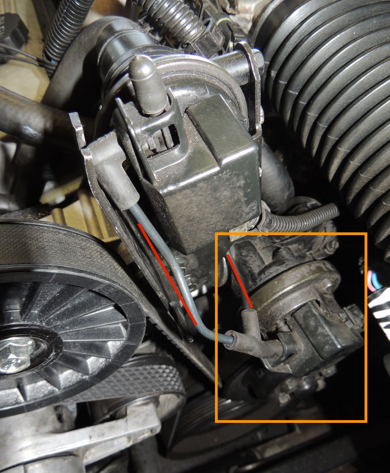

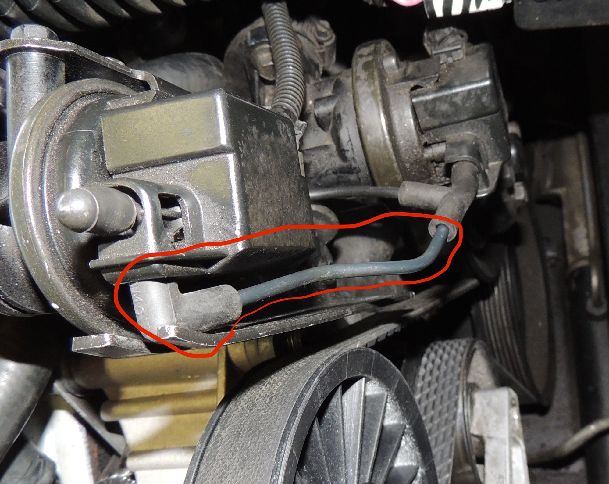

Old May 20, 2021 | 08:21 PM
sb66's Avatar
sb66
Joined: Jun 2016
Posts: 1,058
Likes: 108
From: Ohio
does anyone know what the box/module/relay/sensor thing is inside the orange box in the top photo? whenever I remove either of the vac lines highlighted in red that lead to it, my newly acquired rattle goes away - as soon as the lines are re-connected the rattle returns. I was checking for any vacuum leaks as I was looking for the problem with the 1200 rpm idle - (yes this weekend I am following the you tube for the code and tps correction - the rattle sound started to concern me as well - I removed the belt and tried spinning each accessory to see if any made noise - the tensioner made a little the air pump did not move as freely as the others and seemed to make a fair amount of noise with the belt on as I checked with the stethoscope
any thoughts or help would be great
thanks
Sean
Old May 21, 2021 | 05:39 AM
hcbph's Avatar
hcbph
Joined: Aug 2013
Posts: 4,430
Likes: 608
From: Minneapolis Mn
Originally Posted by rocco16
The coolant amount seems right, but I've never had a SBC that idled above 800 rpm Most were right at 600..
Early on I had idle issues with mine, it at times sat around 1700 rpm's. Found if you tapped the iac with a plastic faced hammer the idle would drop to 600-700 rpms. Replaced the IAC valve and all has been good since.
Just some FYI.
Old May 21, 2021 | 04:04 PM
sb66's Avatar
sb66
Joined: Jun 2016
Posts: 1,058
Likes: 108
From: Ohio
thanks - I will try that as well - I bought a new gasket kit for the entire tb just in case - tps or iac - is the IAC rebuildable - or not even worth it - ?
