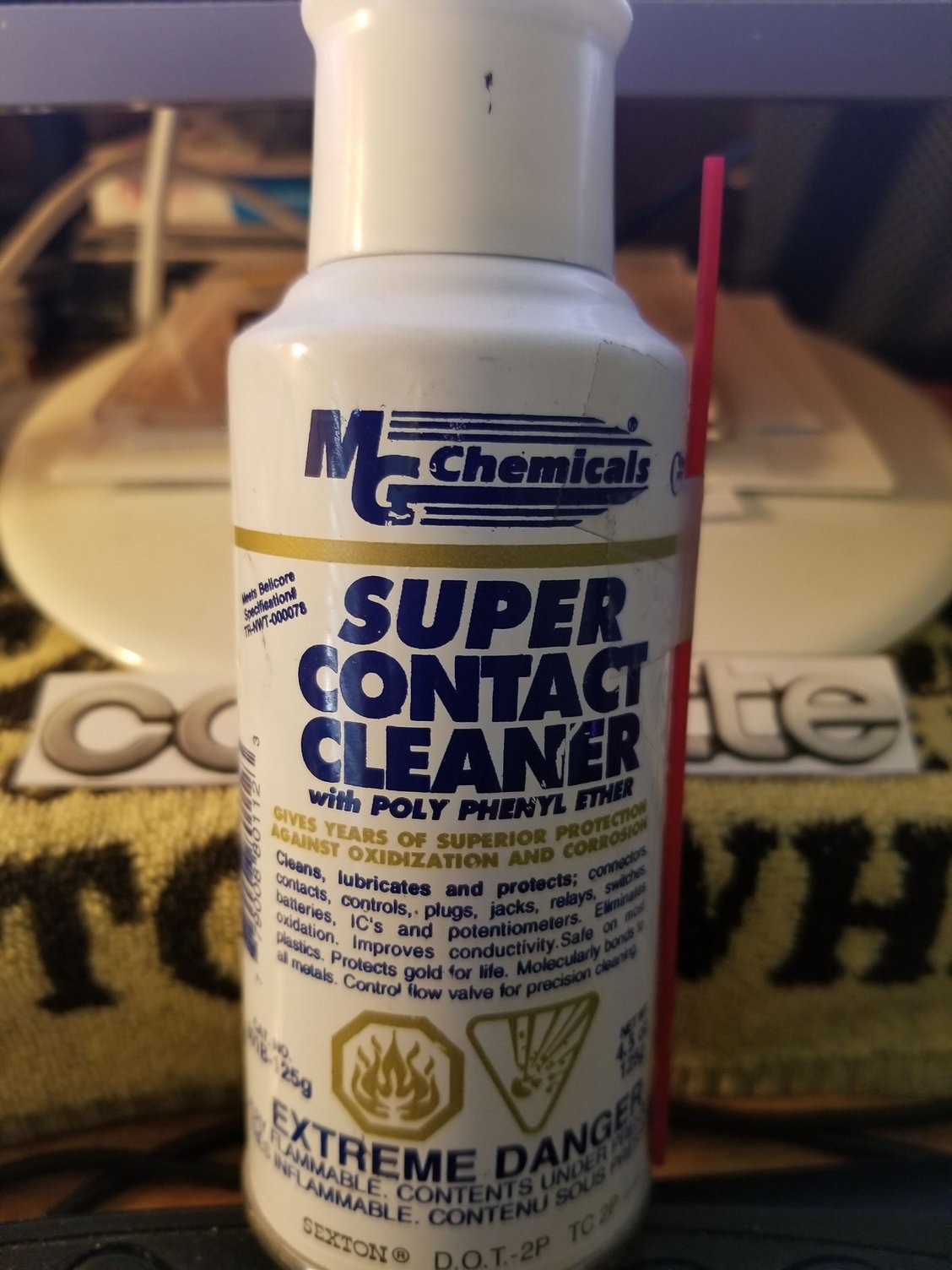

Old Jun 29, 2021 | 07:17 PM
Buccaneer's Avatar
Buccaneer
Joined: Nov 2005
Posts: 3,532
Likes: 1,185
From: Arizona - If you don’t know CFI, STOP proliferating the myths around it...
I love this stuff and have been using it for a very long time. I originally used in on dirty/noisy switches, but it does a lot more than that and lasts a long time.
