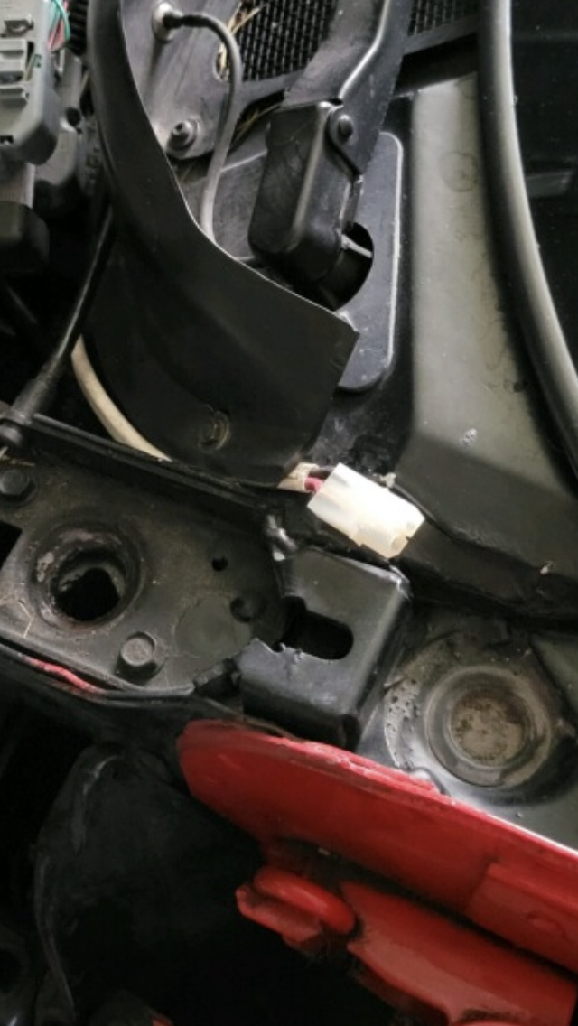

Son looking at 1995 corvette, anyone know what this unplugged wire is for ?

Trace back to where the wire runs to and take a picture.

Battery tender plug added by owner?

Guess he’ll have to do some tracing.

My lawnmower has a charger plug like that.
BINGO, that’s what it is. Thank you Sir

I suggest you cap that sucker when it's not in use. Get enough water in/around that plug near the contacts and you have the battery shorting out to itself, and that location is close to where water pools in the low part of the cowl / latch area if the drain clogs up.

Clever idea.
