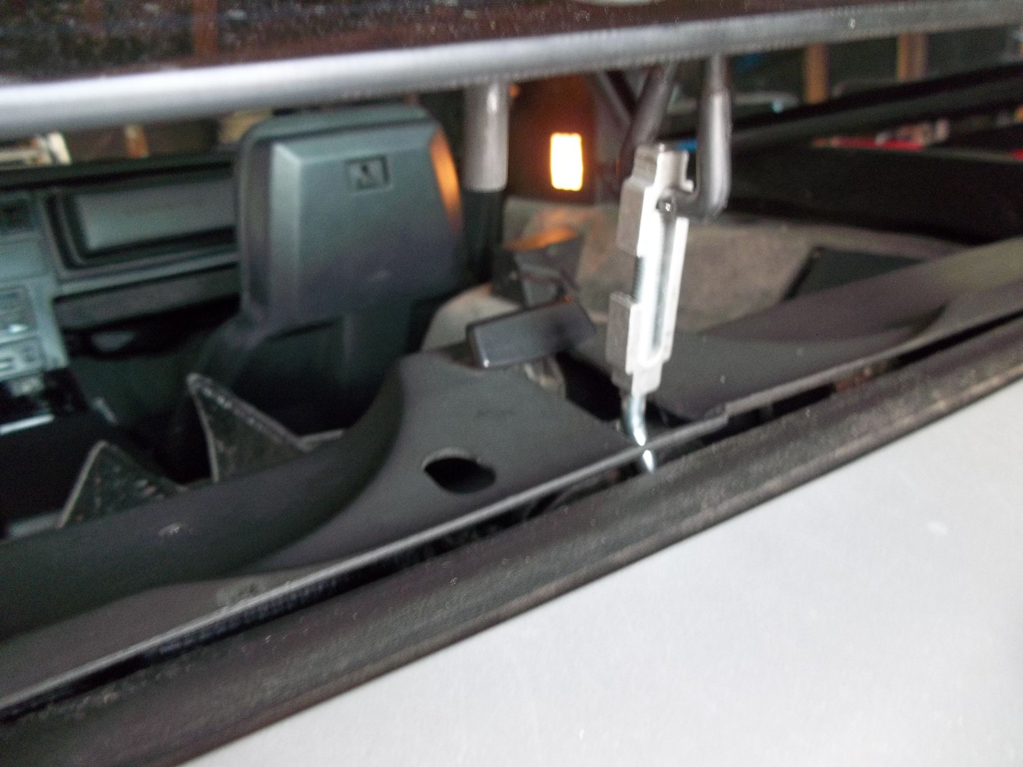

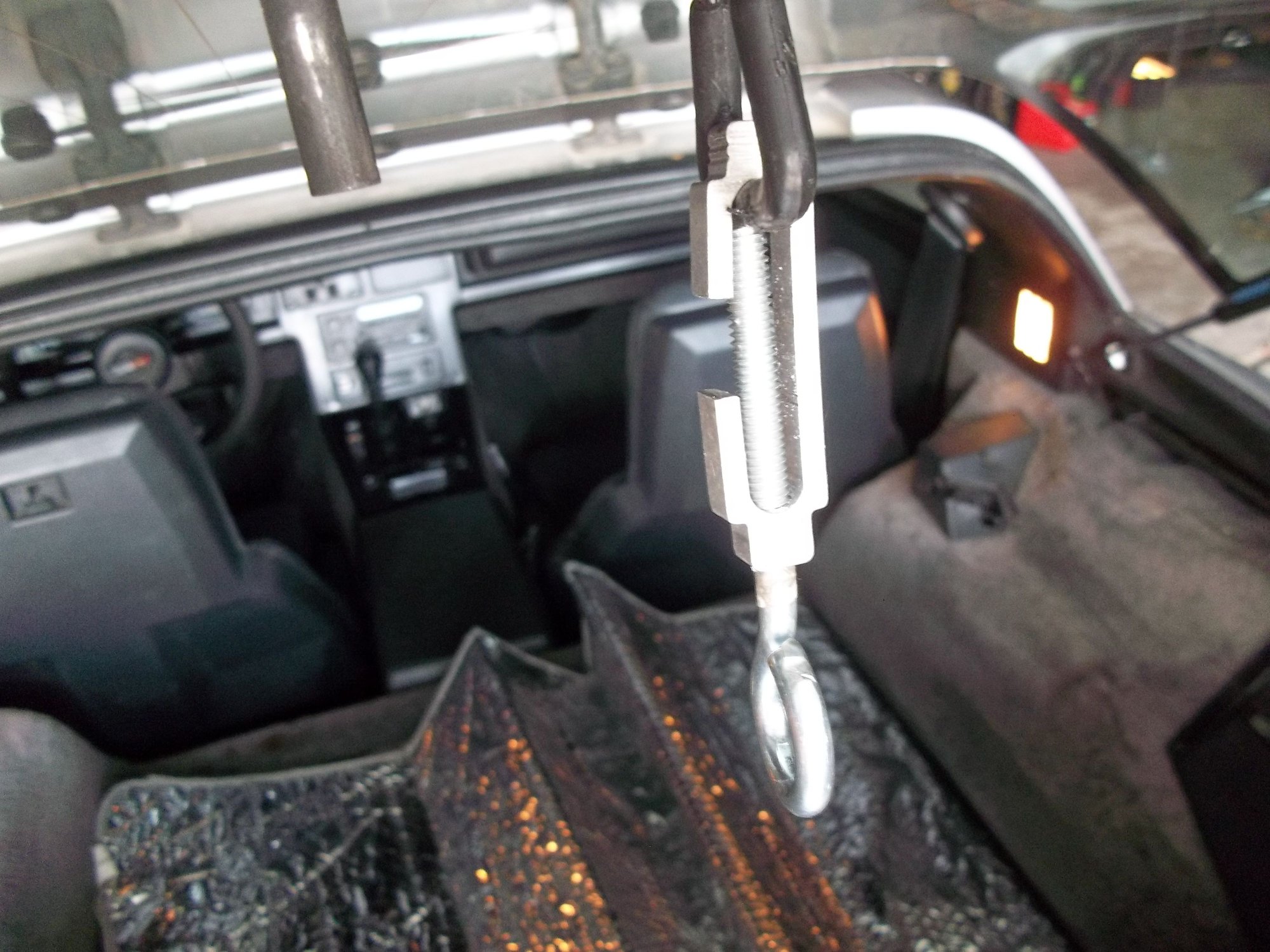

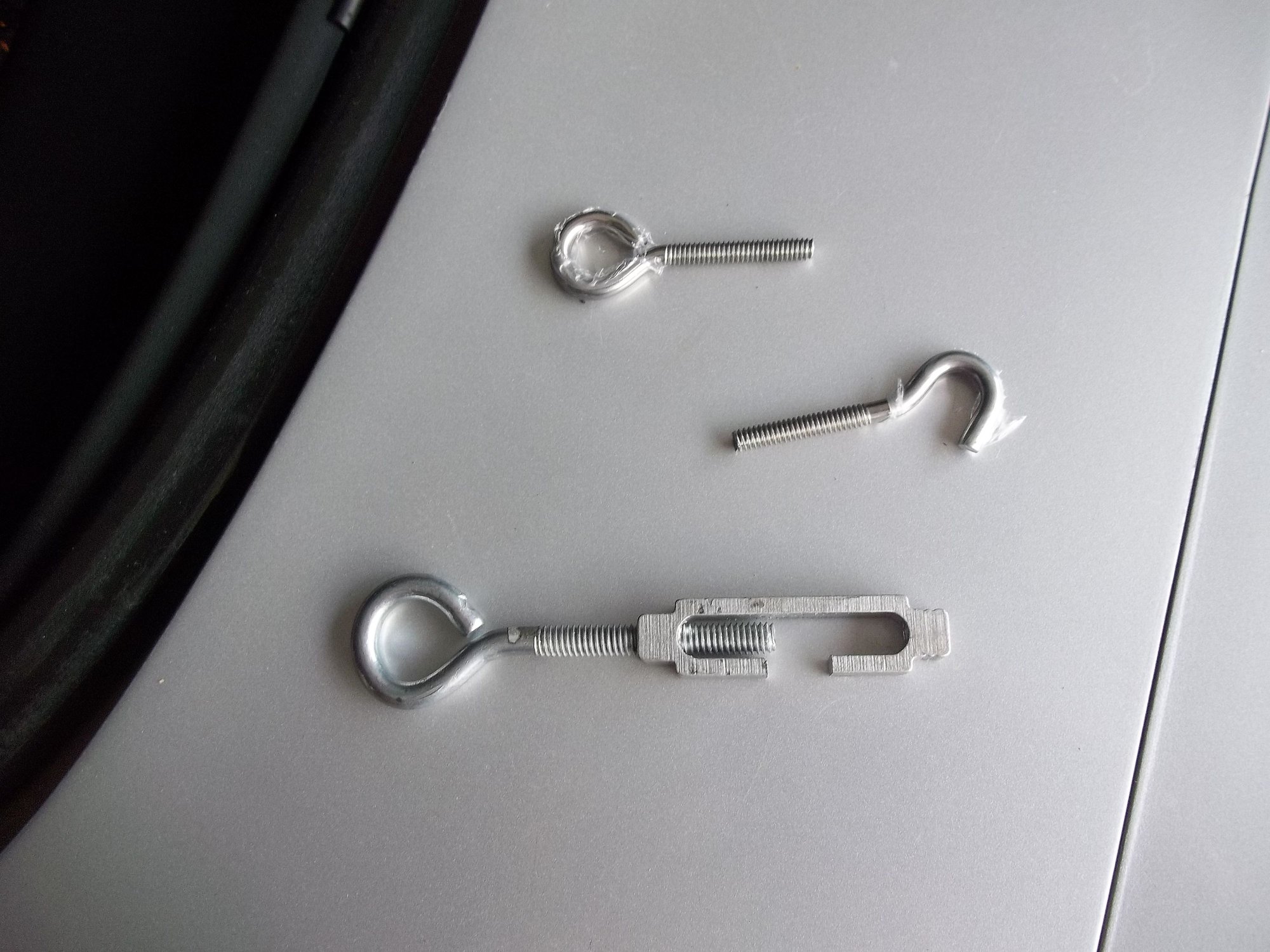

I always wanted to try a hatch vent so I decided to make my own. I cost me $7.62 in hardware and I used tools I already had. You will need to buy (1) 1/4 turnbuckle Everbilt 372 057 and (1) 5/16 x4" eye bolt Everbilt 115 410. Take hardware out of the turnbuckle as you won't need that, drill and tap one of the holes in the turnbuckle in 5/16 thread. Then put the turnbuckle in a vise and cut a section out with a hacksaw, Now you can assemble it and try it out. The eye bolt fits a little loose in the catch, so I layer it in shrink wrap later. Now I need to make a long button to keep off the dome lights.

The one picture looks like it's bending the turnbuckle a bit, I might have to add a pivoting arm catch to tension both sides.

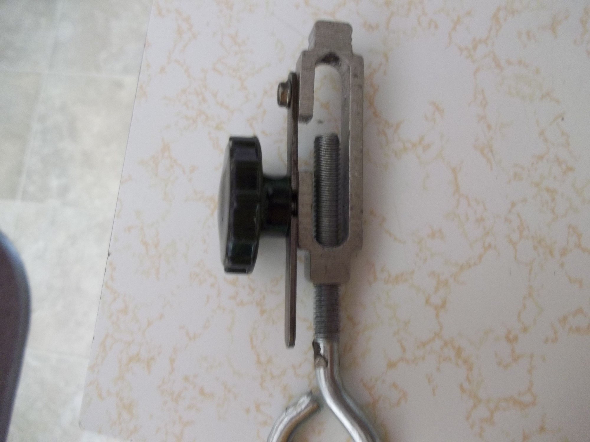

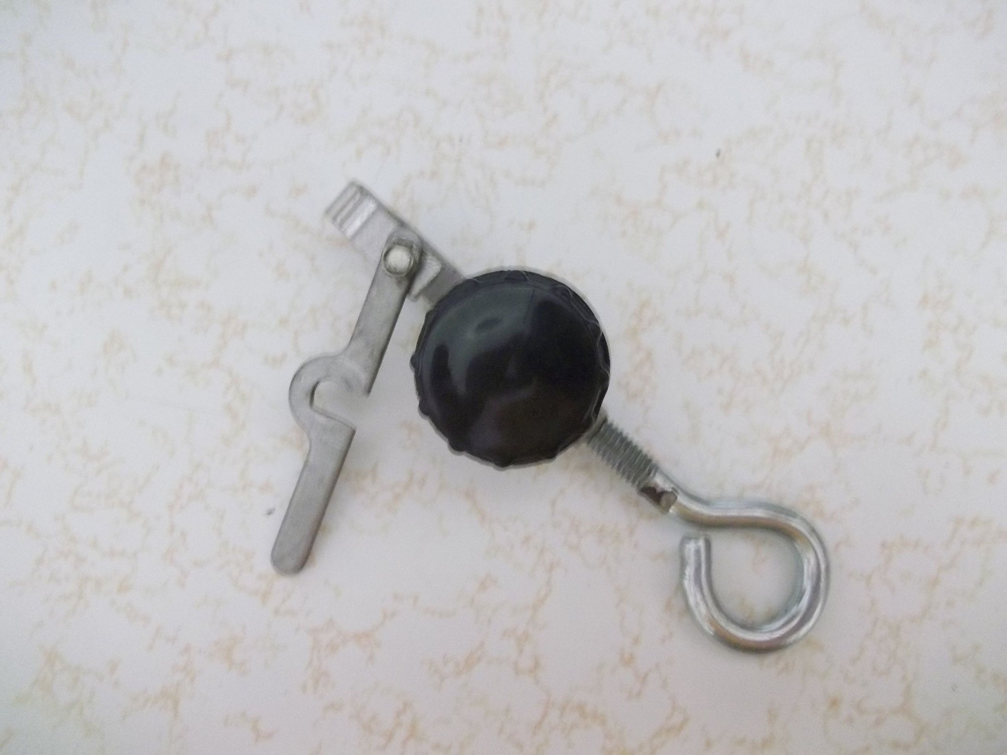

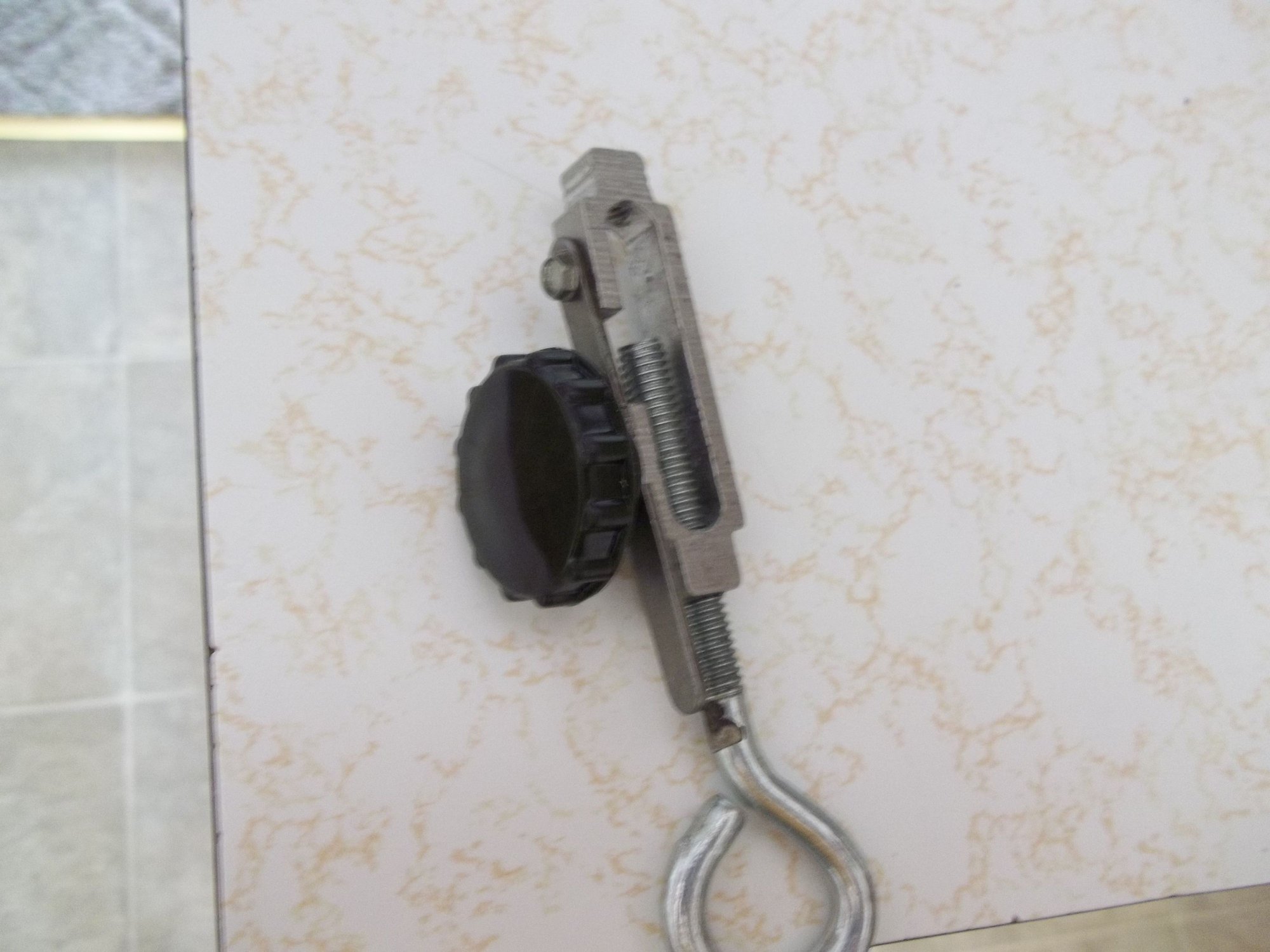

Mk II version, I used a **** and a SBC valve cover hold down to make a latch.Up to $10 now.
