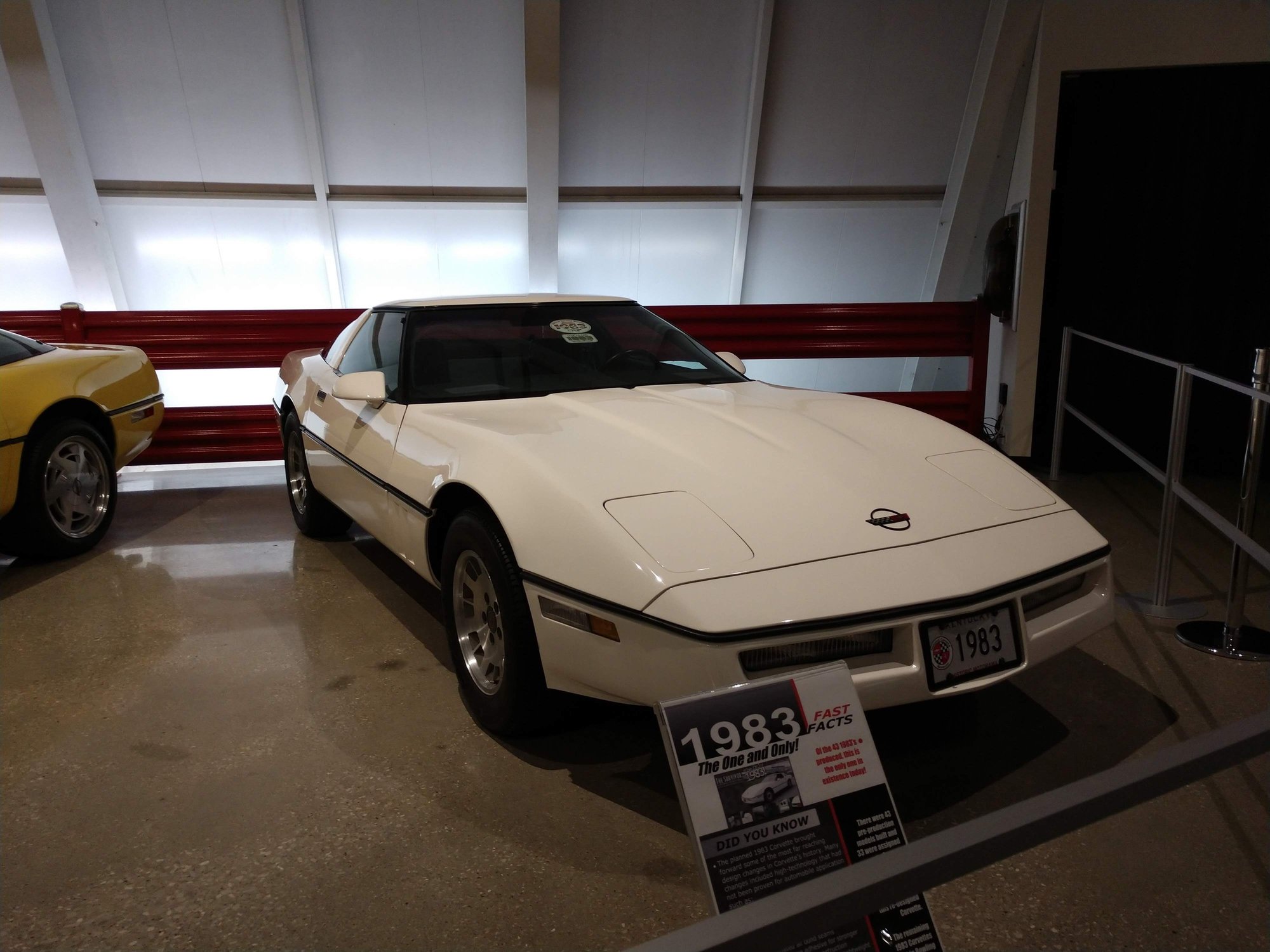

1983 Corvette at NCM in Bowling Green, KY.
The wheels may be 16" on the 83. This is one of several pre productions cars .
