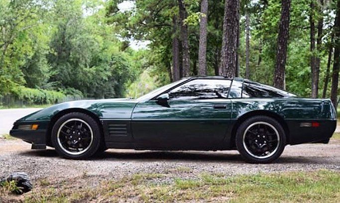

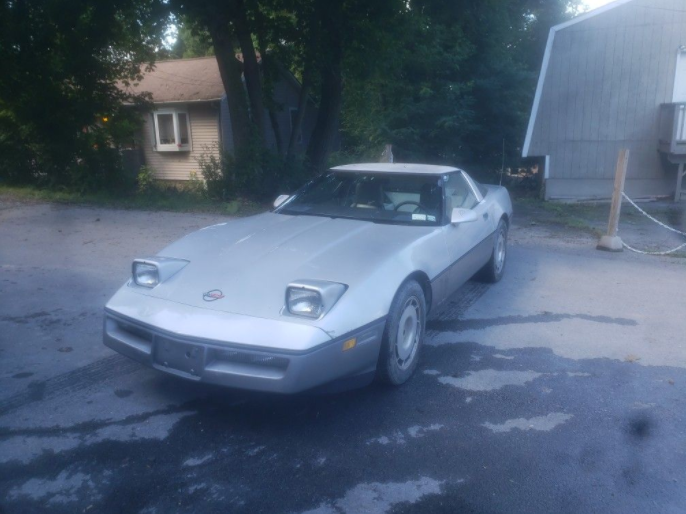

This is how the car sits
and this is what I would like it to look like this coming summer

Are you going to change the front/rear caps to match the later year C4’s or are you referring to the shine on that paint?
Your two-tone 84 will get plenty of attention if you get it all original and mint with glossy paint. The 84 was, and is, a special part of Corvette history. Get the book on the history of the C4 development. Interesting.
Great find. Congratulations.
Old Dec 26, 2021 | 10:26 PM
PkStreetSoldier's Avatar
PkStreetSoldier
Joined: Dec 2021
Posts: 38
From: 10950
Thanks, I am just talking about the paint job and rims no bumper changing. But I was also thinking the same thing keeping it stock paint because it will keep it all original.
