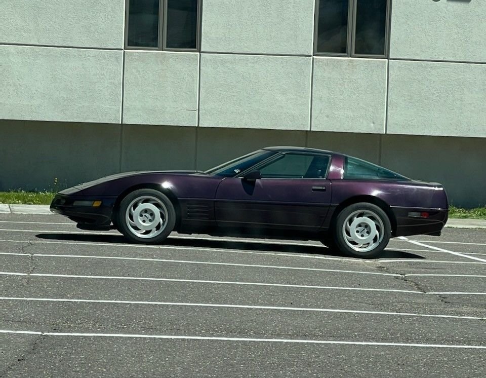

Jumping on this old thread to vent:
I had a guy tell me this weekend "nice car but your wheels are on wrong". He claims to be a trained wheel specialist of some sort. (He had been drinking so I tried to tune him out and ignore him because I don't like arguing with drunks.)
He was going on about how GM designed them to suck air in to cool the brakes. With that logic, why did GM put them on "wrong" for every C4 leaving the factory then? lol
My beloved 92 6speed
