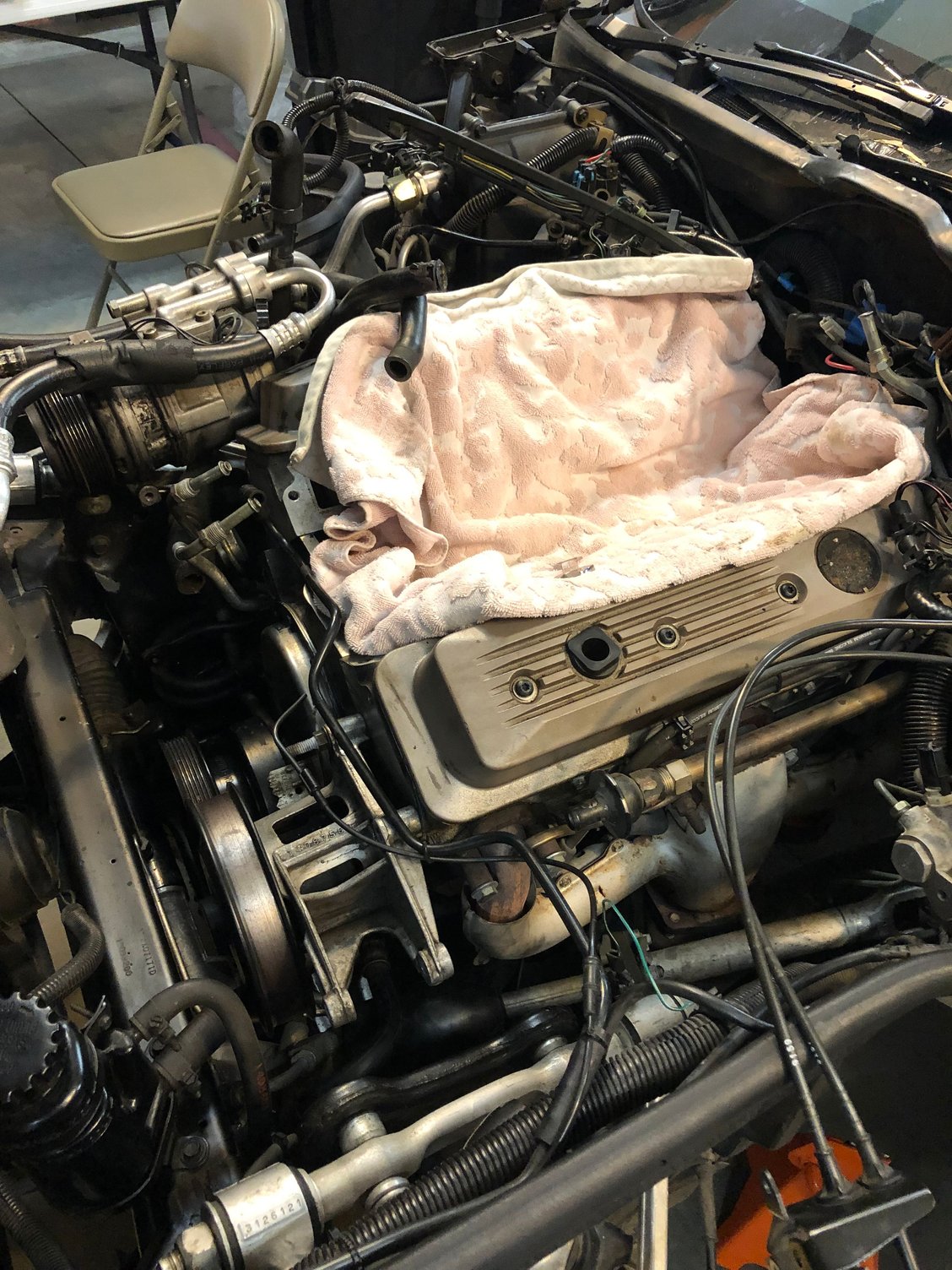

TPI motor is the prettiest motor every produced. I'm doing my injectors now. The OEM injectors are short lived.
LT1 Motor, I never never had an opti spark problem. 140,000 miles, still OEM opti. 6 water pumps, yes, but the opti lives. I wouldn't worry about an opti.

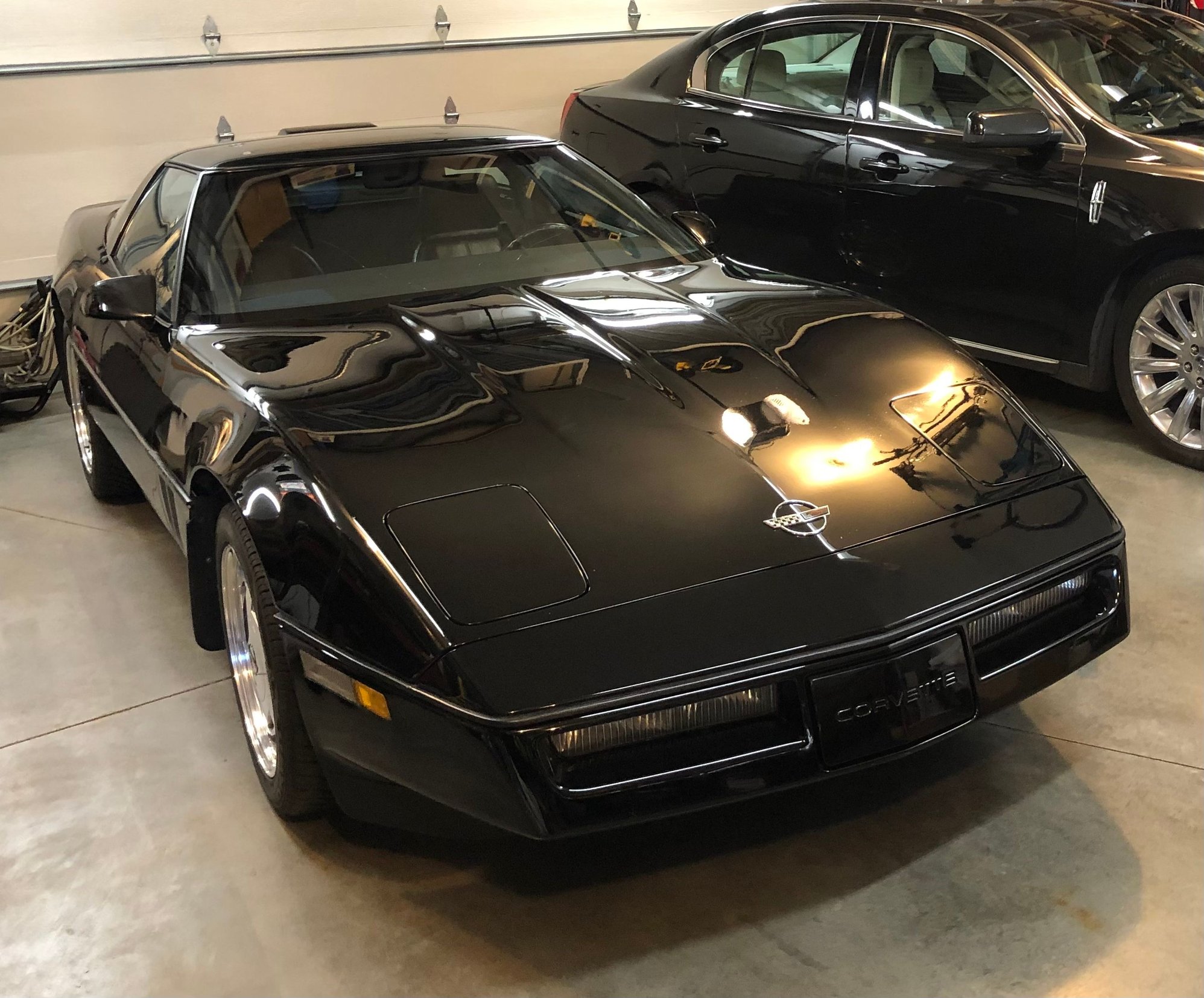

I’ve had my 89 Corvette coupe for over 20 years. Drove my wife to the hospital to deliver our twins in it, they just turned 20 last month. (yes still married too!)
I still love this Corvette!
When I bought it I was still heavily into Autocrossing which is why I bought this specific one. It literally has every option except B2K & the block heater. So all the high performance options including the 6speed manual trans which I love as much as the sport seats that can squeeze you tightly.
Unfortunately the poor girl has been idle for over 10 years now. I had one injector go bad & then parked her as life & other cars took priority. Around a month ago it was finally her time, so apart she came. After sitting idle for so long there’s a whole bunch more I’m doing to make sure she’s 100% when done. With only 72k miles on her, I’m debating about replacing the timing chain & gears since the water pump is off & it’s so close. Other than a cat back Exhaust, she’s all stock & original but it’s hard not to want to do cam & some head work, after all I’m right there...
I can’t wait to roast the hides off these 20 year old tires!
