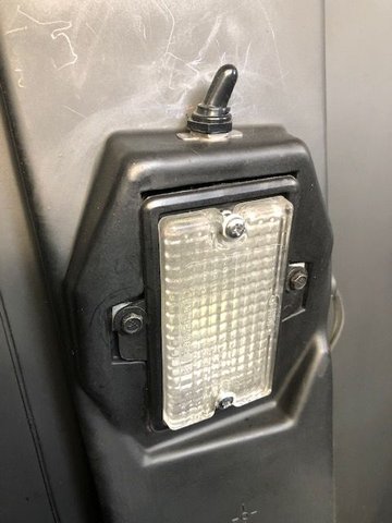

I understand doing any roadside repair at night to the engine would be a rare occurrence, they would be helpful for "seeing" a problem (blown hose, broken belt, etc.). But I think they would be very helpful if you were changing a front tire on the side of the road at night! I love this feature, so much so, that I upgraded my original plastic lenses with NOS glass lenses and using "weather-pack" connectors I wired in weather proof toggle switches on each side, so that each light can be controlled independently! So, 99% of the time they are switched "off", but in the event that I need to shed a little light on the situation, a flick of the toggle switch and I'm in business👍
Switch above side marker bulb socket
Used side marker mounting screw on both sides, so no extra holes/alterations. Mounted toggle switches to facing out when off!
