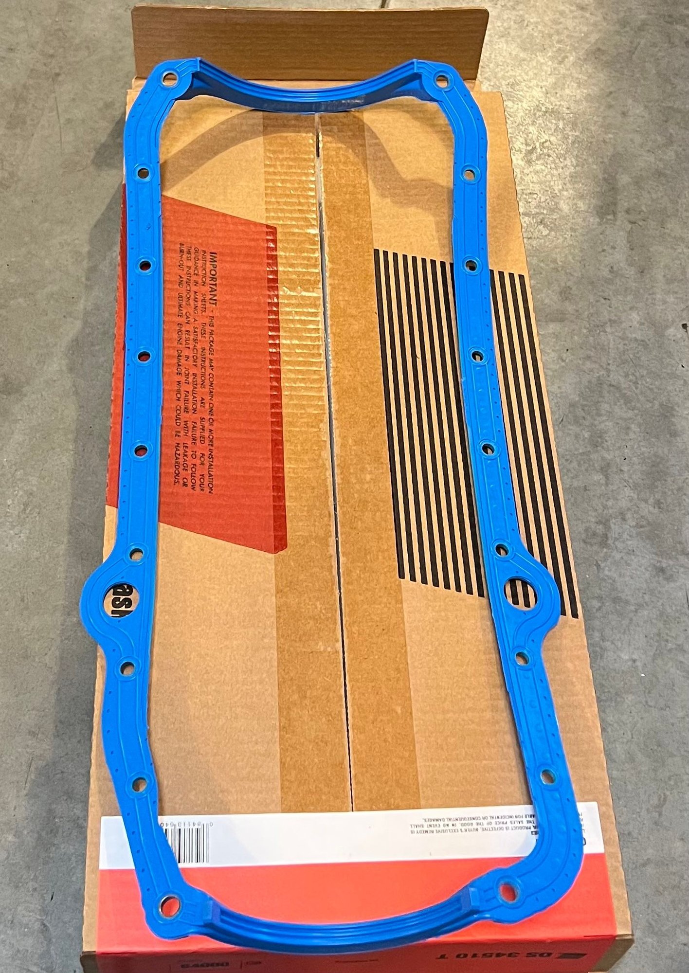

I opened the FelPro oil pan gasket OS34510T I’d bought from Summit based on their recommendation. However, I found it has two dip stick options, left or right. Not sure about using it I called FelPro & was told it was the wrong number. I was told I needed OS34500R but they couldn’t tell me how the two gaskets were different or if I could use the one I had with the stock oil pan. Does anyone know if I should or shouldn’t use the one I have?

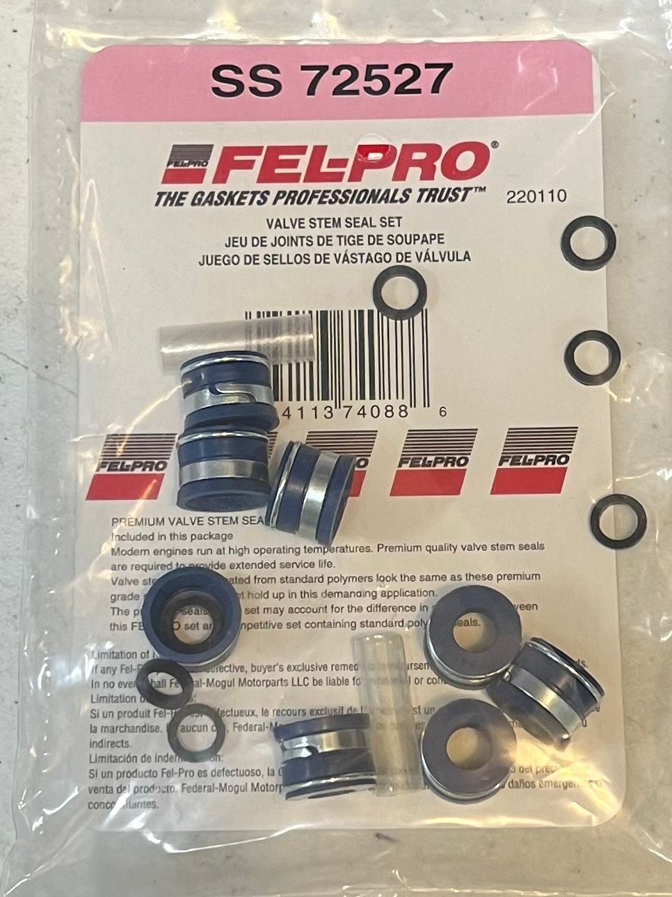

I was recommended by some altogether different to use the FelPro valve stem seal set SS72527, for both the intake & exhaust valve stems. Talking to FelPro they recommended this to be used only on the intake valves & use SS72877 for exhaust valves. What do you guys recommend here & do I use both the large & small seals in the kit?

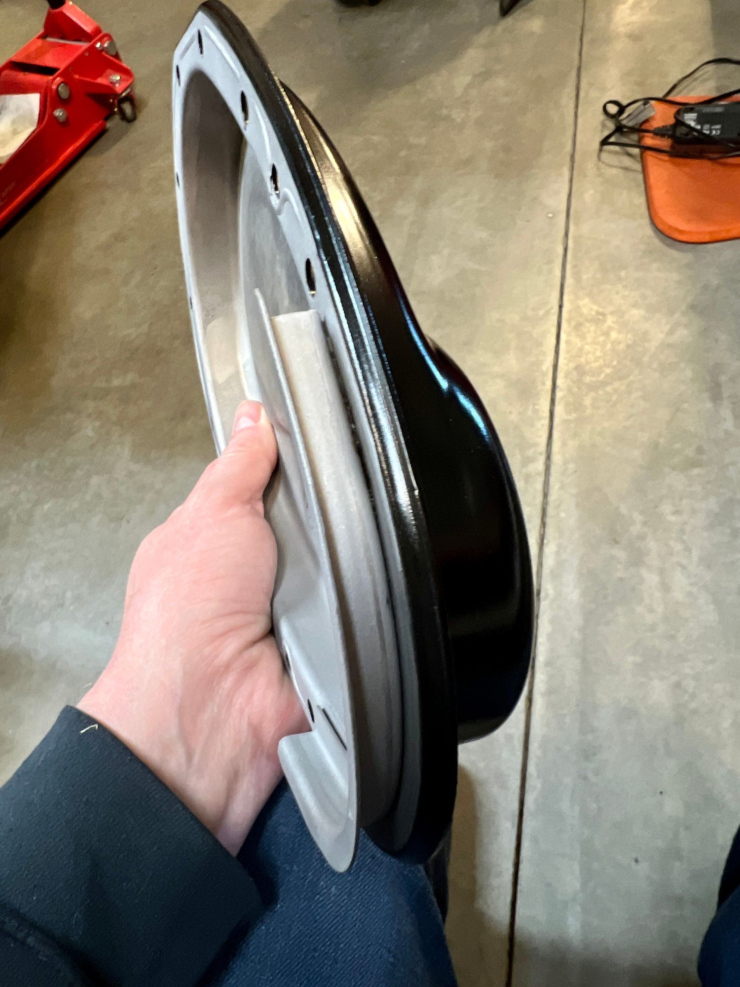

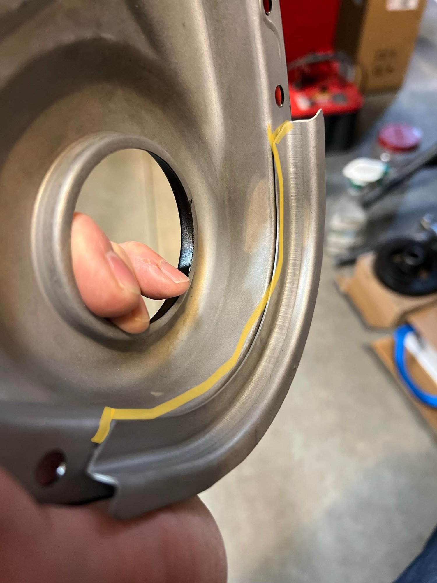

Finally, since I’m trying to eliminate oil leaks because I’m tired of laying in them or walking through them by accident, should I look at sealing the front oil pan seal metal “U” by either a bit of RTV on the inside or outside edge where the two metals come together? Naturally pushing it in the grove with my finger & pulling off any excess, so it’s only in the grove.
or here on the other side?

The FelPro VS 50088 R is a direct interchange from the OE/GM 14088564, The OS 34500 R is also a direct interchange from the OE/GM 14088505.

VS 50088R is correct for the valve cover gaskets both sides as WVZR-1 said. Oil Pan should be OS 34500R.

Yes, you can use the valve guides seals SS 72527 for both intake and exhaust as you have read. The exhaust seals are the umbrella type in the official FelPro fitment SS 72877 but using the intake sets on both intake/exhaust will give you a more positive oil seal.
On the timing cover, I haven't had to use silicone on the lower area like you're describing but it couldn't hurt as long as you get it only into the smaller groove as you've described. I installed mine last year using all the recommended FelPro products and I haven't had any leaks in that area, or any other for that matter. Their stuff is good!
