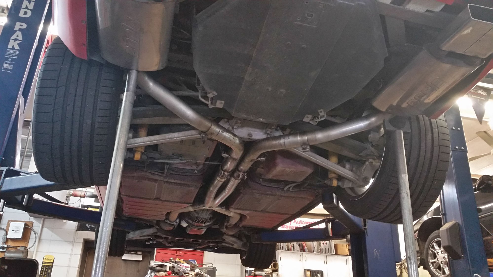

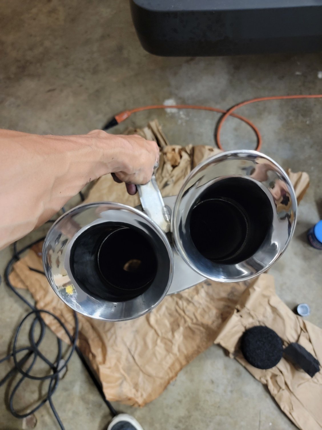

I bought these used. Mufflers only. Before I cleaned/polished them.
After
Both done. They are the old school Corsa. The "corsa" lettering is raised on the tips.
Wouldnt fit in the C4. So I took them in my xjr 100. Went back in the C4. Truthfully though, I'm just showing off my xjr 100 here
Not happy with the tailpipe fitment. But they struggled to get them how they are. Oh well. I'll figure something out. I got them to cut the resonator out. Put straight pipe in place. Kept the factory H pipe. Im happy with the sound. Sounds very deep, especially for a Corsa. No drone. Headers will be perfection.....even more so with an lt4 hotcam.
