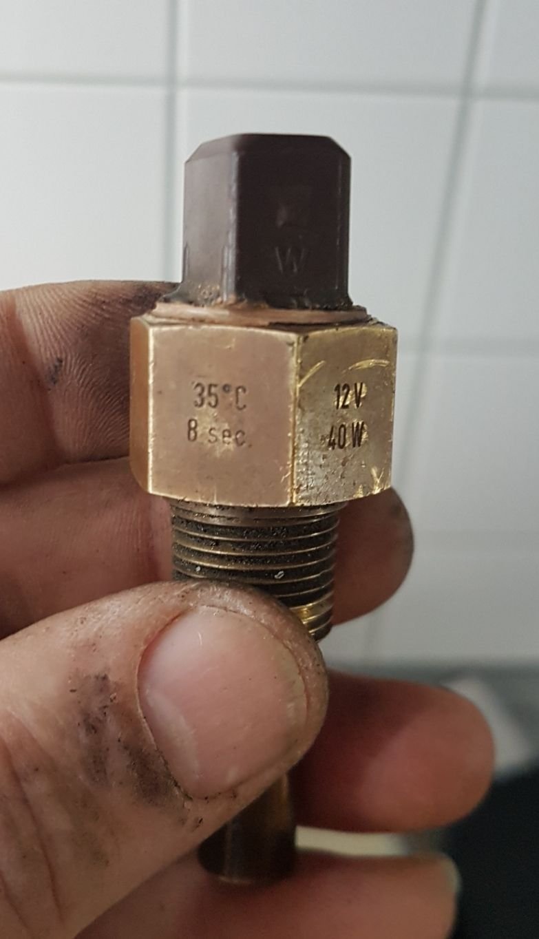

Code 45, I have been working this code for some time.

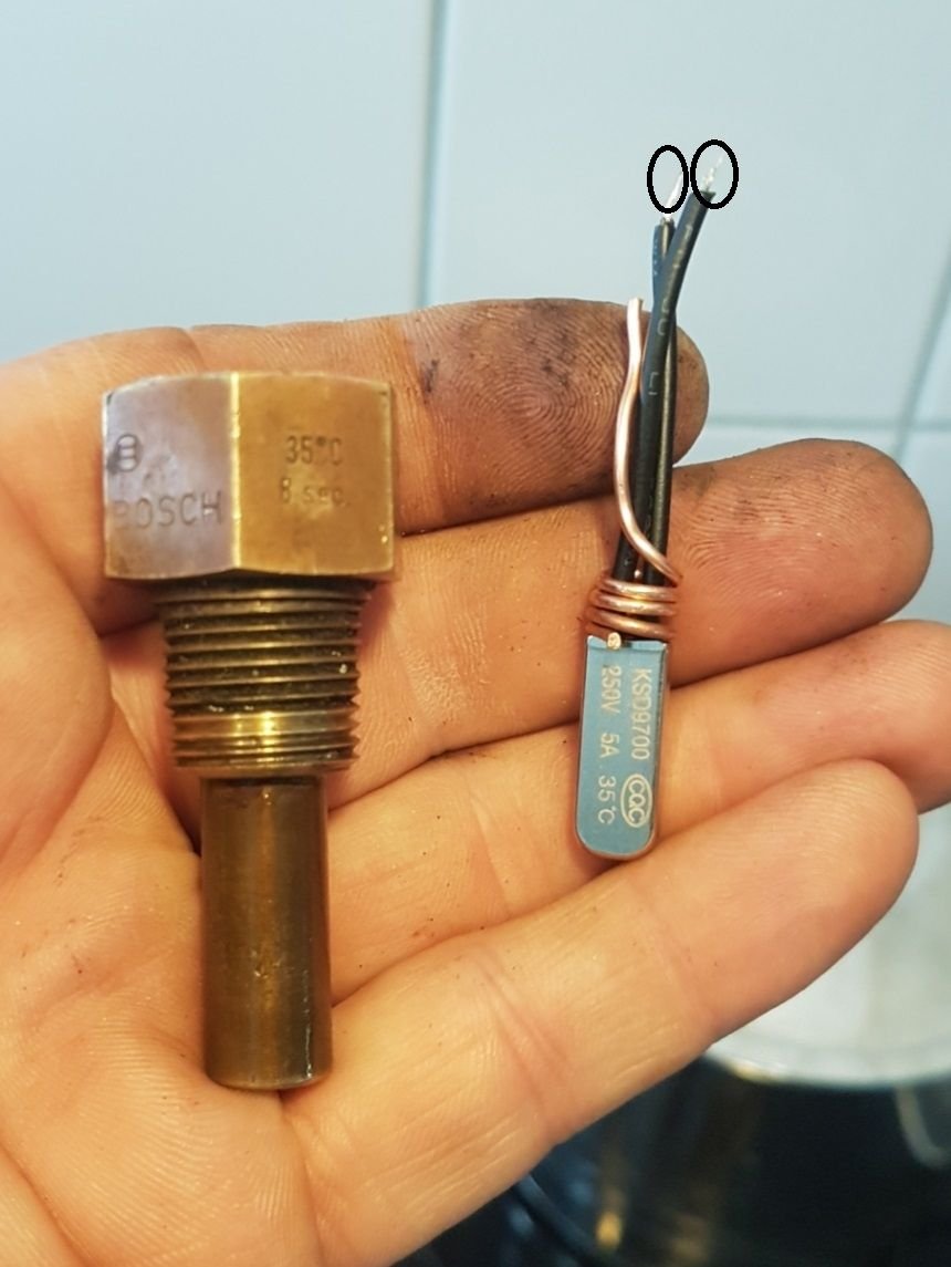

My solution to the code, replace the TCS (Temperature Control Switch). I could not find the piece at an affordable price, so I modified the old one....

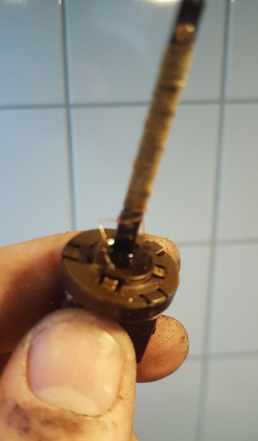

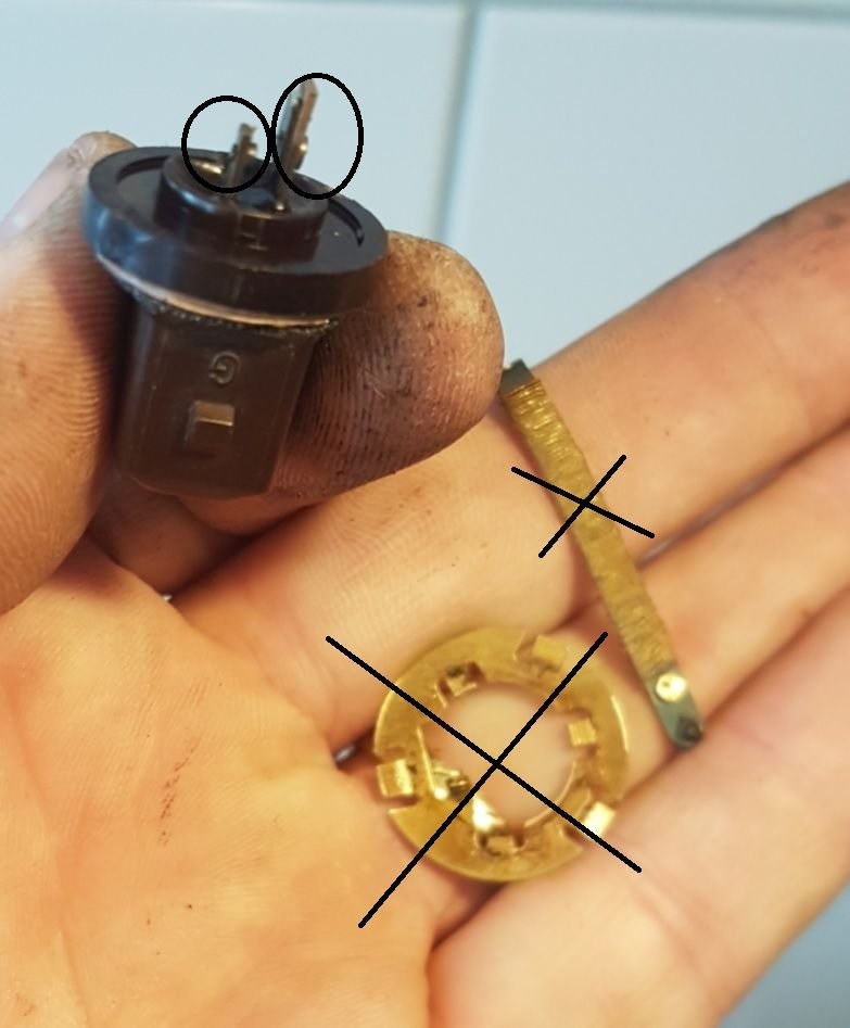

I disassembled the switch by "filing" off the the crown, the retaining ring that holds the connector in place on the switch. Removed the original parts to make room for a thermo sensor.
The circuit is closed when cold, and opens at 35 C'.

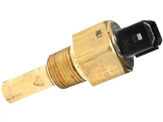

1985-1989 Chevrolet Corvette Cold Start Valve Temperature Switch Standard Motor Products EGT4 85-89 1988 1986 Part Number: 3218-07113890

the old "guts" of the switch.
Where to solder, and what to remove.
Parts for the install.

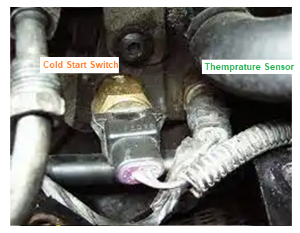

Location: At the front of the plenum, to the right of the temperature sensor, oval connector. The TCS connector is "square".
