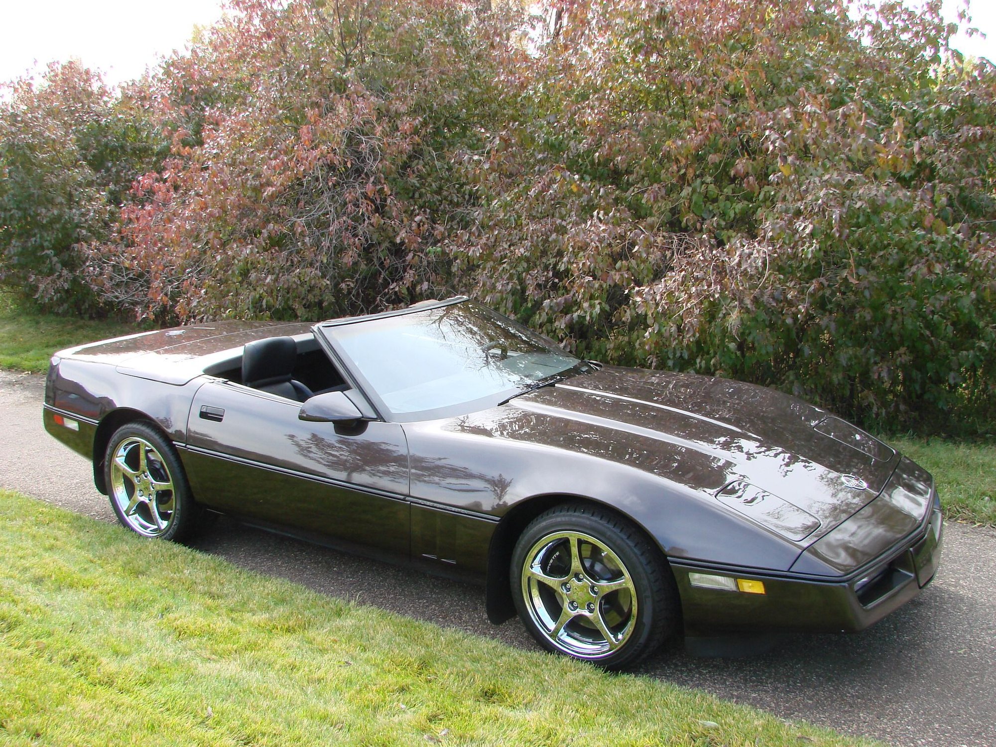

Old Jul 9, 2022 | 09:59 AM
FLA_Instigator's Avatar
FLA_Instigator
Cruising
Joined: Mar 2021
Posts: 11
From: Central Florida
Originally Posted by FLA_Instigator
Any issues bolting on these c5 wheels to an 84?
TIA
Done, used 28mm spacers front and back, fills tubs just right! Thanks for the response to the OP.

From: Lino Lakes MN
those look to be poking out beyond the fender line

I have them installed on my wife's '89 with no spacer and they fit fairly flush
nope, actually still got 1/4in before flush.
