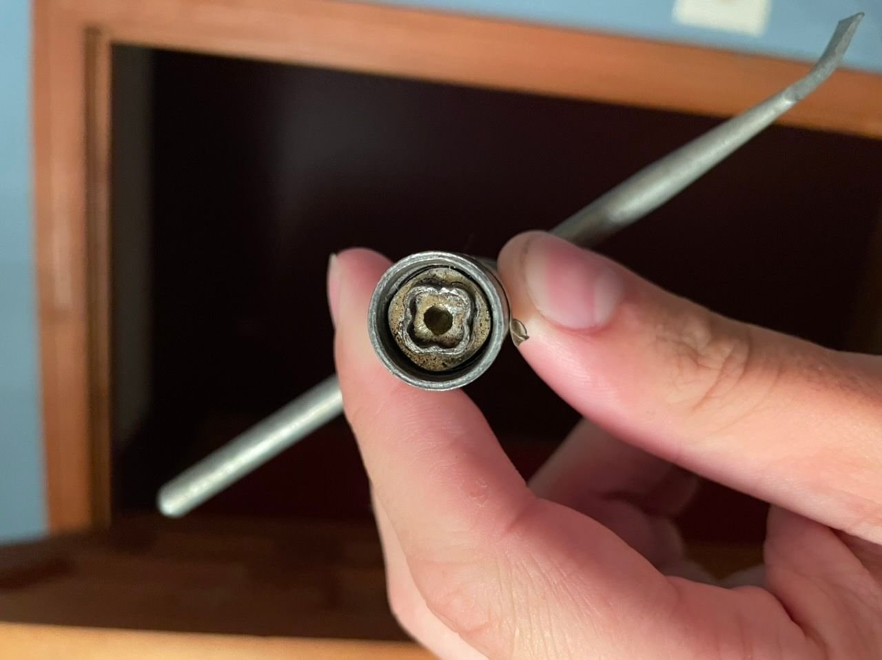

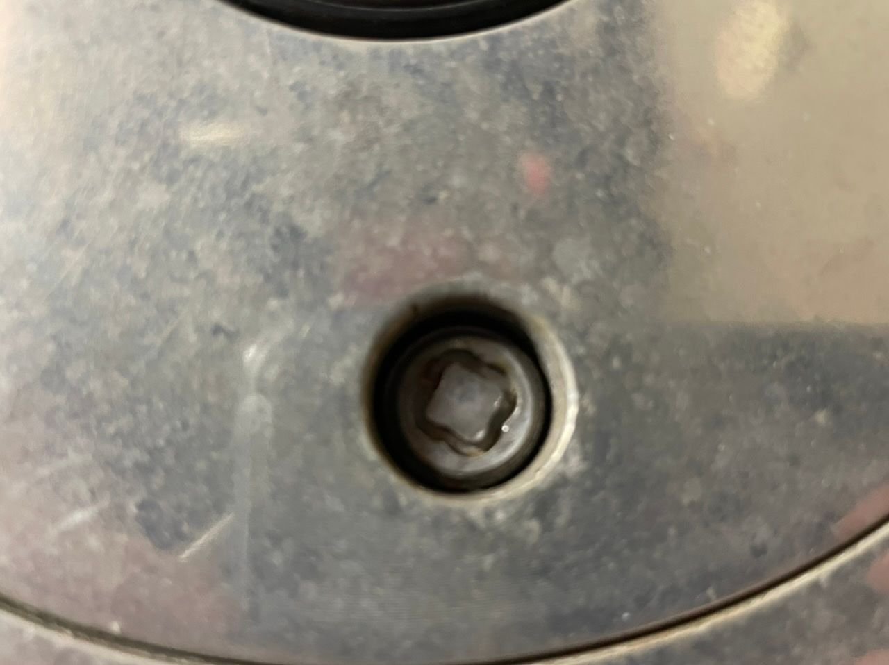

Well I went to take the wheel off to get better access through the side, and I couldn’t get it off, this decided to strip on me too while I was trying to get the center cap off. The tool is bad, anyone know where I can find a replacement? I tried looking everywhere online. I might have to look at the for sale section on here for one.

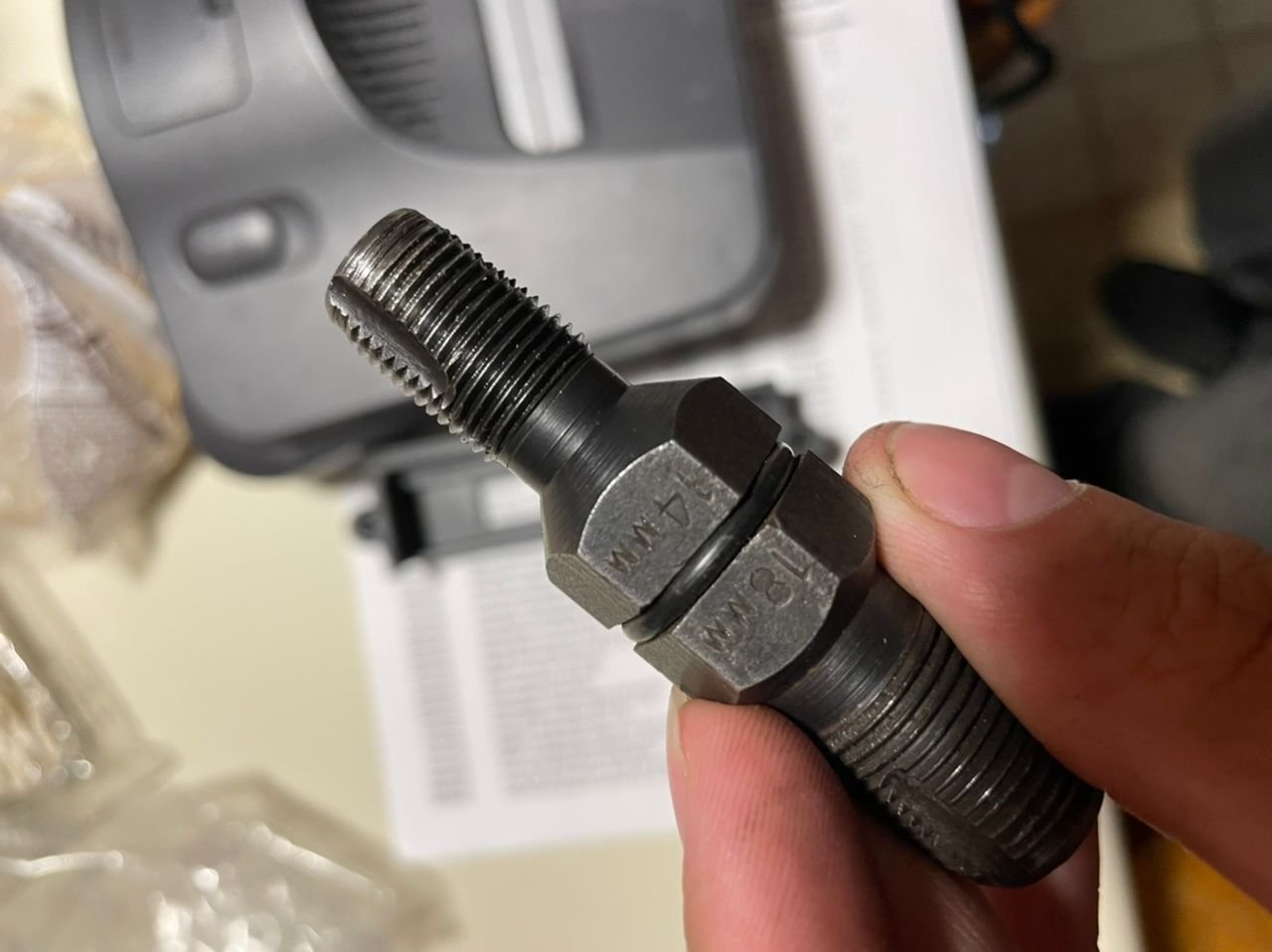

SUCCESS! I talked to a mechanic friend, he said the tap going from outside in will be fine, it’ll grab onto the old threads. And he was right. I got the spark plug in. Seems to be ok! I used this tool right here, he gave me it to use.
