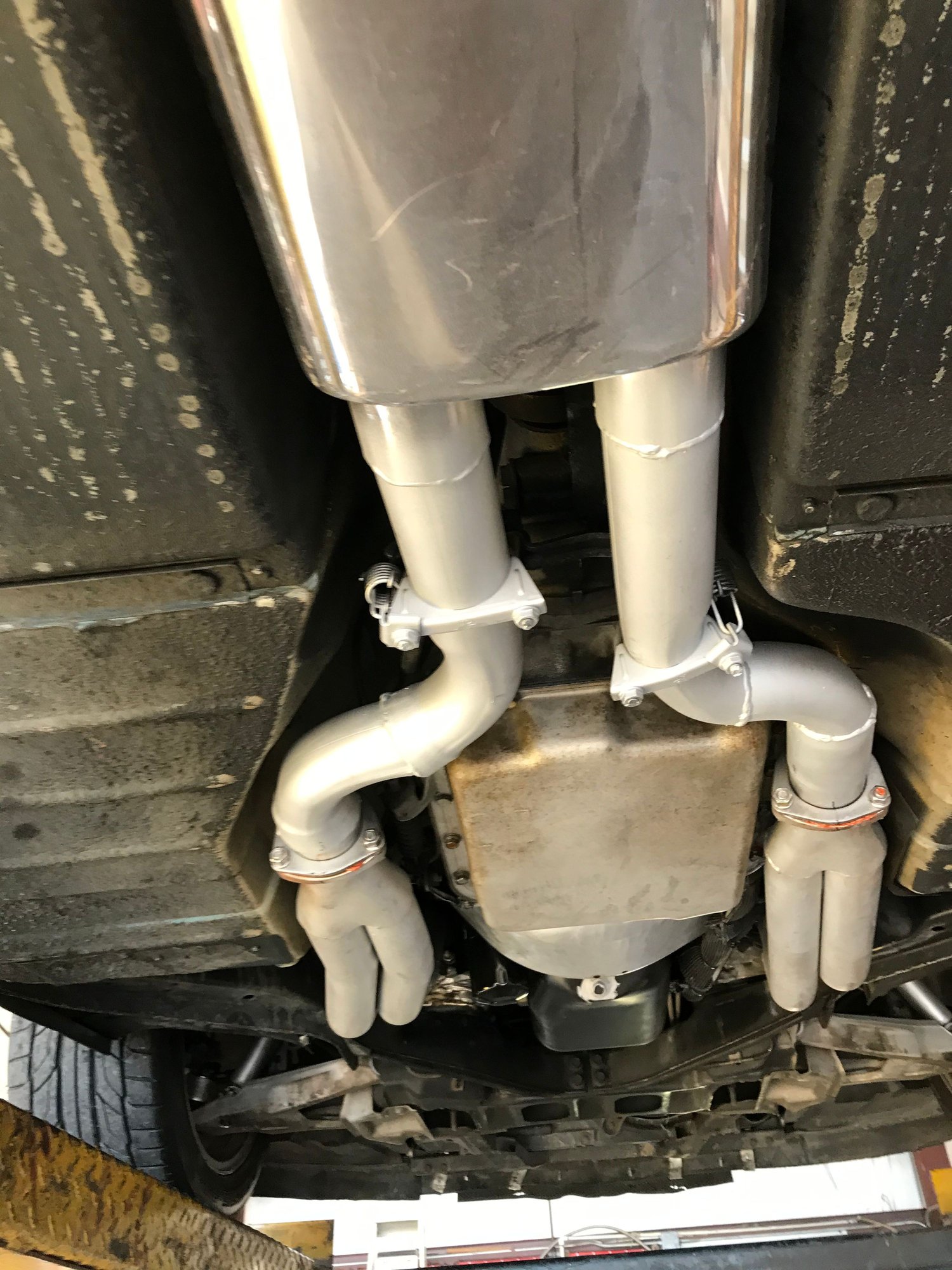

Default No drone built in X-pipe works
This one has NO cats but the (from JEGS bult in X-pipe resonator) stops the drone .. Even with no cat not louid ..
