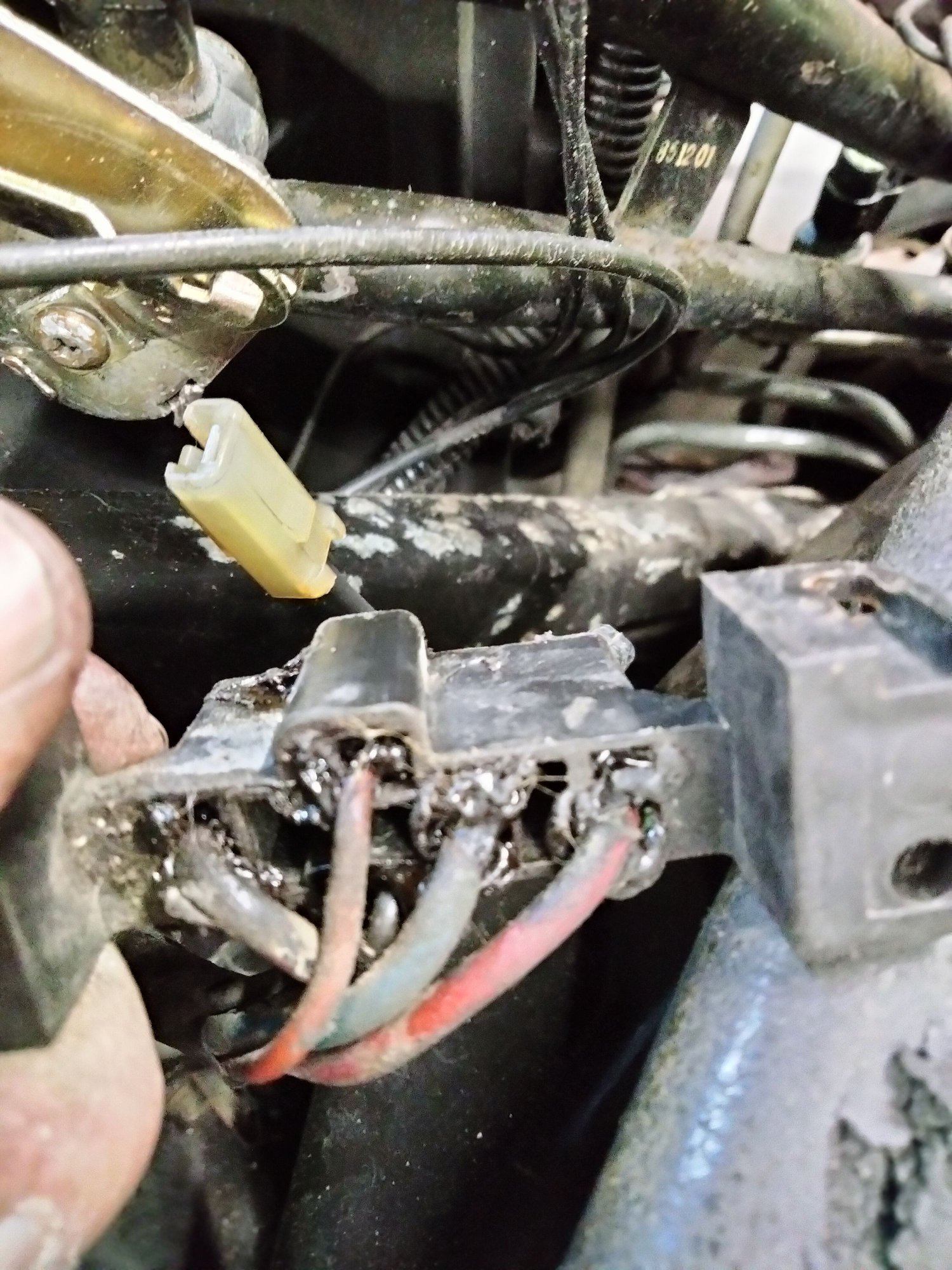

Thanks for all the responses. I am assuming the pressure switch is the port on the high pressure line about even with the middle of the motor. If that is the pressure switch I may see the problem. That switch is unplugged and the connector looks like it has been jumped together. I will do some reading. Now for the newest problem. Nothing is easy. I pulled the blower motor to replace it and the high blower relay wiring is toast. The relay has obviously gotten hot but the female 5 terminal connector has really gotten hot. I haven't check it with a ohm meter but I think it needs replaced. Any good source for the connector that I can then splice it. Nothing is ever easy.
I believe that's a very unusual connector if still original. The connector attaches to the blower housing and the relay plugs in? GM/Packard original I believe would have been #12010179. There's very likely connectors that you could use but they would have no retention options to the blower housing. A GM# 12102684/ACD PT351 (obsolete also) or equivalent would do the correct terminal. The terminals are very straight forward Packard 56 Female and should be a local buy.

4 Seasons shows a GM style connector but you are correct it doesn't have the mounting points. I may have to do without the mounting points. It really can't go anywhere down there. I am worried as one review showed the working a bite lighter gauge. As bad as the connector itself was burned/melted I don't know if that might be a good thing. The other issue is the high pressure switch. I am still working on that connector.
What wire colors and which circuit numbers for the switch connector? Do you have the FSM?
** A GM# 12085503/ACD PT124 (still available) or equivalent should do the switch you mention. I assume you're talking about the gray (likely) on the AC line? The switch is GM# 14078970 or an equivalent.

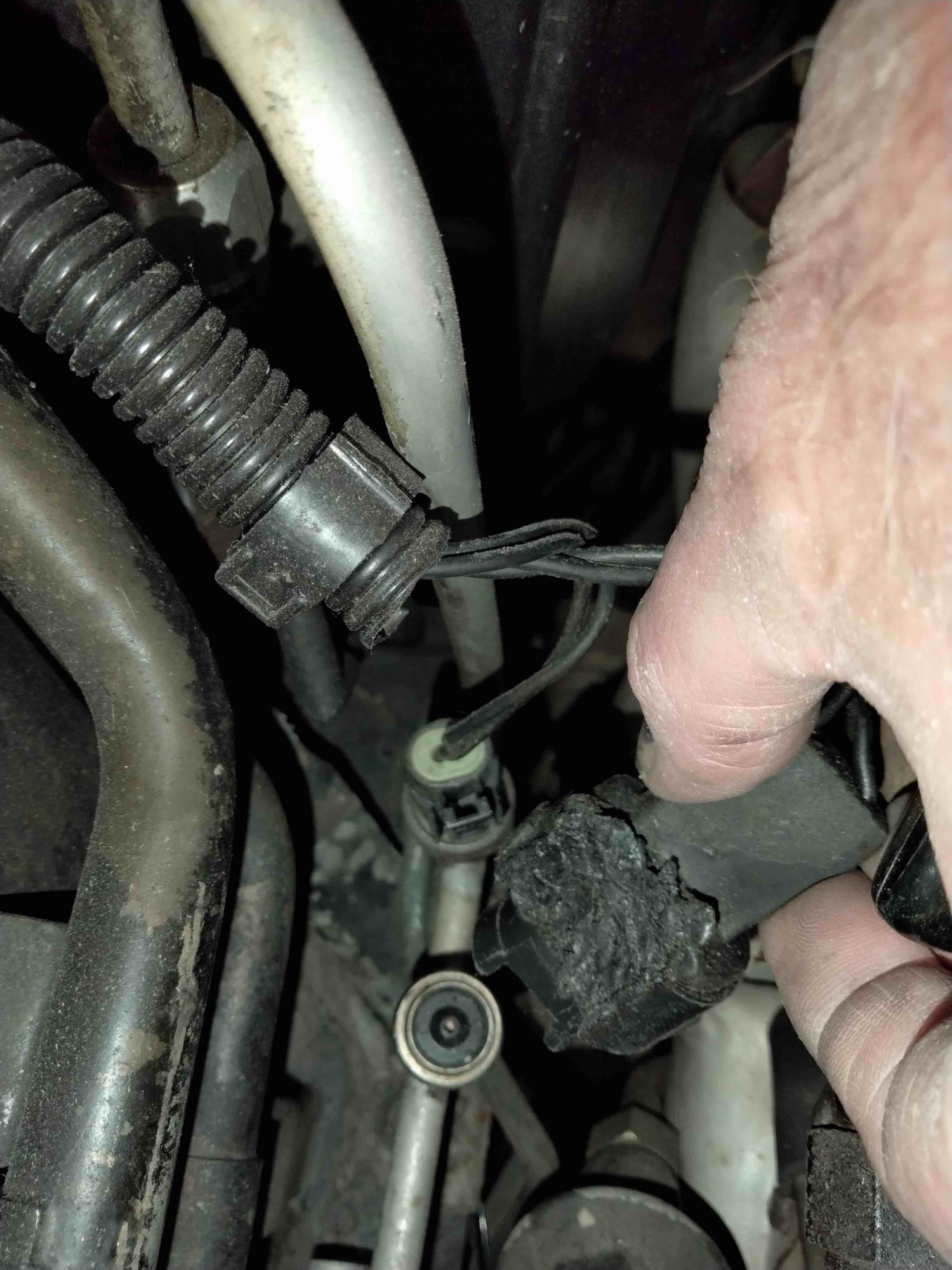

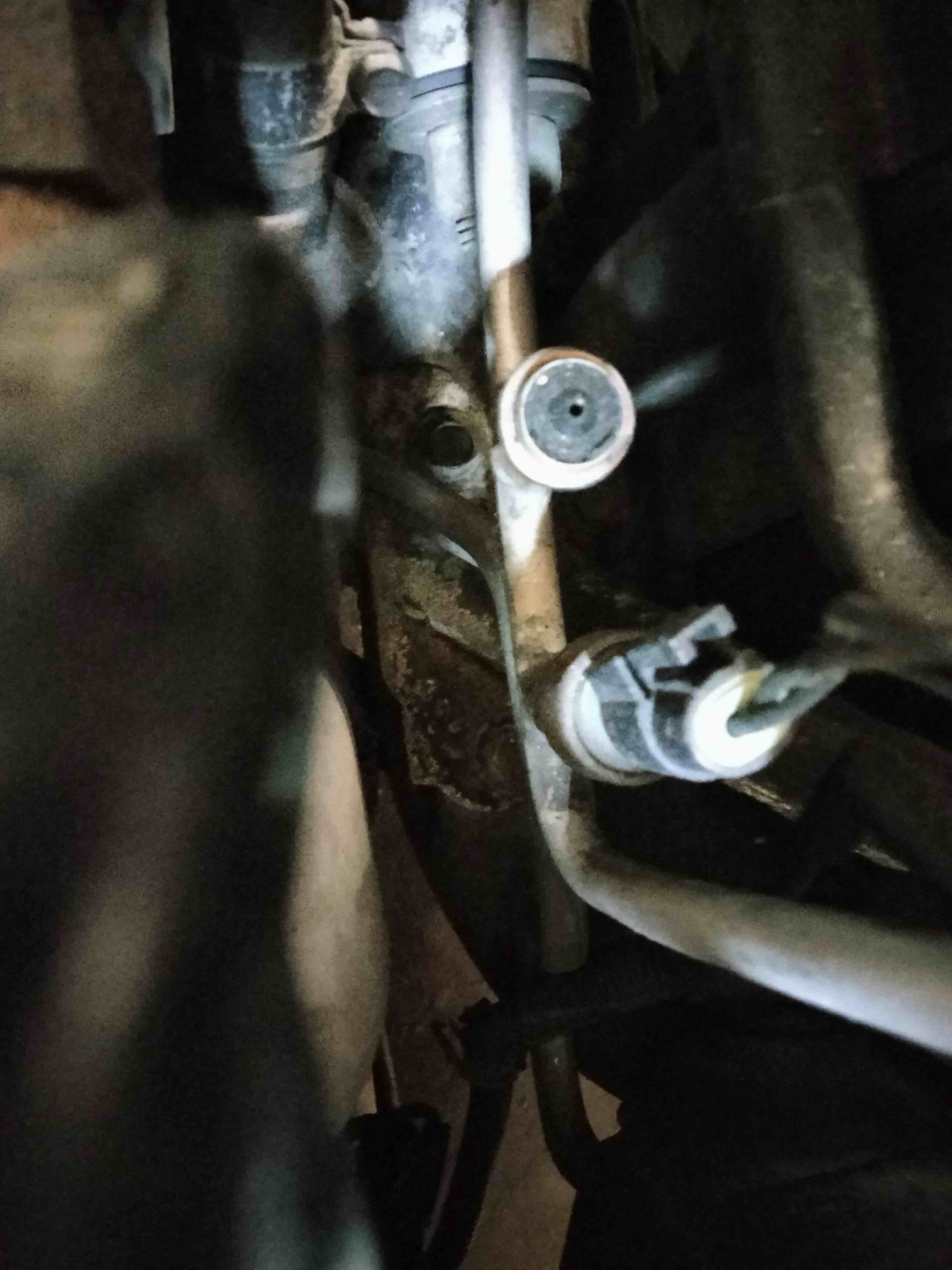

I have found the wiring connector and the relay and have both on order. The switch on the right in the picture is I believe the high pressure cut out. Everything seems to work with the broken switch plugged into the damaged connector. That is the way I found it so I am not sure what happened. If you know for sure that is the right switch let me know and I will get one ordered. The old blower motor seems to run just fine so no sure if I should replace as a preventative maintenance or leave alone. Thanks Bob

The switch you've got in your snapshot and busted is I believe a GM# 10007057 and a GM connector would be # 12101901 or an equivalent.

Well I found part of my problem. Low pressure in the system. I added about a pound of 134 and the compressor clutch is engaged about 50 percent of the time then the pressure drops and it kicks out. I didn't have my high pressure gauge set so I didn't want to add any more. I added some leak detection but a quick review didn't show anything. I ordered what I think it s the one switch that is broken so I will change it out tomorrow and I have a new pressure cycling switch so I will install that. I installed a new compressor last year and accumulator. The technician said he thought the hoses looked good so we didn't opt to replace those. I will see after some updates what is happening. I have also replaced the blower motor and the high fan relay with new wiring connector so that part is good and I can hear the various fan speeds so that is good.
