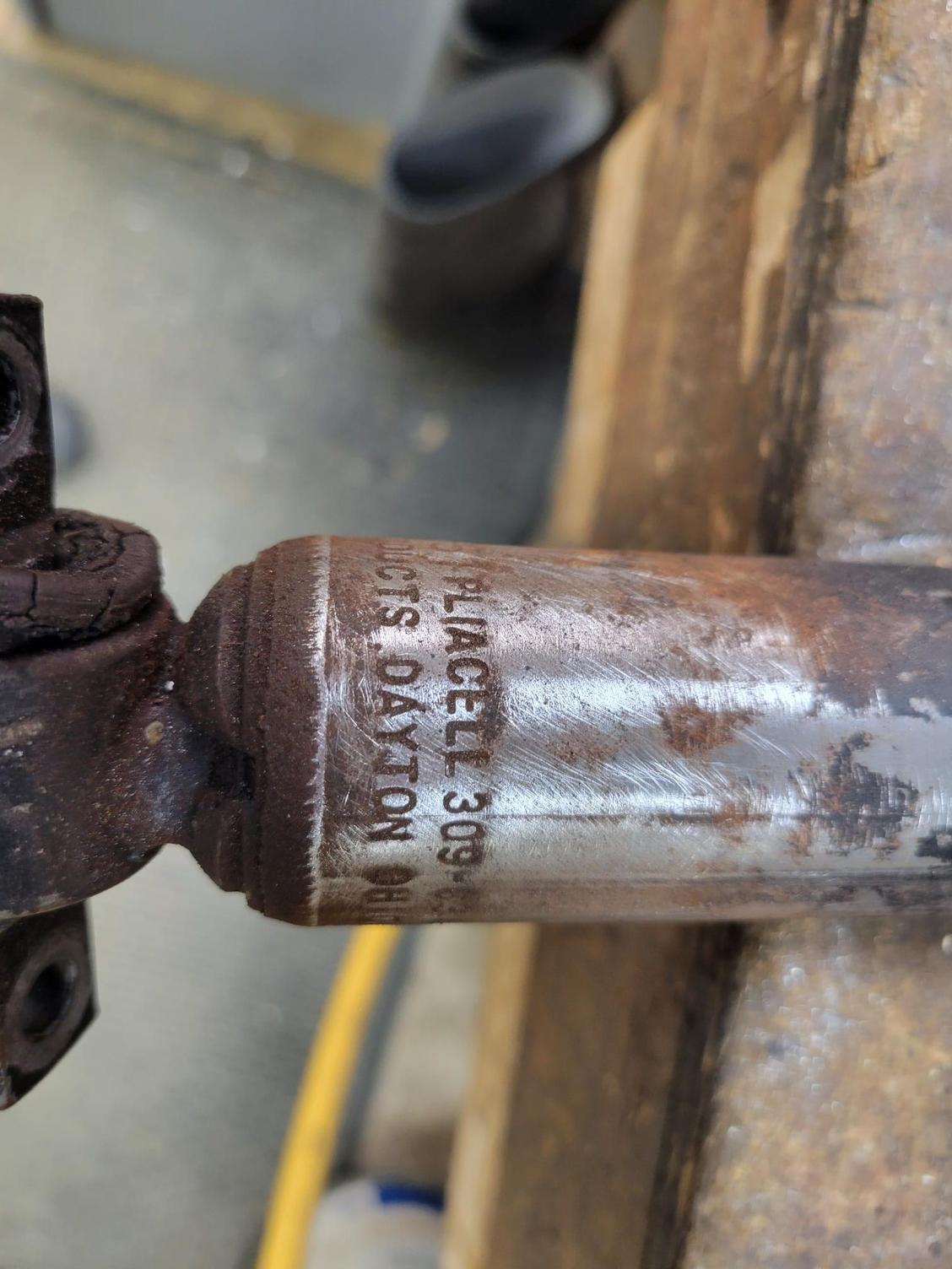

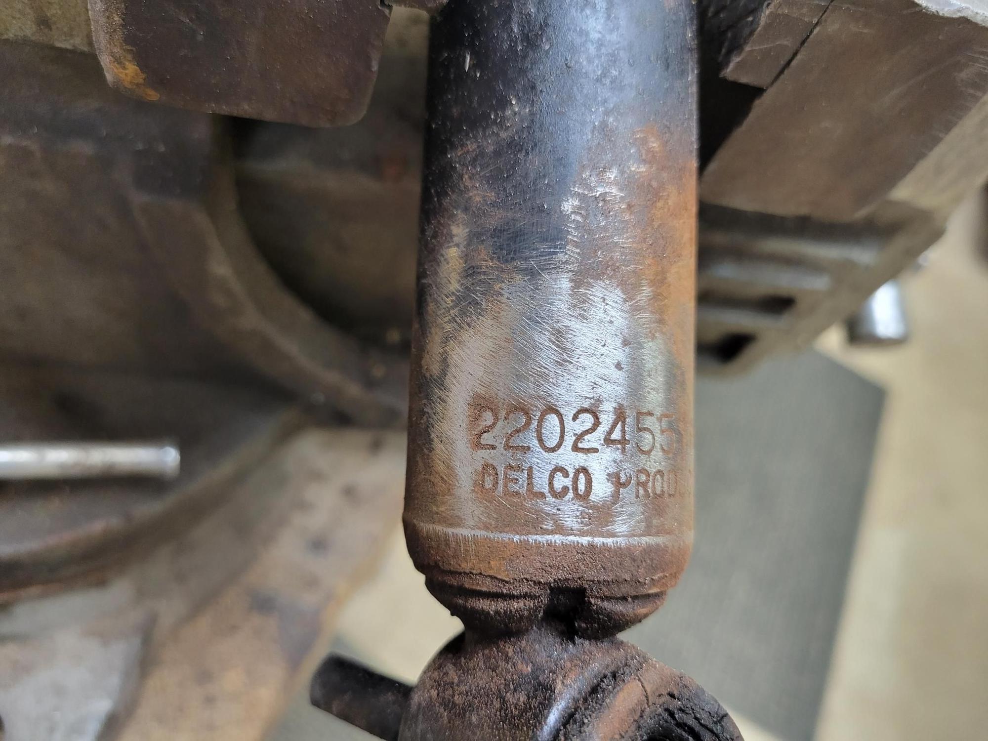

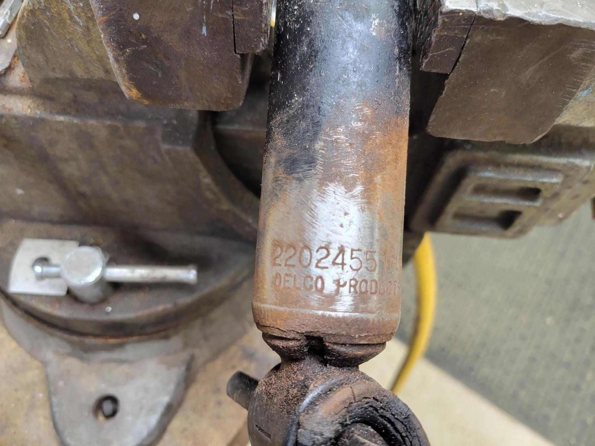

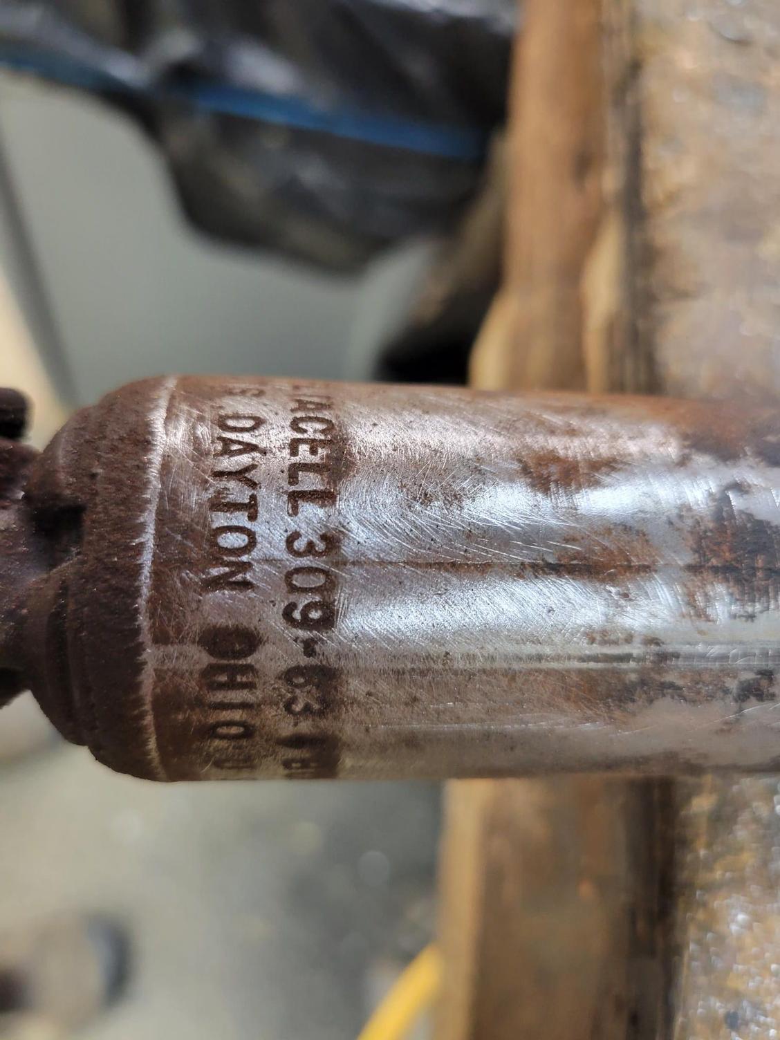

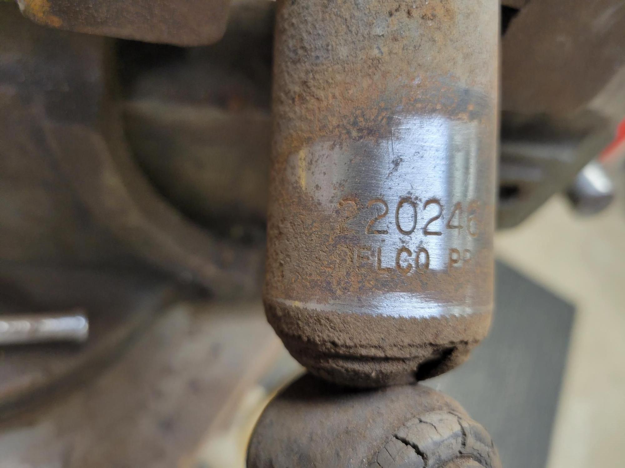

To all
Front Part Shock Number 22024551 Plaicell 309-83
Rear Part Shock Number 22024643 Plaicell
Both stamped Dayton Ohio
Photos attached
Front
Front
Rear
Rear

Thanks Ark! Great pics. I crawled around under the car last night and got a look at mine. It looks like mine are the Ac Delco ones that Ecklers sells as the numbers on the shocks match those. The ones you are showing here i believe are the factory ones that came with the car. Unfortunately i can only assume these are no longer available
