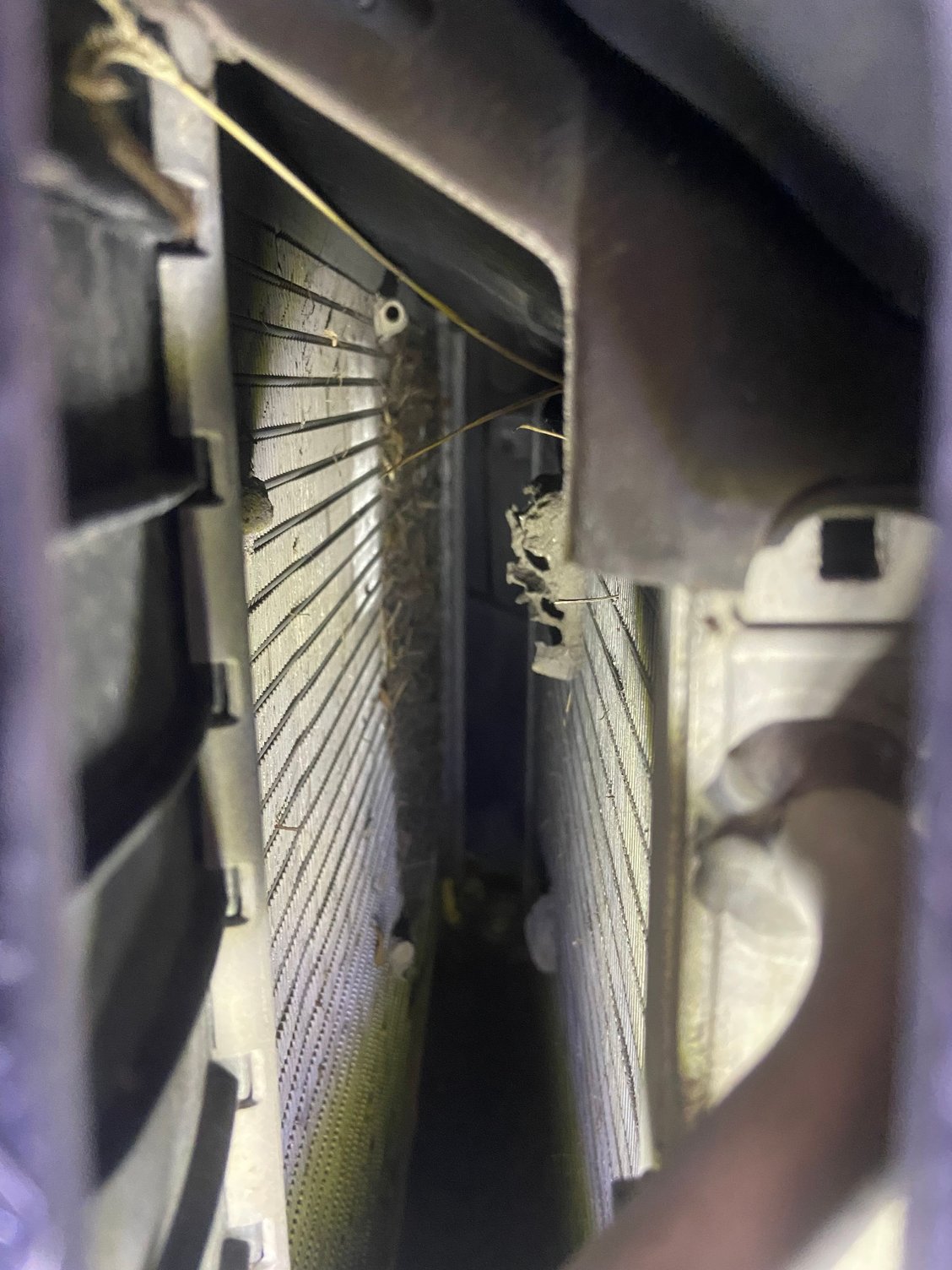

cv67's Avatar
cv67
Posts: 81,241
Likes: 3,063
From: altered state
St. Jude Donor '05

Originally Posted by rtp3
Thanks Will rake a look.
you can't see the caked in debris unless it's out
http://invite.homestead.com/Radiator_2.JPG

What year was that out of. On my 94 you can view the space between the rad and condenser.
you cant see if its plugged up looking between.
