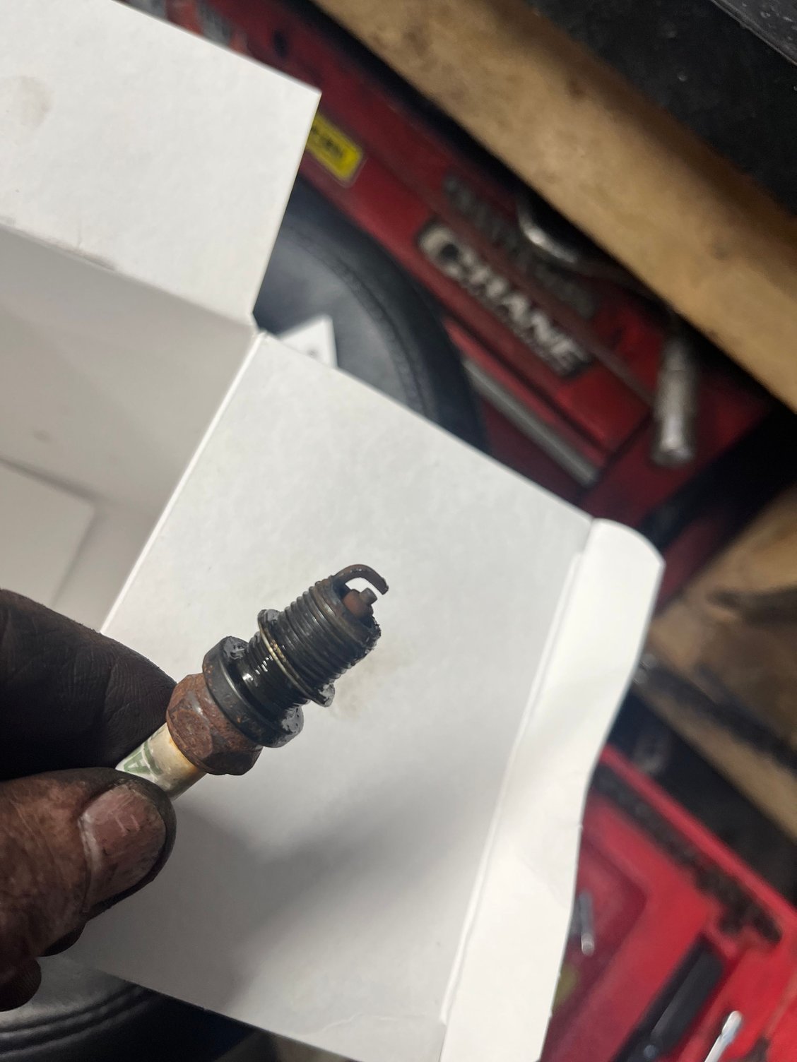

new to me 89 carvette. i partook in some maintenance stuff last weekend, myself. i noticed that the #2 spark plug hadn't been changed in what appeared to be a very long time. the other 7 only looked to be about 10 years old...
believe it or not, the car ran perfectly fine.

Hi, well car running great still is a good thing! Maybe that one could just be worn out, or just defective with age, especially if your car still idles good, easy to start, etc. I’m guessing you are replacing all 8 ? I would also replace the plug wires if you can, while you’re there, as well. 10 years is long time.
The plugs on mine, are original, as are the wires. I have 34k original miles. So Im sure they’ve never been replaced…yet the engine starts immediately, idles smoothly and is a strong runner on highway, and quick off the start. I still need to make that an item to do for another project, but will wait until either Optispark or water pump need replacing…or both. Those are another project. 🤪😆

yes, i replaced all 8 spark plugs. i have a set of wires here for the car but honestly the ones on it are still in great shape. the car has been inside most, if not all of its life minus the past year, they were still crisp to snap on and pliable with no damage.
