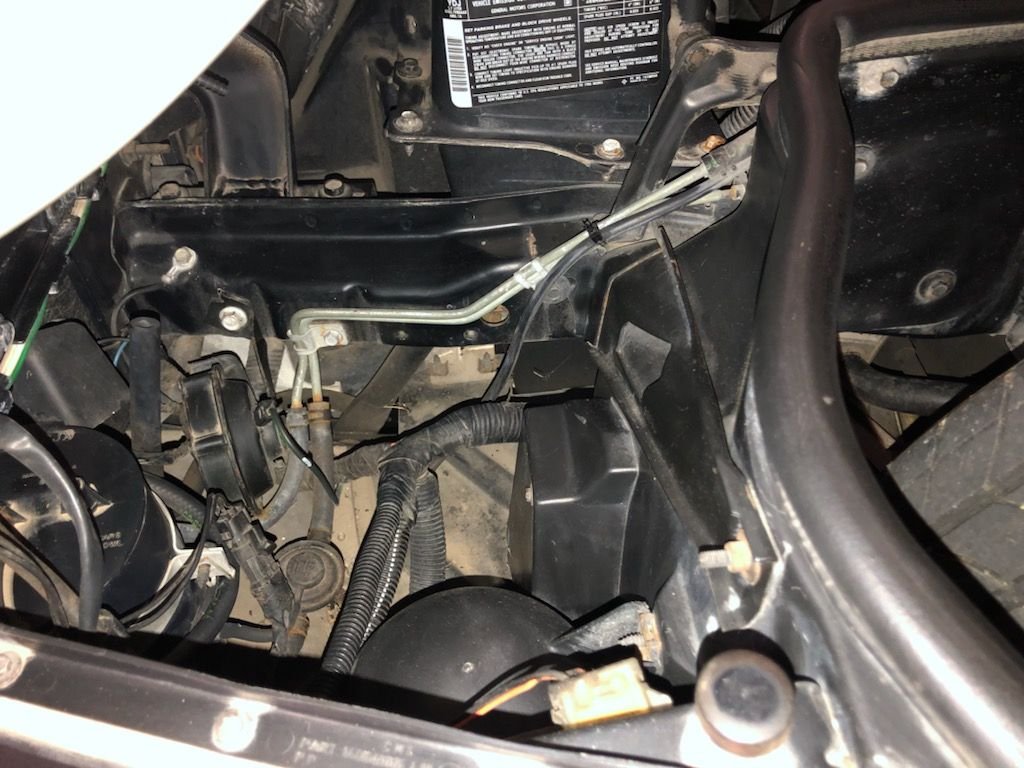

Since functionality is only being hampered when it's fully closed, I agree that it sounds like something in the well could have worked its way loose and is getting in the way. Here's some shots from our '86 that works with no issues for reference, in case it helps!
