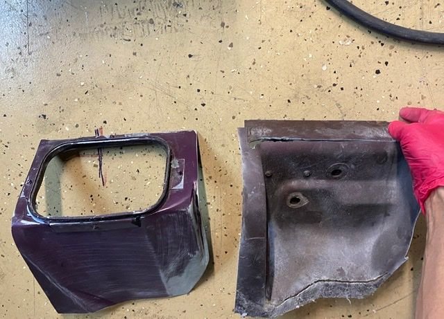

Here are pictures of how I made the ZF Swap myself. I didn't want to use a sheet metal, I wanted to make it as original as possible.
From post 27
https://www.corvetteforum.com/forums...ne-mods-2.html

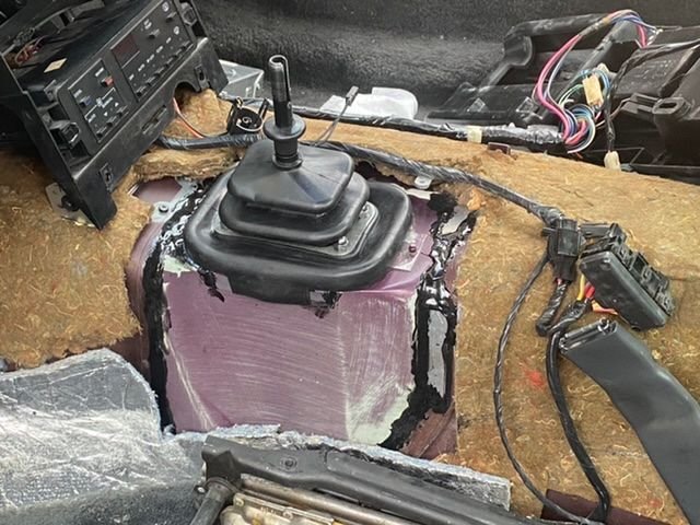

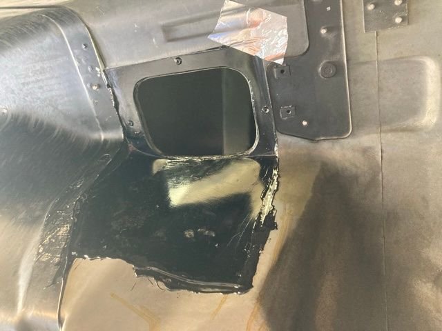

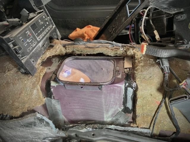

Dug up some pictures of the project, used JB Weld Plastic Weld (black material) and a donor ZF Trans tunnel.
pro. nice work and thnx for posting pics
what shift boot is that?
How did you figure out the location for the ZF tunnel piece? I only ask because I will be starting the ZF swap (for the old 4+3) in my 85 in a couple if weeks.
