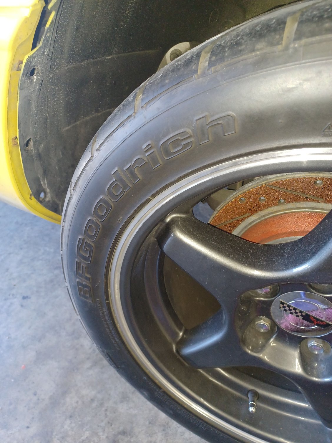

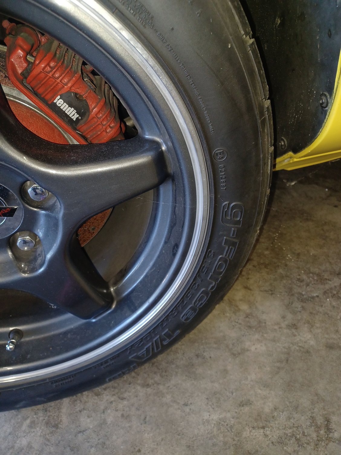

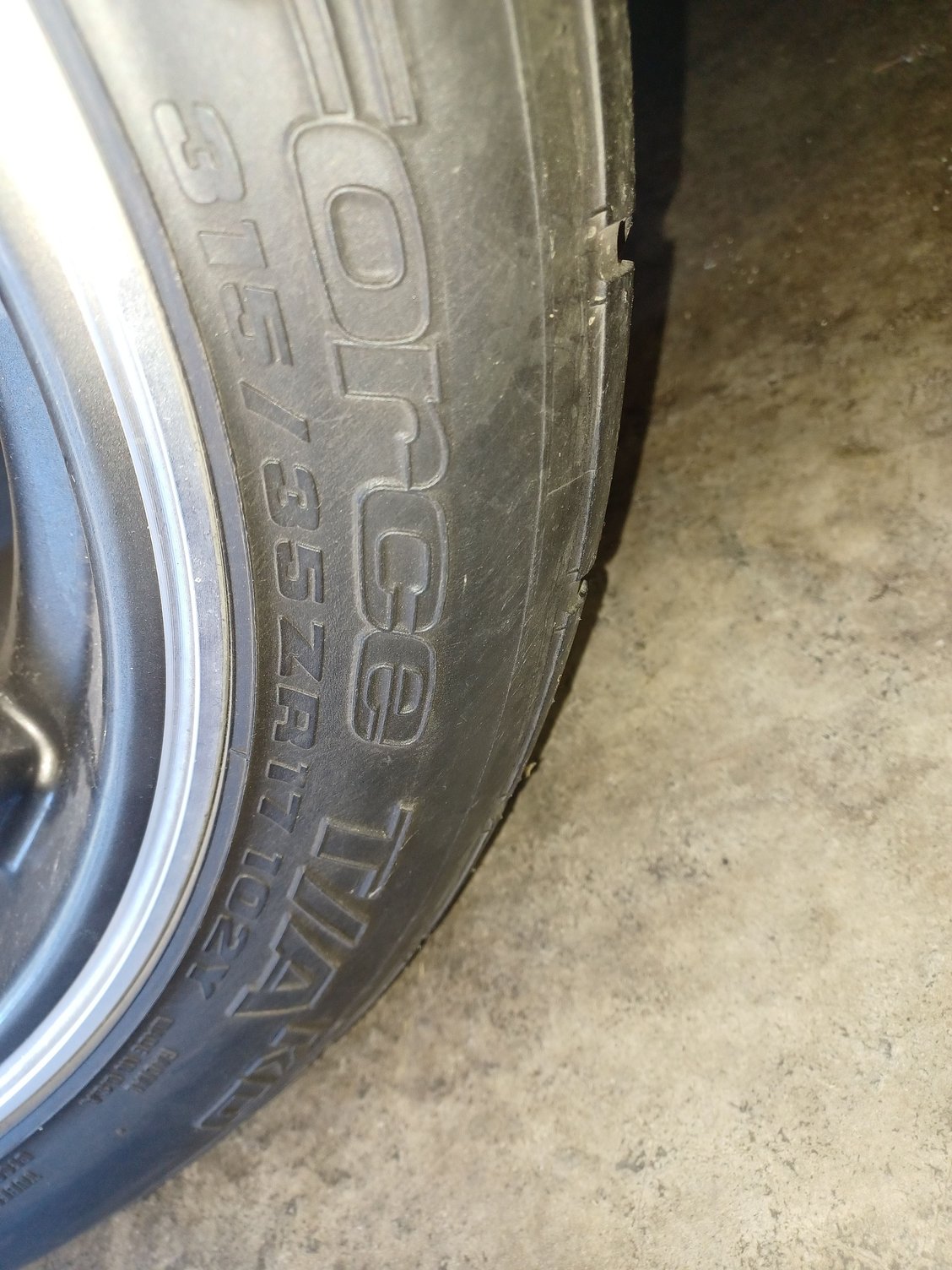

Help with finding tires fir my 95 the previous owner had this set on it but tge rears and fronts are way different but all BF Goodrich. The rears are wider than the fronts and was told Goodrich doesn't carry that size anymore so now I have new Goodrich up front and will have to buy some replacement tires for tge rear, but all in that size are deemed race tires like Hoosier, Mickey,Thompson or Nitto. Ant one recommend a good street tire that will get good traction but not too soft, need good cornering too. I think the rims are off a c5 but not sure if any one knows that would be great.the tire size is in the pics.

We'll need to know your wheel sizes to be sure of proper sizes and give good reccomendations. I'm guessing you have 1996 Grand Sport wheels (or replicas?) that are 17x9.5 et56 front and 17x11 et50 in back? If so, then you need 275/40/17 tires for the front and 315/35/17 tires in back (the latter is what you show in the pics, which is why I'm guessing those are the wheels you have). For those sizes, my recommendations are: 1) the Michelin Pilot Sport All Season 4 if you need to drive this car in very cold weather (much below 32F a lot, or ice/snow), or 2) the Mickey Thompson Street Comp if you won't drive it serious winter weather (Summit seems to keep them in stock). These particular M/Ts are true street tires, not race/drag tires. I would stay away from Nitto street tires (they have two in these sizes) and Toyo Extensas, as they aren't very good tires.

Yes those are my wheel sizes and thanks for the info.

BTW, what's going on with your brake rotors? Is that rust or some crazy coating?
I can't see a date code on those tires, but don't think they've made those in a 315/35/17 for quite some time, so I'm assuming they're pretty old. In which case, any of the listed tires will be a significant upgrade in grip. For the cost and availability, I think you'd be hard to beat the MT's Matt mentioned. And if that's not enough grip you might need a lower tread wear tire, but that's not going to last well on the street or like rain/winter.

The brakes are just coated calipers and little condensation rust on the rotors, cars been sitting for months. Tires are old that's why I'm replacing them, only good for doing burnouts now. Thanks for the replies.
