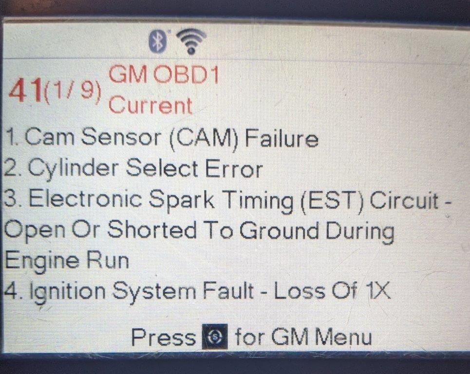

If car still does not run well and you think it's the ECM, I have an extra one from my 89 Corvette automatic. My original ECM problem was that it was not reading the coolant temp sensor. It would set off my check engine light with the code for high reading temp sensor (I think code 14). The ECM must have been reading the temp always as 232 degrees or higher because the cooling fan was constantly on even when first started and it gave me a hard start when first started in the morning. Would take about 5-7 times for car to start when cold. Once car started, engine ran perfect. I put the used ECM I bought from local Corvette specialist and now cooling fan turns on at 232 and fires off first try on first start of the day. Before you buy a used or new ECM, I will let you borrow my original one if you want. It even has the Prom. I put my original Prom in the replacement ECM because the replacement Prom was from a manual transmission. The upshift light would come on once in a while.
Old Oct 20, 2022 | 05:09 PM
pete315's Avatar
pete315
Joined: Jun 2022
Posts: 194
Likes: 47
If it’s running that poorly, you would hope it sets off a code on computer. I would go to an Auto Zone and get a free loaner fuel pressure tester and see what you got. Did you trying spraying carb cleaner to check for vacuum leaks. Don’t give up.
Old Oct 20, 2022 | 05:16 PM
pete315's Avatar
pete315
Joined: Jun 2022
Posts: 194
Likes: 47

Set the distributor to the base timing in the book. If you pulled any spark plug wires off of the distributor or plugs double and triple check they go to the right places.
Check every vacuum line, both ends, to see if they are connected right and not cracked. Check every connector in the wire harness to see if it is fully seated. Make sure the coolant temp sensor wire is connected.
Pull a spark plug and see if it looks wet. If it does do a clear flood procedure. That's turn the key to run. Press accelerator pedal all the way to the floor and hold it there. Crank it over until it pops and wheezes and clears out the extra gas. Stop cranking, take foot off the pedal and start as normal.
Basics first. You know the engine does run.
If you get codes please list them here first. Sometimes you get codes because the engine is running poorly not because they are the cause.
