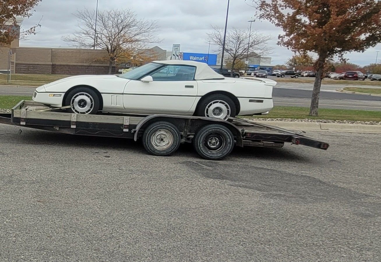

New to the C4 forum. I've been out of the Vette game for a year. I previously owned a 2009 base with an automatic and left it stock. I just acquired a 1987 convertible with a 4+3 with about 125,000 miles. The interior and exterior are in what I consider pretty decent shape for a 35-year-old car (not perfect, but nice), but I bought it with what is at least a blown head gasket. The combustion gas is pressurizing the cooling system so the top end needs to come apart. With that comes options. I might as well yank the motor that is in there and freshen it up. If I yank the motor out to freshen it up I might as well do a camshaft too. I don't think I want to go crazy and build a 383, but maybe a 355. The problem is that even though I love the look of the TPI system it is just too much of a limitation on making power in the upper RPM range. Tuning an OBD1 is something I've never done. I know the chips come out and you need to burn them each time.
So, maybe I just go and LS swap it. I have an lq4 I could pick up for about $800, with no accessories, and about 160k miles. If I get that it would be at least a cam upgrade I do with it too. I know the LS will bolt up to the 4+3 with a couple of small mods. It should bolt in the car with some motor mount adapters. I see some people have had to notch the k-member and others mention nothing about that. That's something I could do if needed. I've done some minor LS tuning so I think this is also something I could handle. I already have LS headers sitting around at home doing nothing. I would keep the L98 and maybe use it for a truck later if I go this route.
My ultimate goal is to have power similar to my old C6. Somewhere between 400-450hp at the crank (~300-350rwhp). What is your opinion on what should be done? A L98 with almost 400hp and 500ft-lbs of torque would be a blast, so would a 6.0 LS. I'm looking for pros and cons. My budget for this isn't unlimited, but I could do $2-3k (maybe more, but less expensive is always better). The 4+3 is staying with the car. I believe the T10 is a good enough trans for what I'm doing and the OD part of it will be fine if I don't use it under full power. I've always thought it was a decent trans that got a bad rap. The LQ4 and a cam will reach my goals easily. What would the L98 take to do that?
Or just do the head gaskets and leave it stock?
