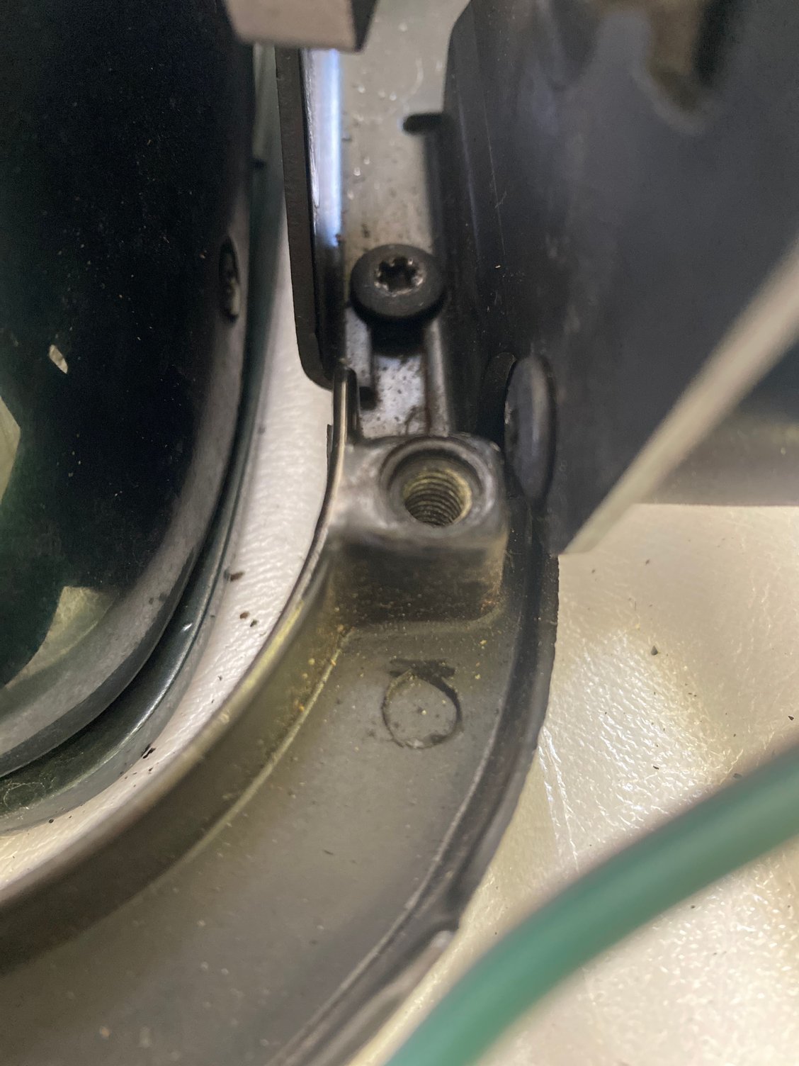

Hi, sorry this is sort of urgent but I am in the process of fixing my headlight and one of the torque nuts is stuck and won’t budge. Any suggestions?

blast it a couple times with penetrating oil and let it sit over night.

Impact driver might help as well.

If that's not plastic around it, HEAT it. Heat works NOW....not over night, but as soon as you get it HOT.
