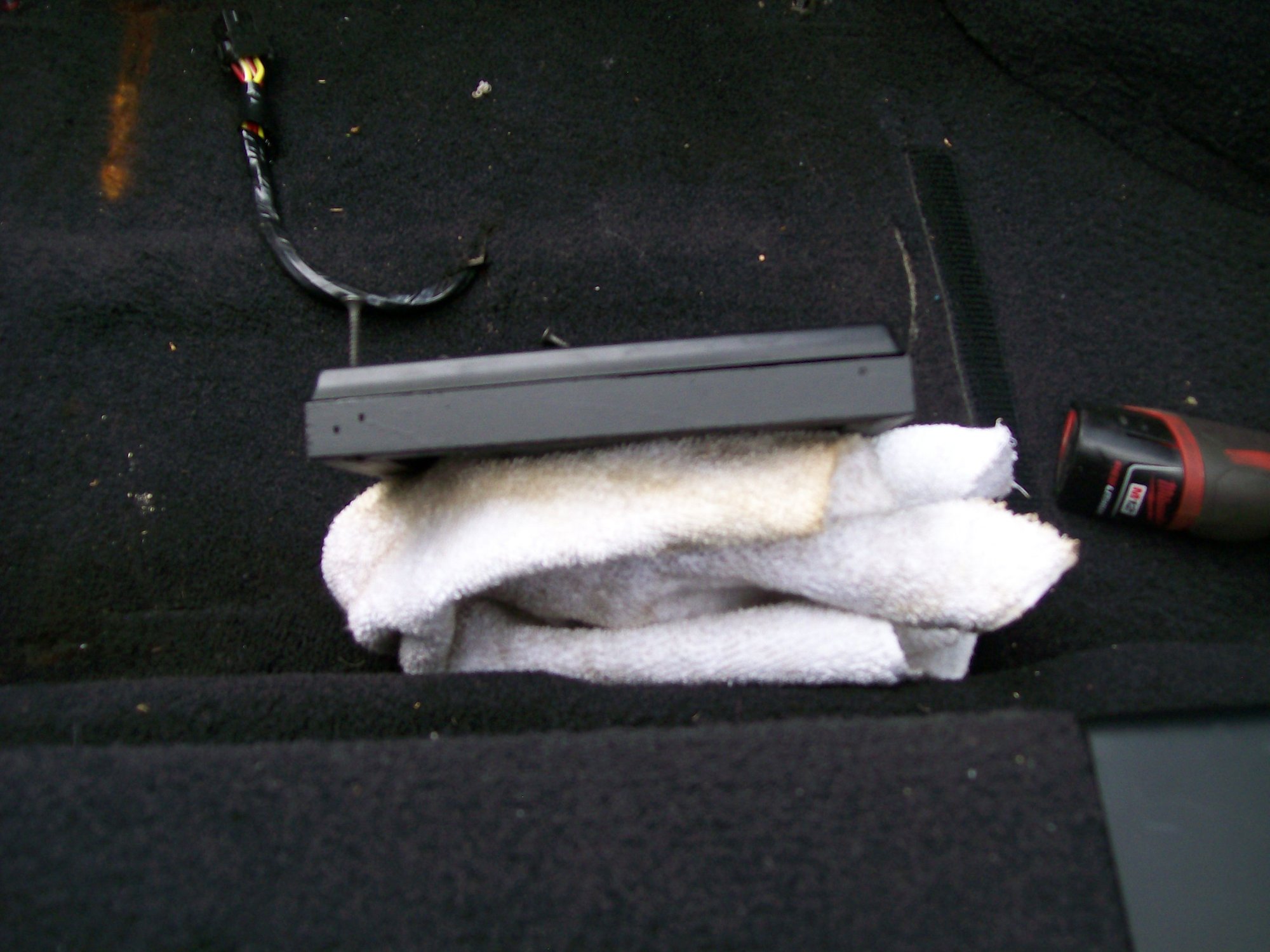

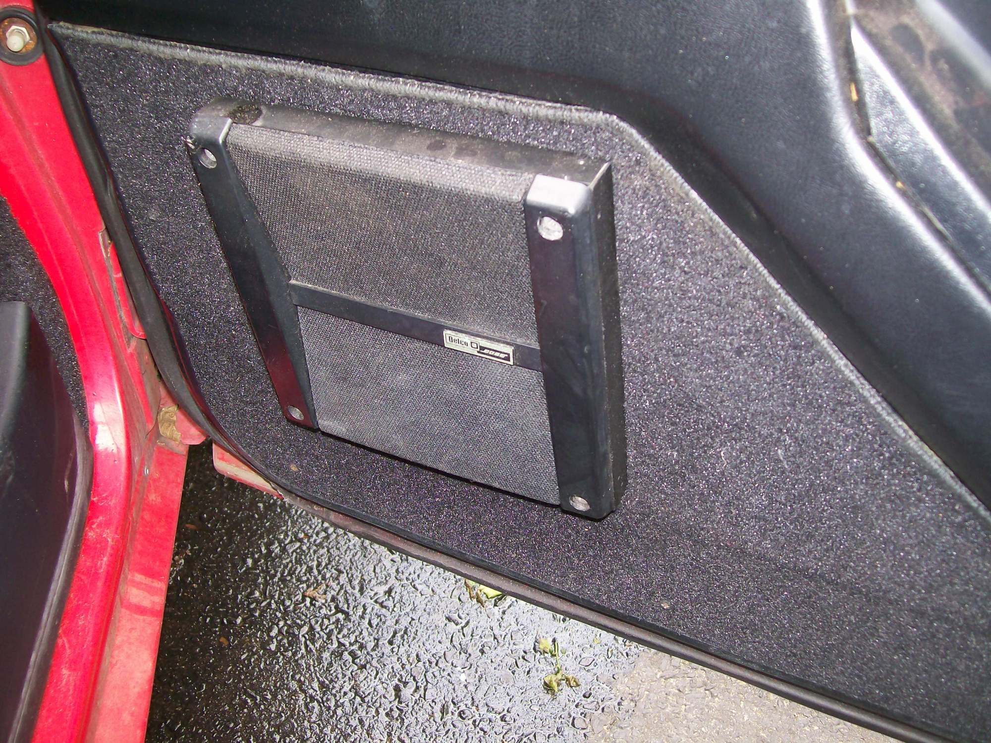

Sounds like the amps in the speakers are toast. Very common problem with them. They are repairable. Search on here and you'll get some ideas as to cost and also a way to repair them yourself if you are handy with electronics.

I replaced everything in my 89 convertible, but I went with a period correct aftermarket radio.
6"x9" speakers were a drop in replacement for the rears (if you have a coupe I am not sure), but the front door speakers required a little modification.
6 1/2" speakers fit if you slightly trim the opening in the door.
You will have to make a spacer for the stock grills depending on the depth of the tweeters.
I would recommend running new speaker wire from the radio to the speakers as well.

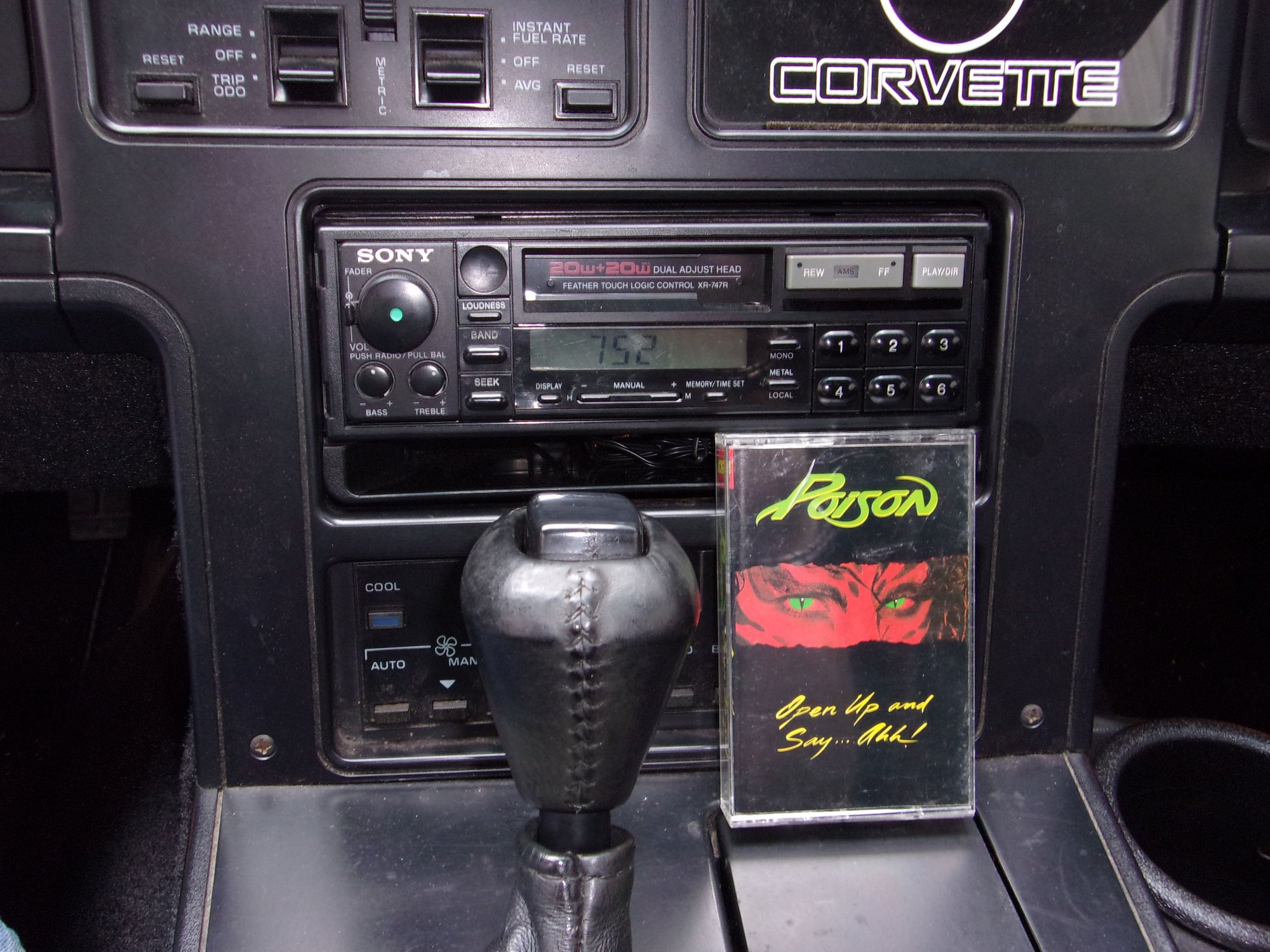

I too have an 89 convertable, rear speakers online show a rear corner mount speaker, where the convertible is flat and the rear deck as you know. Would like to keep the original head but change the speakers, but I'm reading the radio has no built-in amp?

Yes, you would need to either replace the factory radio or install an aftermarket amplifier if you are keeping the stock HU and just replacing the speakers.
Look on ebay. Very cheap repair that includes shipping.
