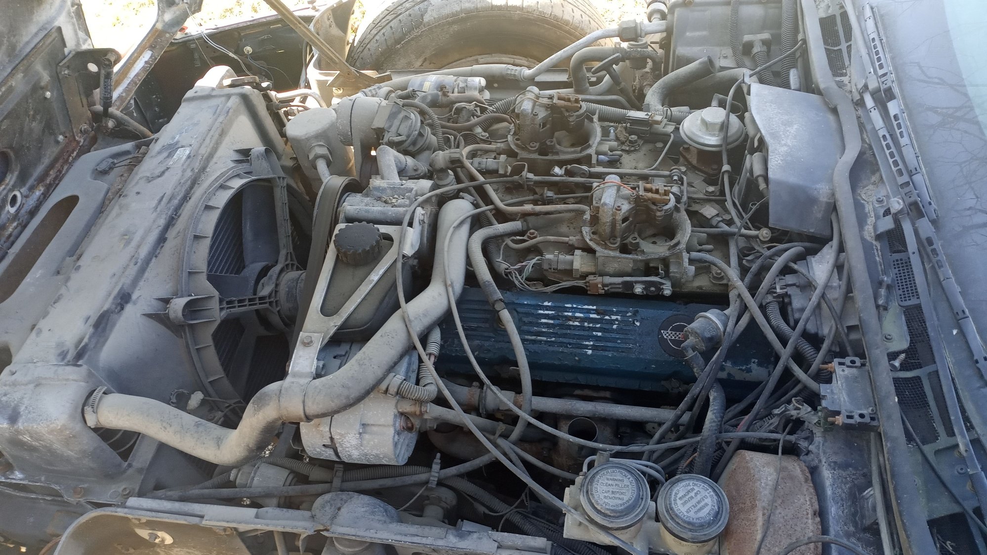

1984, miles high with some ring smoke but no other mechanical issues found thus far. Frankly the engine bay is a mess see pic. I want to rering, replace timing chain, cam & lifters, water pump while there, check heads & valve lap + valve seals, and replace that cease fire injection junk with a short intake and carb.

I certainly get wanting to do it cheap - but you're going to have to glazebust the cylinders, and more importantly - you're going to have to dig through all that crap in the picture to just get the heads off. Why not just pull the motor - and do crank & rod bearings while you're at it (if the rings are worn to the point of oil smoke - the bearings are probably worn as well...)???

Kudos for ditching the cease-fire, and just pull the motor. It’s easier and faster, because you’re not a kid in the 80s anymore. You need to clean all that **** out of the motor after you hone it for the new rings. What do you think the timing chain looks like?

Going back to first things first with a power washing, oil and antifreeze change, then a few starts & idling sessions to see if the oil rings loosen up. The car was parked by a road being dug up and repaved hence the coat of caliche dust. I was just curious if there were any obstacles to doing the rering in the car. The smoke isn't bad. I have a Honda GL1200 Gold Wing needing carb parts and a Kawasaki overbore also to do so my plate is full.
